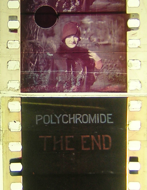

This appears to be a similar, 2-color motion picture scheme...
Polychromide process. Invented by Aron Hamburger. His 1922 patent GB203358 describes the method of dye-toning. The original negatives were made with a beam-splitter camera. An orthochromatic negative sensitised with erythrosine and a panchromatic negative sensitised with pinacryptol were used. Positive prints were made on duplex stock (emulsion on both sides) the print from the orthochromatic negative was toned with magenta and auramine and on the other side the print from the panchromatic negative was dyed with malachite green and helio safranin. The film was then bleached, cleared, washed and dried. Further details can be found in 'Colour Cinematography' by Cornwell-Clyne pages 339-341
from: http://www.brianpritchard.com/Anorak's Corner.htm

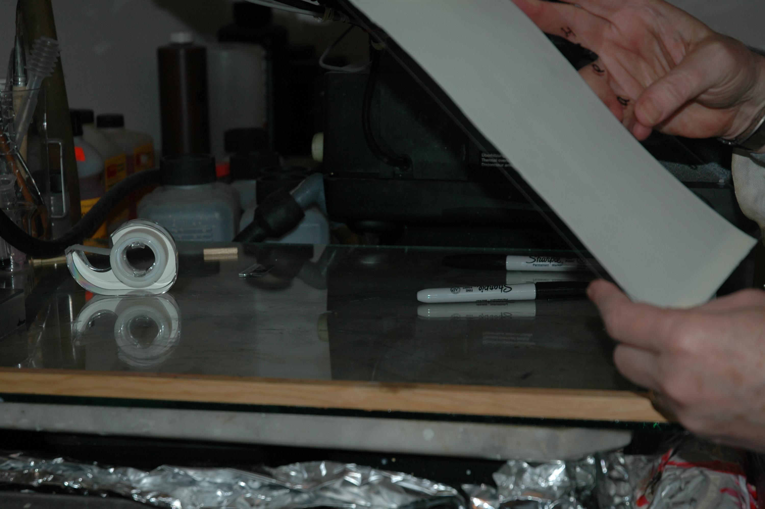

Gelatin, 10% coated at 12 ml / ft square
Here is a photo of 1 sheet of Melenex taken from the video. It contains Silver Halide as well. Note the lack of curl. If anything, I suspect that Sorbitol would reduce curl by increasing the amount of moisture in the coating and therefore it would probably reduce shrinking of the gelatin.
And yes, a water prewet will influence adhesion. The subbing is designed for a dry surface to be coated with a wet material!
BTW, for those who have lately criticized my coating methods, I draw your attention to the overall quality of this coating! It would yield 2 sheets of 4x5 film. I now have a 120 coater as well.

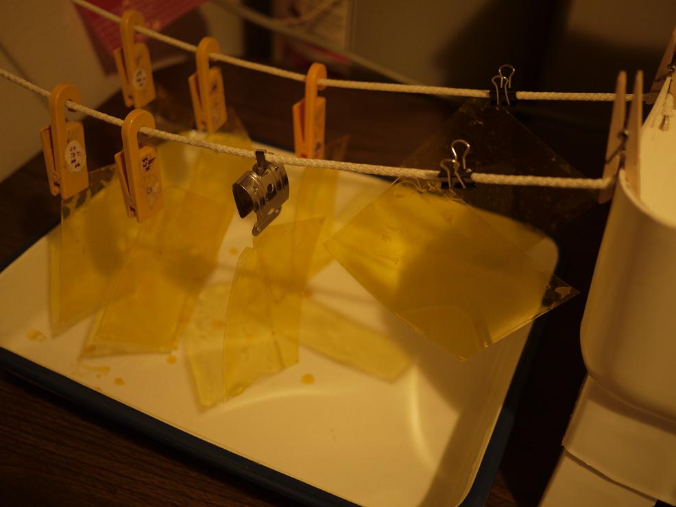

DCG Matrices
Tonight I sensitized 8 4x5" matrices in 3.5% potassium dichromate for 3 minutes each.
They're hanging up to dry and I hope to make some exposures tomorrow. This is my first time sensitizing any kind of gelatin thing, so hopefully it goes well. Anywhoo, just wanted to share a photo.
