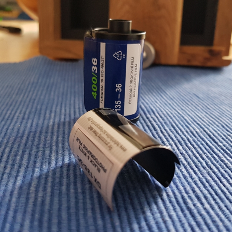

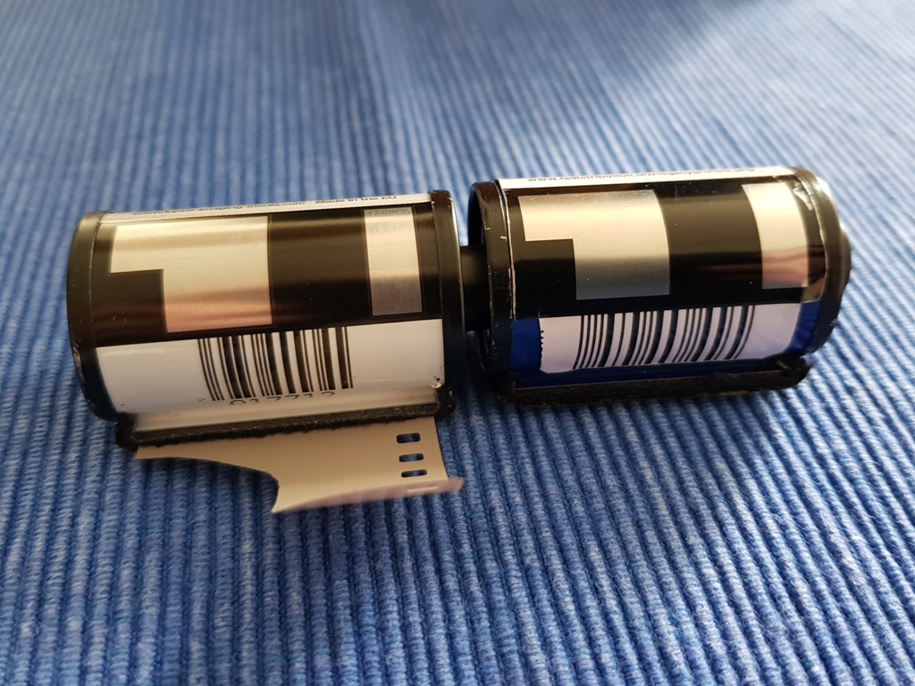

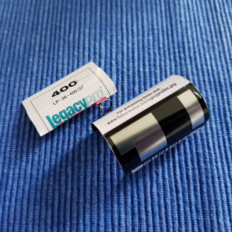

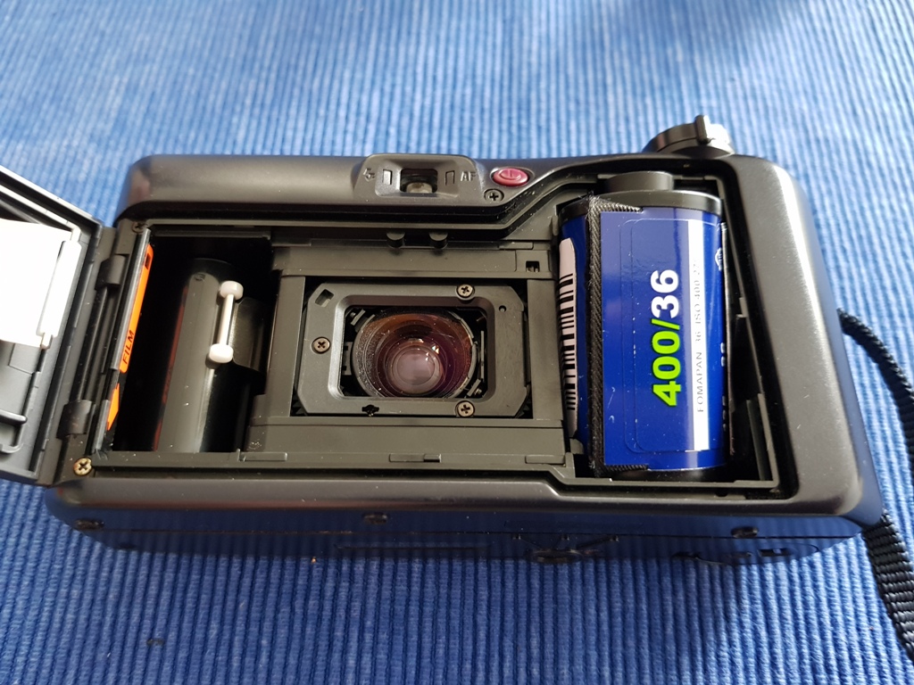

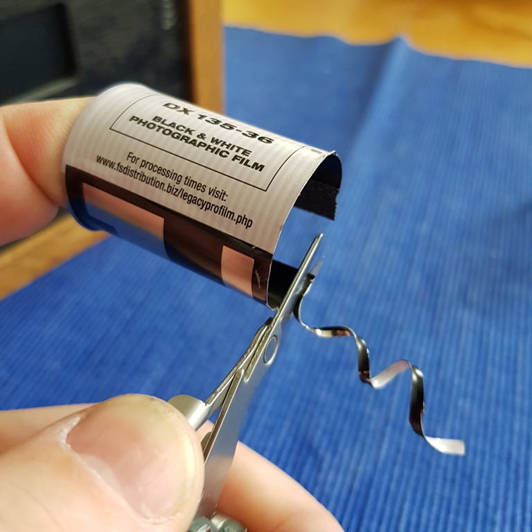

As you might have seen in this thread several cameras need the DX information for correct exposure. The Foma I have does not have this information on the cartridge. So I took an old 135 cartridge, a Dremel and started...
20200510_114620.jpg 20200510_114643.jpg 20200510_115253.jpg 20200510_115207.jpg 20200510_115231.jpg

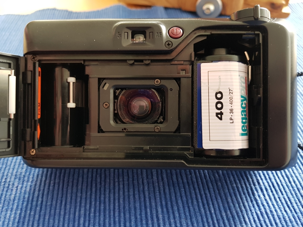

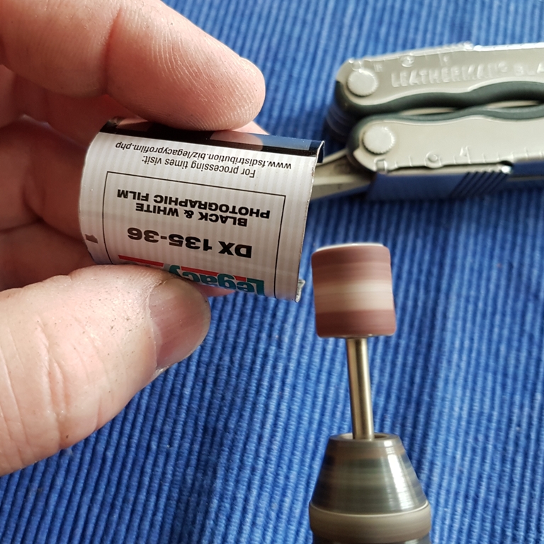

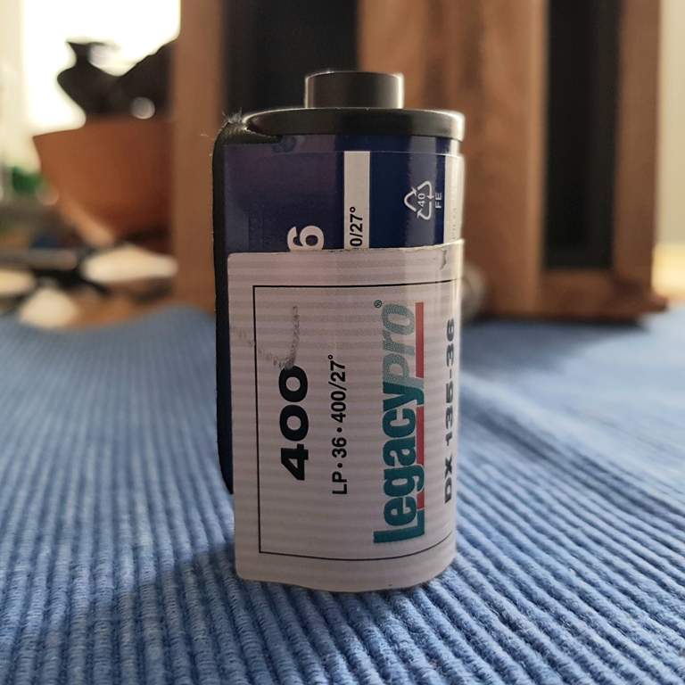

OK, the cartridge with the DX-sleeve fits into the film chamber, but the rear door needs a real hard push to lock. So one more snip...
The sleeve still covers more than 180 degrees of the cartridge and clamps firmly. And now the door closes without extra pressure.
Nice! Also applicable to Cinestill, FPP, and other repackaged films, most of which don't have DX (because they use a paper label for their branding, and DX sensors depend on a conductive cassette shell for contact). Carry a set of those in 50, 100, 400, and 1600, and you should be covered (close enough) for almost every film going.
