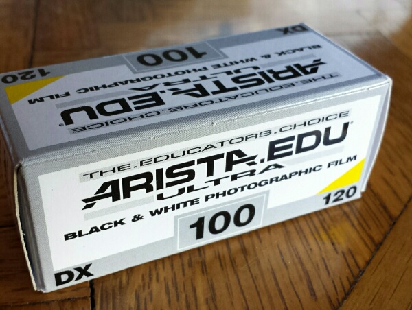

I have a box of 120 film here that is marked "DX". What is that supposed to mean? The wikipedia article about DX coding only talks about 35mm film.

Attached picture

I sure can't find what it means. Freestyle doesn't say anything. I wonder if it means something totally different than the coding on 35mm cassettes. Sort of like, what does AMA mean? Lots of things.

Is there a name for the barcode standard that some cameras use on the backing paper?

Interesting that Foma does not have dx code on its 120 film (at least not advertised. I have not used any) but Arista does.
Or is it Fuji now ?:wink:
