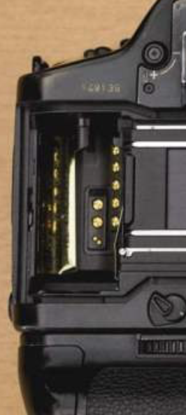

wonder if it will confuse the high end cameras? The EOS1 will rewind after 24 shots if it things you have a 24 exposure roll, and it tells from the second row of contacts. 90% of cameras only have the first row and just look for the speed.

That is what I like about this forum. Thanks for pointing that out, otherwise I was scratching my head which cameras used the second row of DX codes. In this picture I see two sensors on the second row of an EOS1. I guess logically you can de-code up to 36 exposures without the third sensor. If I'm reading the chart correctly, default should be 36 if no foil or exposed metal contacts those two sensors.
