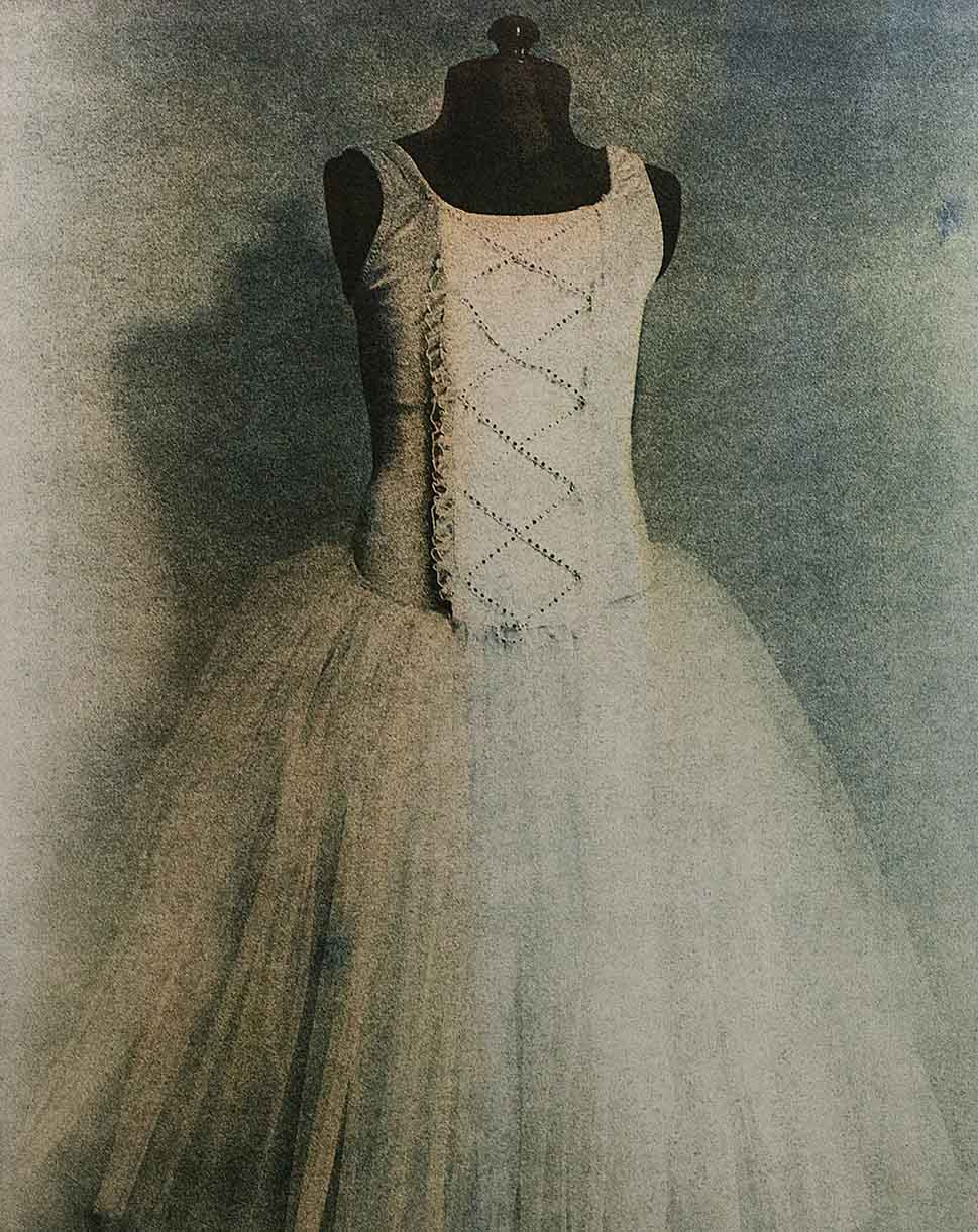

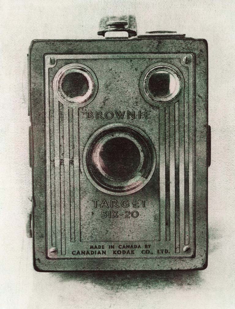

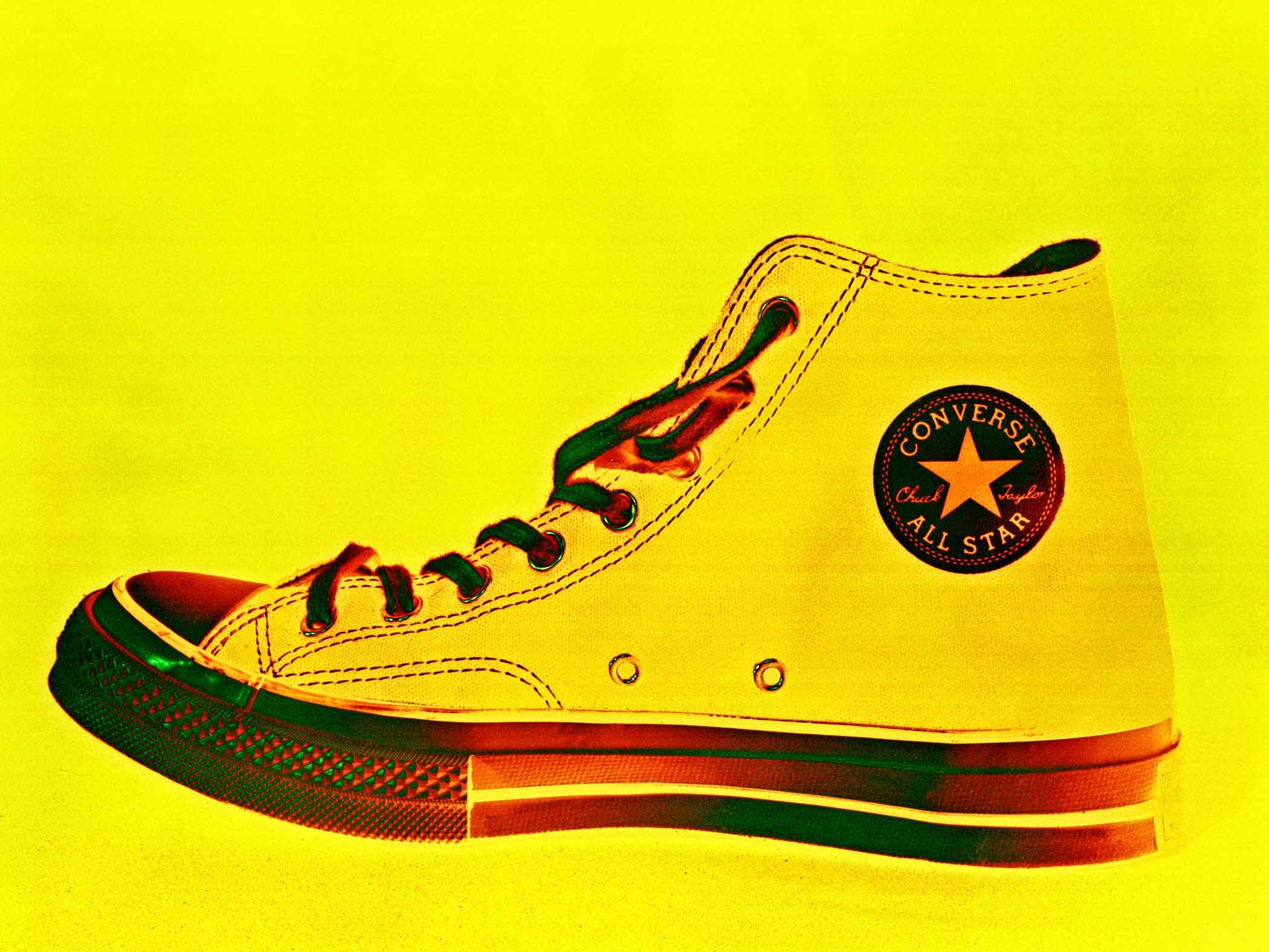

Here You go..
All prints on Hahnemuhle Platinum Rag using Daniel Smith Pigments
Dress - Burnt umber base, with Thaylo Blue ( green shade over top) with a extra hit of Peach ( yellow and red mixture)
Shoe - Yellow for the yellow neg, Magenta for the magenta neg
Camera - Sepia base, thaylo blue overtop
