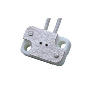

Like other incandescent bulbs, they pretty much work or not - nothing in between. It could be the transformer, but I would first check the switch and the lamp socket. Especially the socket. These wear and don't always make good contact with the lamp terminals. Do the easy/cheap stuff first!
Check the socket. Halogen lamp sockets are are renewable item.
I removed the bulb and saw some black something which I scrapped away, but the socket itself looks clean. I put the lamp back again and the flickering seemed to be less, however it is still dim, yellow and not constant - the effect as it wanted to get on the revs but cannot. The strange thing is that it worked for a while when I took it home.
