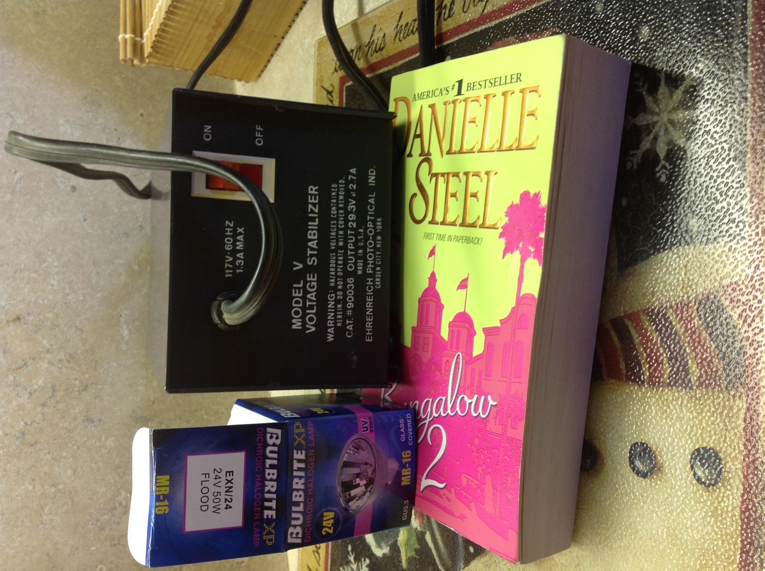

I visited our local electric fixture store and determined the lamp was bad. The booklet identifies several recommended lamps rated at 12v and 100w. There are different values for the US and Canada. The booklet identified one bulb rated at 30v 80w for the USA. I bought an available 24v 50w lamp, UV glass covered. Tested in the store it was blinding brilliant. The light can be slightly under rated as I work in B&W. I typically dial in magenta to change contrast without using yellow or neutral density.
The voltage stabilizer is a domestic brand seen with other M601 CLS 66 sold on online.

A forum member helped with parts allowing me to print. I discovered the light intensity too dim to use color filtration. The correct mix box is installed with a 30v 50w lamp. The power supply is pictured in the previous post. 1. Is the CLS color head naturally dim?

Richard,
Your power supply is rated at 29.3v at 2.7A. If you do the arithmetic, you get 79.11 watts. The recommended lamp is 30v80w. Underrun slightly, you will be within the capacity of the power supply. The 24v bulb was brilliant, but would have a short life with much bluer light. Your output voltage must be dead on with the lamp spec, or your colour temp will be way off. If the voltage takes a detectable interval to reach spec, the unit requires repair.
