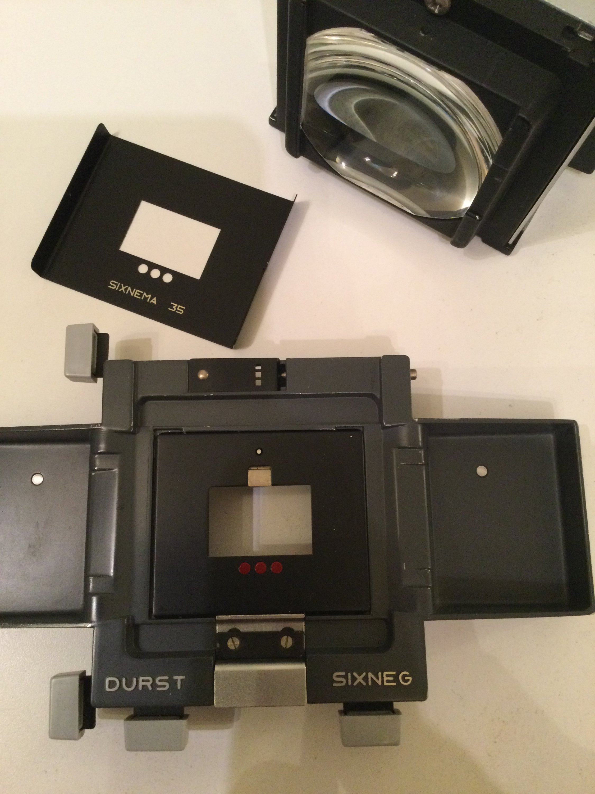

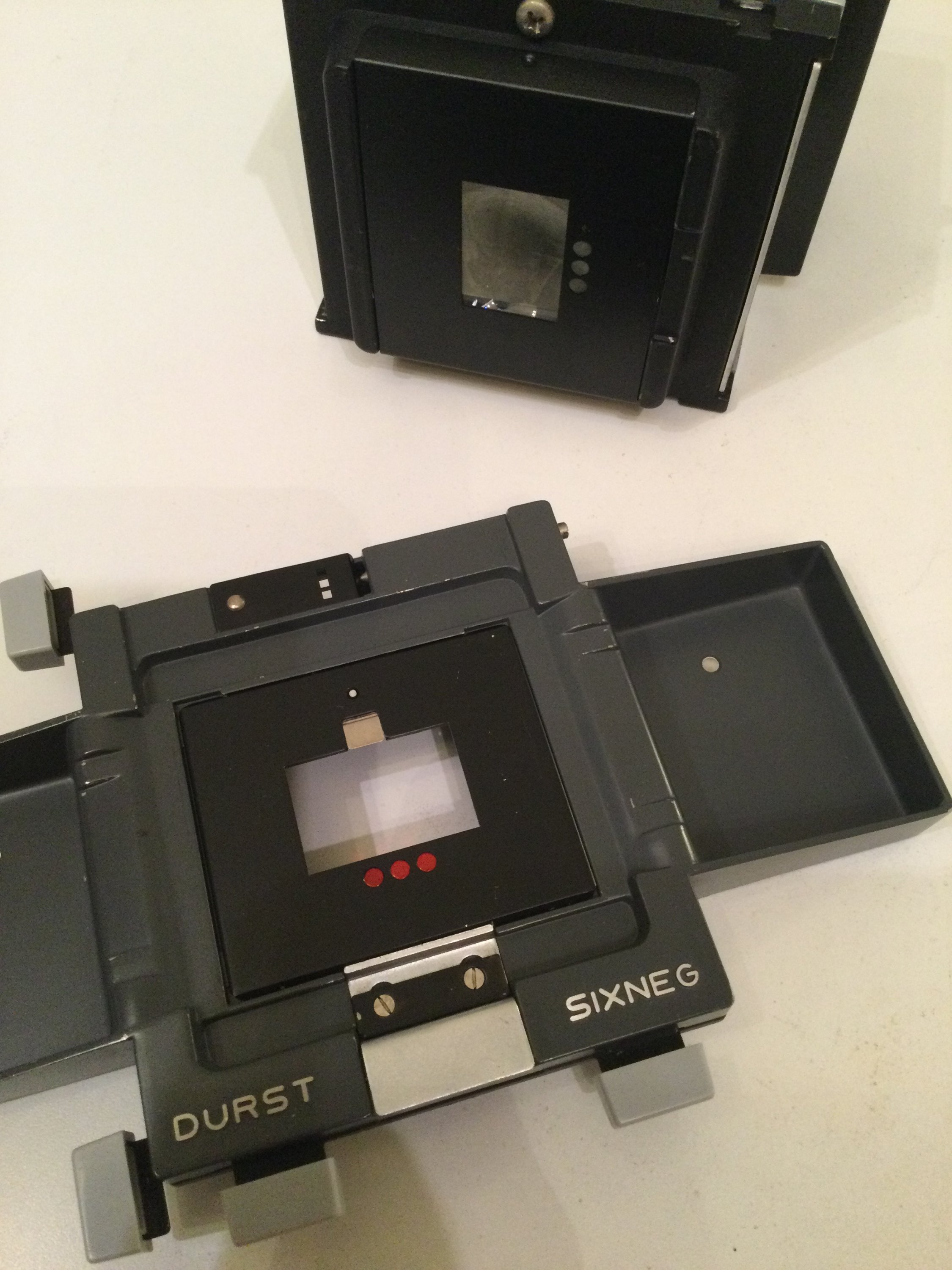

Here is an example setup for 35mm negatives on the M600. DFB2A562-5E52-4B42-BE55-EF57B73856B4.jpeg 949FB714-5C93-4F18-A7F3-0DBE98EFA04A.jpeg
The Sixnema 35 is a very thin mask with integrated spring clips that hold this mask to the base of the condenser lens. These were only available for certain negative sizes. (Consult the manual for which ones)
If you wanted to print 120 negatives (6x6) you would remove whatever Sixnema mask was attached below the condenser lens. The negative would sandwich between the flat base of the condenser and the Sixma 66 negative mask installed in the Sixneg carrier.
Does that help?

the photo gives me a better view of how it works thanks. I ce spotted on sixma 35 kit on eBay. Waiting for the bid to complete.
