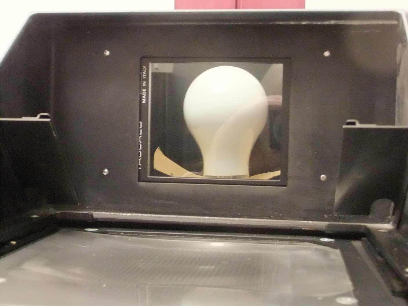

Hello,
I have problems getting a even lighting area with a Durst laborator 1000.
With bigger enlargments I get light fall off at the working side of the enlarger,
I think I do everything right with the opal lamp and the condensers,
But I was wondering if I miss something here in the mirror condenser housing (see picture)
What should be in these slots.

Those slots are to take an accessory heat-filter.

Assuming you have the correct condenser set and lens for your intended negative, it looks as if the lamp may not be centered.
You probably saw that section 6.1.0 Centering the lamp, in the English version of the manual, has a typo. It omits reference to #21 which is the lamp locking ring. That needs to be loosened to center the lamp.

Given that image is tilted, the camera is off center and not pointing straight at the bulb, I find it miraculous that you can say bulb is not centered. I don't think anyone could tell from that photo.

Can't one say "it looks" in a metaphorical way, indicating an assumption?
(In German it is used that way.)
AgX
Apr 5, 2007
29,972
Germany
The Laborator 1000 has a closed casing, thus no screen and thus no need for a mirror in that position.

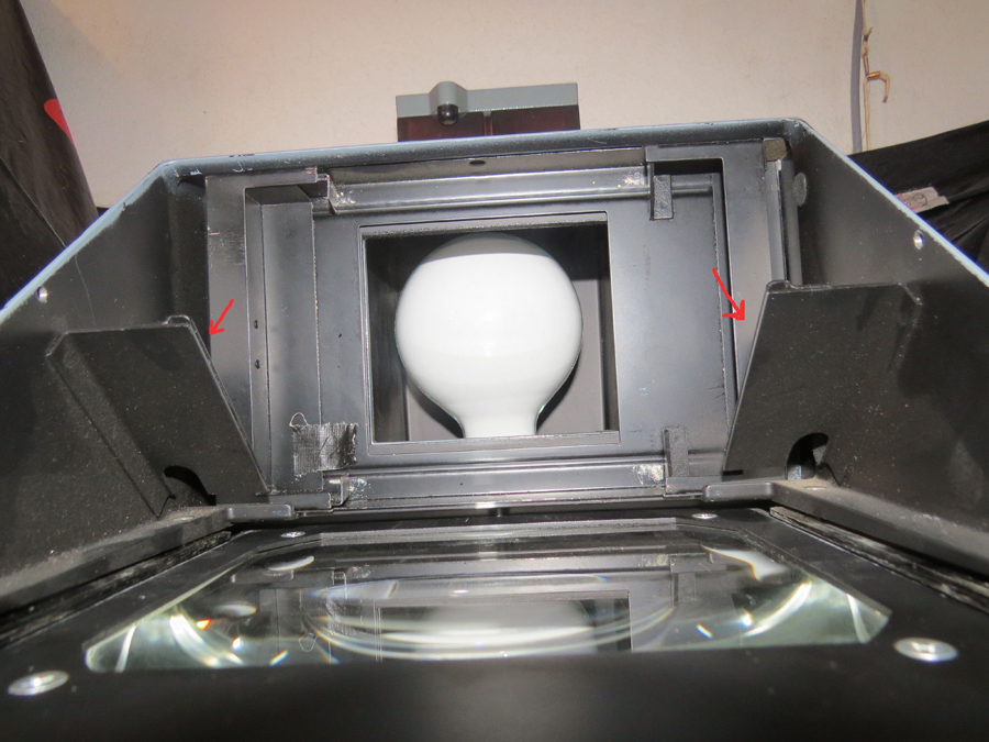

The heat-filter is positioned between lamp house and condensor house. See attached pictures.
The mirror is always there, positioned in the "ceiling" of the condenser head. Be careful when you pick that up: the mirror tends to slide out . . .
Do you have a filter tray there? It looks different from mine, but I should look again at mine. Is yours the Taufil ?
Anyway, I may be wrong because the L1000 is still new to me, but your bulb looks smaller than the bulbs Durst had made. Is that a Phillips bulb? If you have 4X5 negatives in there I think you need the largest possible bulb. If your bulb is smaller it will be more difficult to avoid fall off. The bulbs Durst had made have a different shape than yours, more like a pear. They were made by Thorn - 200, 300 and 500 watt . . . It is specified in the manual, the size of the bulbs. I first had a too small bulb in there and I had the same problem. After installing the large bulb, all was ok.
How large are you enlarging?
ps the bulb in the pictures is the wrong one, too small.
Look again, the bulb is too high. He needs to unlock ring #21 and re-postion.

Thanks for your reactions guys,
First time I see a picture of a heatfilter, always wondered where that would go.
On mine you see indeed the taufil filter drawer.
I made 7x enlargements of 6x6 negatives. with a 75 mm lens and otocon 180-2 and 130 condensers
The lamp is 90mm and I was told it would do the job, but yesterday I tried the original smaller lamp and got even fall off on all sides. So the lamp is the problem. Probably the filament sits to low in the bulb and it is not opal enough.
Thanks Hilo your message helped me here.
