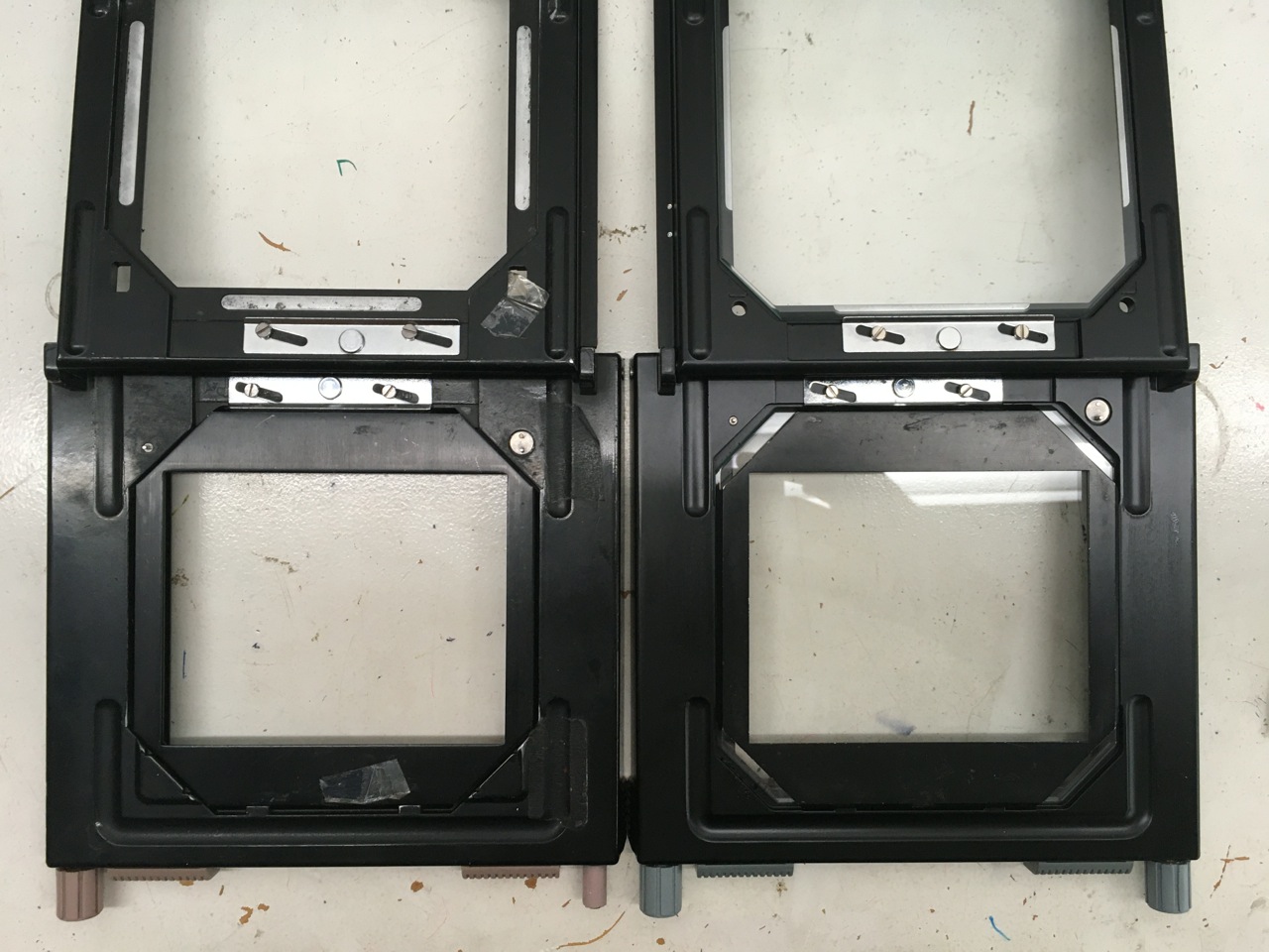

For common knowledge, here is a standard Femoneg aside the AM version (with a standard Femomask on top, for comparaison), allowing for full 4x5 film printing...

So the one with pink knobs is standard and grey knobs is the AM version? In the picture I see that both can accommodate the 4x5 mask. Will the 4x5 femoglass fit the standard carrier or only on AM version?
Yes, left is standard and right is AM. The standard Femomask and Femogla fit in the AM carrier but they don't fill the corner (precisely what allows to print the entire 4x5)...

I have the standard femoneg with the pink knobs above. What mask and glass should I use for 4x5 film? Do femomask and femoglass fit the standard non-AM carrier?
Yes, Femomask and Femogla.
