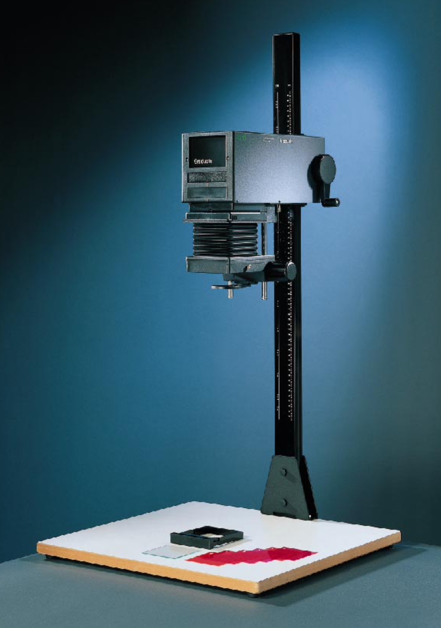

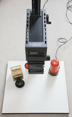

This is now the only enlarger I have in my darkroom, bolted to the wall. I think it is one of the best 35mm enlargers I have ever used. Do others agree?
Never heard of it, tell us more. Is there a number designation? Maybe a picture or two to figure it out.

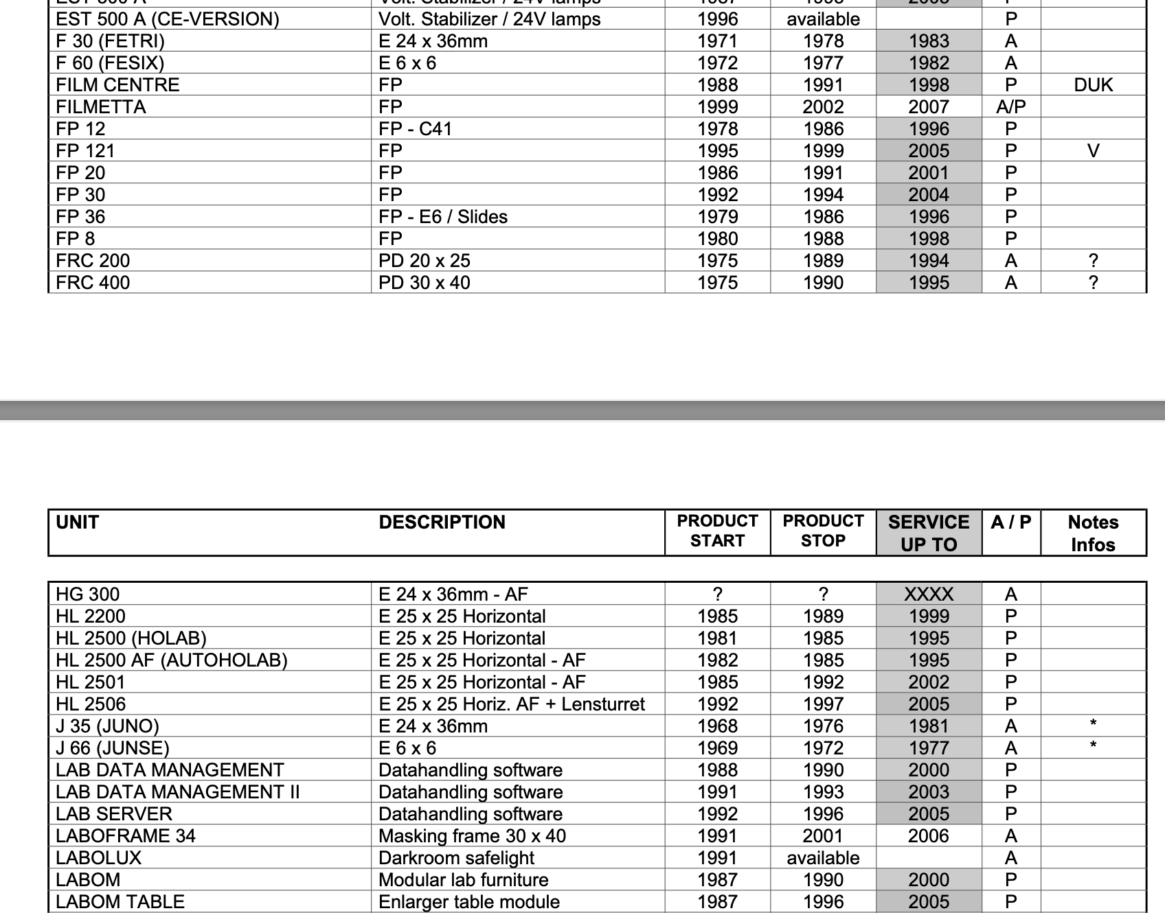

My big list of Durst manufacture start/stop dates jumps from "F" to "H" with no mention of "Graduate."

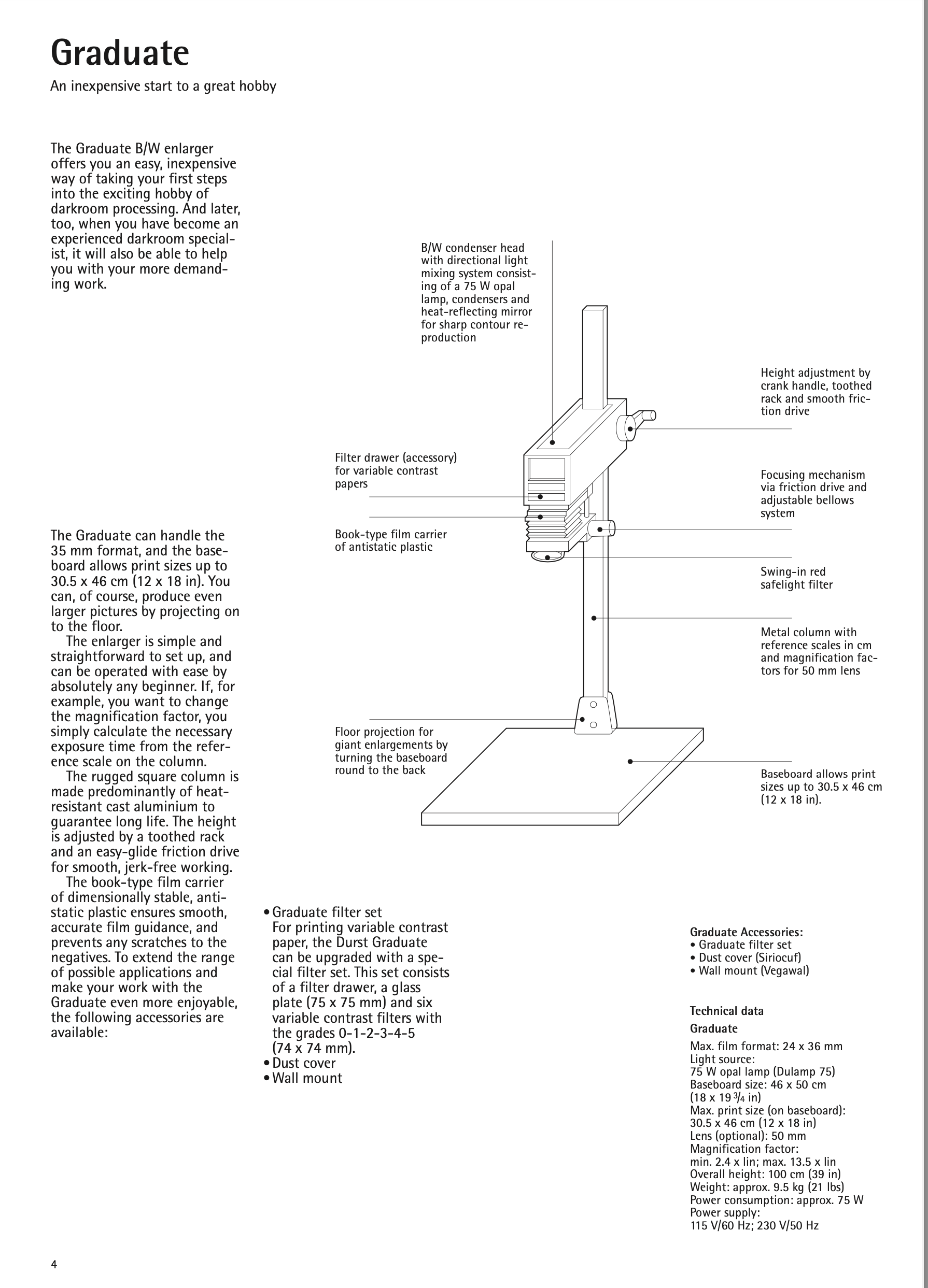

Ok, it is a beautiful contemporary enlarger. I found this in a Durst brochure titled "Number 1 in the Lab," IX63075. These are the only two pages of information on the enlarger.

The Graduate was the very last entry-level enlarger from Durst.
That it does not appear in their final servicing list ist weird, but may confirm my saying that even at Durst themselves they lost overview what models they all built over those years...

It was my first enlarger. It is usable of course, but I didn’t like the plastic carrier. Also, because of the straight column and not enough lens to column distance my easel always knocked into the base of the column; which can solved, as you did, by wall mounting.
Perhaps the Graduate was not yet discontinued when that list was circulated.
But that listing (made up few weeks before the press release on cancelling the enlarger manufacture) explicetely lists some other enlargers still available.
Thus it must have just been overlooked.

Well, not a single "real" Durst is on that list. Those came out of a whole different Commercial division. But they also take up a lot of floor space, and were obscenely expensive in their heyday; so it's understandable why some people prefer something dedicated to small work exclusively.
All the Laborators are listed.
ic-racer posted just a small excerpt to show that the Graduate is missing.

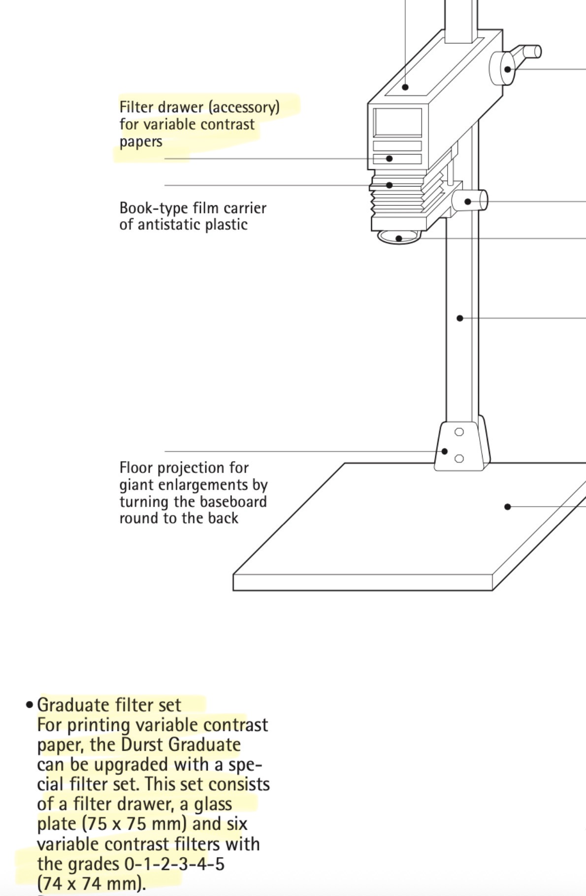

Regarding the multigrade filters, I was wondering specifically about the filter upgrade kit, that goes into that space above the condensor, specifically reserved for this drawer.
I'd rather not fiddle with gelatin filters under the lens if I can avoid it 🙂

Yes there is a pull out panel with a slot for a filter drawer.
