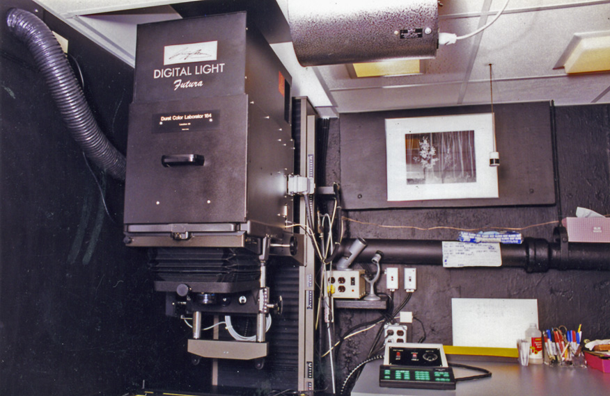

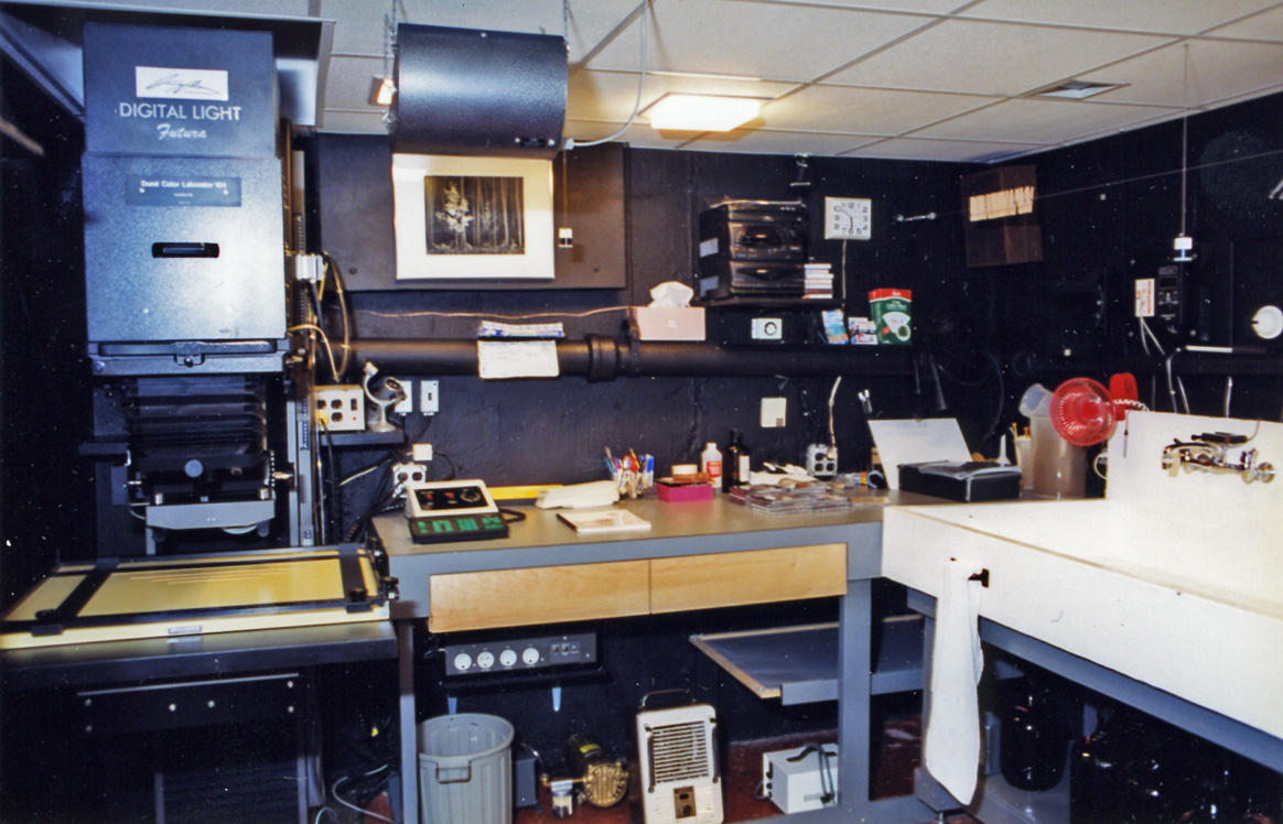

Hi! I need to find someone who is very knowledgeable on 8x10 Durst Enlargers. I have a Durst Enlarger that I purchased from Durst-Pro-USA back in 1999. Jens Jensen who owned the company passed away some years ago and I don't know who to ask.I have a ZBE 2000 Watt Digitally controlled head.Its sits on a chassis that has motors for the Lens stage, the head and focusing. I need to know if a Durst CLS 2000 Watt manual head will fit on my chassis. I have included a few views of my present enlarger.Any help at all will be greatly appreciated. Thank you, Dave

I think it is a "YES" but do you know the exact model of Durst you have? I can't say for sure from the picture. I'll have to look through some old catalogs to know. The 'interchangeable' Durst heads mount with 4 bolts in the same location on all the enlargers.
So, if it can take the CLS2000, then the CLS1840 and the Condenser heads should all fit too, in case you can't find a CLS2000 head. There was a CLS1840 head on ebay recently, but no power supply or mixing boxes.
I can confirm the CLS2000 is a 'manual' enlarger head, using wheels and levers to change the filtration. But, there are still a lot of electronics in the head. For example there are TWO powerful blowers wth a heat-sensing circuit and an electronic shutter.
What happened? Did the ZBE head stop working?
Also, due to the way the head sits on the enlarger, one could probably adapt many heads to that enlarger. I have seen Omega F heads and Ilford 500 heads and Aristo heads with various commercial or home-made adapter plates.

Hi! The "Head" I have is a ZBE Futura. It has 6 lamps and is rated at 2000 Watts. I NEED the 2000 Watts that is why I want the CLS 2000 Watt head. My stand or Chassis I THINK is the 1900 Chassis. or the 1840. Not sure. I would prefer a totally manual or Mechanical chassis ans there are no electronics to break down. My Futura head is working at this time but I wanted a more mechanical one in case mine breaks down as I don't believe anyone can repair it! If you have any further information I really would appreciate that!! Regards, Dave

You should be able to adapt any head to the any Durst chassis. Getting a ZBE head repair will be difficult to find, at least in any affordable sense. Stay away from the old CLS300 2000W Durst head; it won't evenly cover 8x10, and is very hot running and expensive to maintain. The newer 2000W head uses an expensive hard-to-find bulb, and involves some fancy electronics. Why do you need that much wattage? That kind of heat was the achilles heel of the ZBE design to begin with.

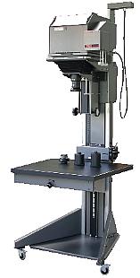

I did not have a job when I got my Durst, but now that I do have a job, if my Durst would fail, I'd get the 8x10 Keinzle. Check it out half way through the video. Price list I saw shows about $15,000 with VC LED head. That is a bargain as the Durst CLS1840 was about $40,000 in the late 1990s.

After viewing that video again I think one solution to the diminishing supply of good used 8x10 enlargers and the demise of Durst USA for parts and supplies is people might buy those Kienzle enalrgers new. After years of not having any parts or service, my life would be much less stressful as Keinsel has spare parts and service. The entry price is not too far off for those older folks with retirement money.
The other thing with the C252 Kienzle is that you can have a nearly infinite range of options - bench, wall, floor standing, all with a choice of 2 column lengths (or custom if you want) plus a range of head options (condenser, Halogen, colour dichroic, multigrade dichroic, colour & multigrade dichroic, motorised split-grade, some closed loop/ computer controlled options & the Heiland LED as a factory option) with a range of lamp outputs running from 250w upwards. You can also get wall projection, motorised head/ baseboard etc - and if all that's not enough there's the T2525 which has even more options.
