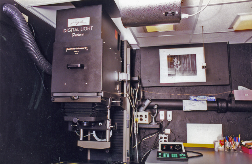

Hi! I hope someone can help me. Back in 1999 I bought a Durst 8x10 1800 Enlarger from Durst-Pro USA It came with a modified ZBE Dichroic color head, 2000 watts. (6 Lamps) It has given me very little trouble over the years but now I am extremely worried. Jens Jensen the owner of Durst-Pro USA unfortunately has passed away. There is no contact with anyone that used to work for the company and ZBE does not have parts anymore. This is a great enlarger but if something cuts out on the unit I am at a loss on what to do? Does anyone know of any people or companies that can service enlargers? I can do some mechanical repairs myself but I don't have schematics for the PC Boards for the Color Head. ANY help would be greatly appreciated! I have enclosed a photo of the enlarger.
I have an original Durst CLS2000 color head on my enlarger and this is my backup plan and I have acquired a spare power supply (EST2000N).
If that were to fail I'd just either build myself, or buy a new LED head.
LED technology has advanced so much, even since I got my enlarger ten years ago. Looking at your setup, if your color head were to fail, I don't think it would be that much trouble to find a LED panel that would take the place of your mixing box and fit over the negative stage. But that is my backup plan.
Another option for you would be to find a used Durst CLS head. Even if you don't have the power supply, powering the blowers and lamp could be accomplished easily without the dedicated EST unit. The dichoric filter control is all mechanical and the electronic shutter can easily be left open all the time.
Thank you! Alan Ross also recommended a LED light source. My only other concern is the three stages, Focus, Head and Table are controlled by motors. There is no mechanical bypass for them if they fail.
I know how you feel. My situation is not much different, except it is about Leitz enlargers and the Durst L1000 that I have wall mounted. Over the past ten years I have gotten many parts that can break: glasses, condensers, cables, lamps . . .
Perhaps nice to know nothing really does break !!
Ok, so you are trying to solve a problem that you don't have . Some solutions offered above. If the head motor fails, take it out and get another head motor (Hemot?) at auction or install a hand crank! Looks like you may have a hand focusing knob on the lens stage already, and just leave table at whatever height you normally use. If you post photos of these motors and how they attach, there may be other solutions. I'm only going by what is on my L-184 base.
Sort of why I bough a DeVere 5108 instead of an L-184. I put my SM-183 (L-184 base and 5x7 camera) in storage. Figured someone might want it at some point. The Devere is all manual so easily fixable when and if it breaks! The Durst condenser head is manual, plus I have plenty of bulbs for it as well as the cold light head! Nice enlarger, BTW.
I am just trying to be prepared for the future. Electronics do not last as long as mechanical so I have to be ready. Replacing a motor is not easy and I don't have a replacement. This unit will not accept a hand crank. Thank you for your input.
Then you can get a manual L-184 base and mount the head on it. PM me if you'd like. L
ic-racer probably has the most experience with this model and could probably be the most help. Have you had any issues with it? L
IC Racer? Don't know him. No problems at this time but I want to be prepared for the future. Only problems I had in the past is the Main PC board, which had to be replaced and the sensor board which had to be replaced. The Light engine and all three motors work fine. This is a Futura Head. 6 lamps at 2000 watts. This was sold to me by Jens Jensen. Durst Pro USA. Unfortunately he passed away last month and his business is gone.
ic-racer was the first respondent to your post. You can message him on this forum. He is familiar with the Durst head, don't know about the Futura head. I personally visited Durst-Pro USA a number of years ago when I was in the area, and was concerned about backup/service should any happen to Jens, or if he choose to go out of business as it looked like a small operation. Exactly why I went with DeVere, as you can still purchase products/pars if needed, plus it's a much simpler enlarger. With luck, these enlargers can be passed down to our heirs!

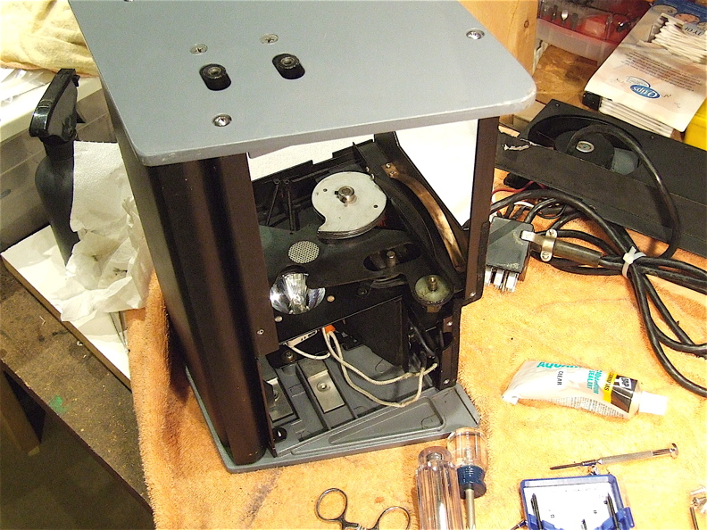

Just to continue, I also think that restoring old mechanical Dichroic heads is a good alternative (picture below of a 4x5 Chromega I refurbished). I don't see too may other threads on this topic but I think that it is easier to fix a mechanical dichroic head than make a LED head from scratch. I had mentioned this in my first post above. Which is to say find a mechanical dichroic head as a spare.
