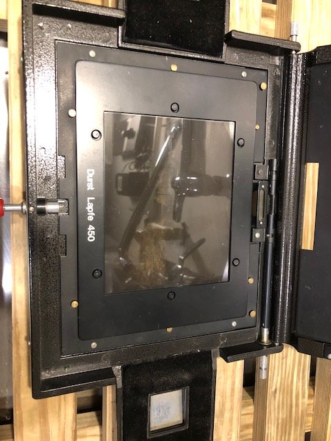

An old thread, showing my modified Nega MC to take the Lapfe inserts

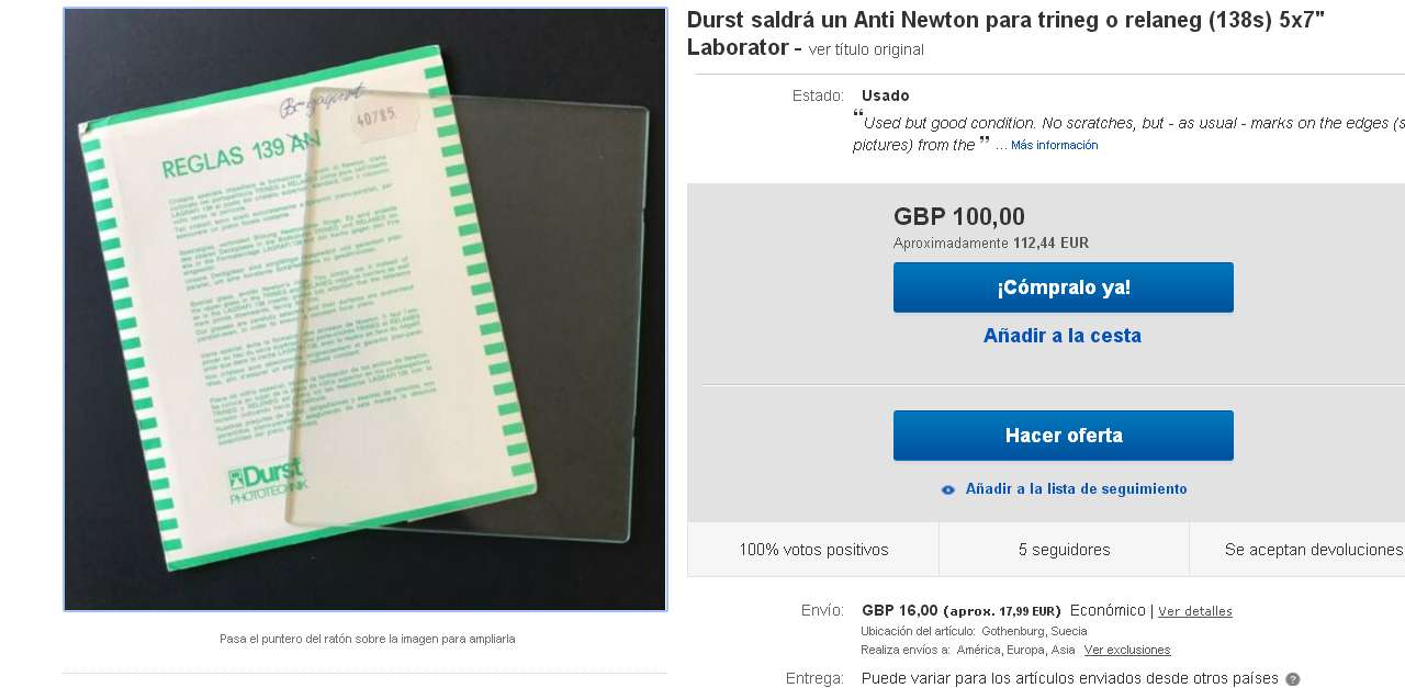

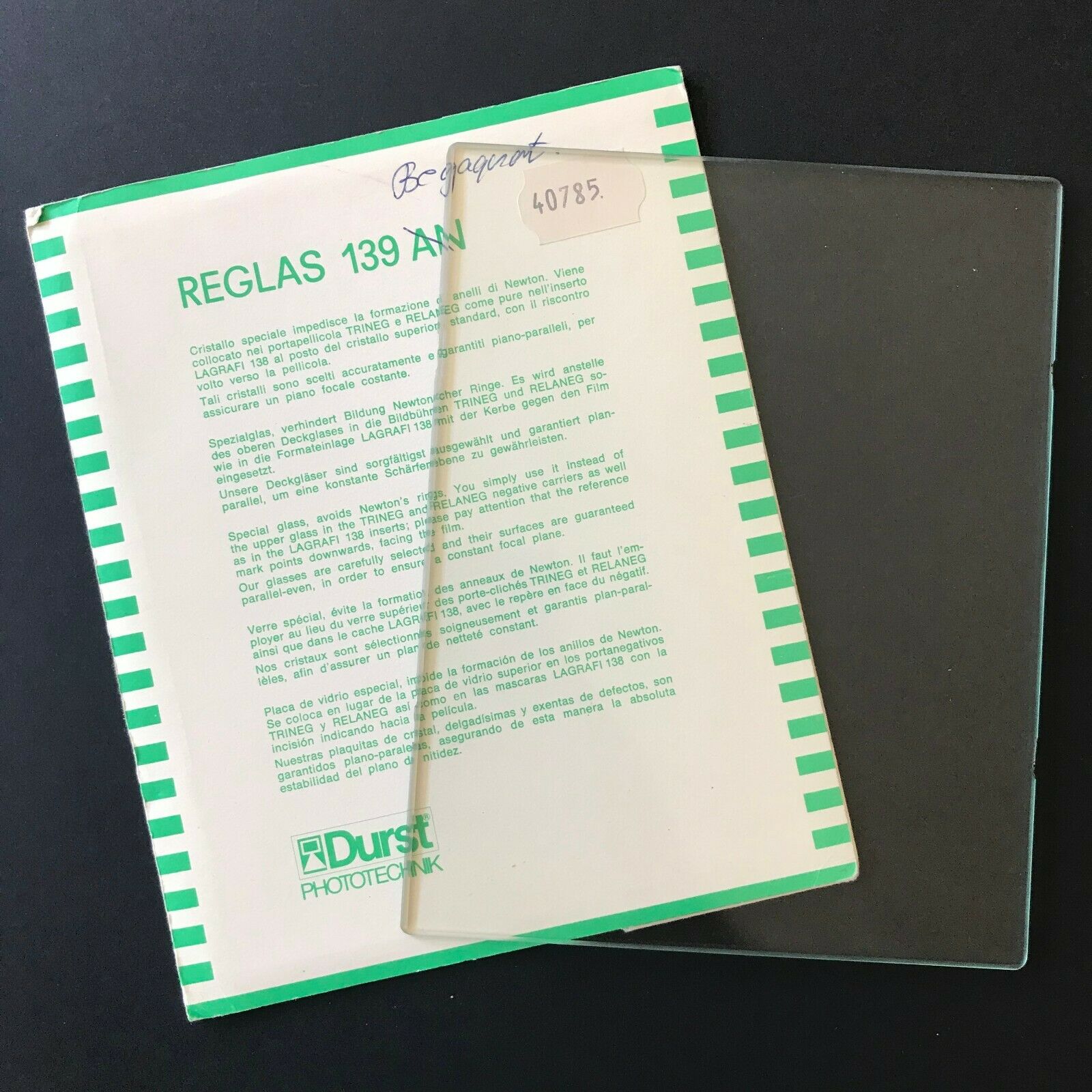

There are two kinds of glasses, regular flat glass and Anti Newton Ring

You may have one ANR glass and one regular glass, the ANR glass edged (slightly frosted) surface should be in contact with the emulsion side of the film, for the case you reverse the image.
If you have two regular glasses (no ANR) probably usually you won't see newton rings anyway because the the glasses are very flat and pressure will not allow much the film-glass clearances that provocate the rings, but some films may benefit from having an ANR glass.
If the ANR in the bottom side it won't degradate image, I tested it and personally I found no practical damage, absolutely.
