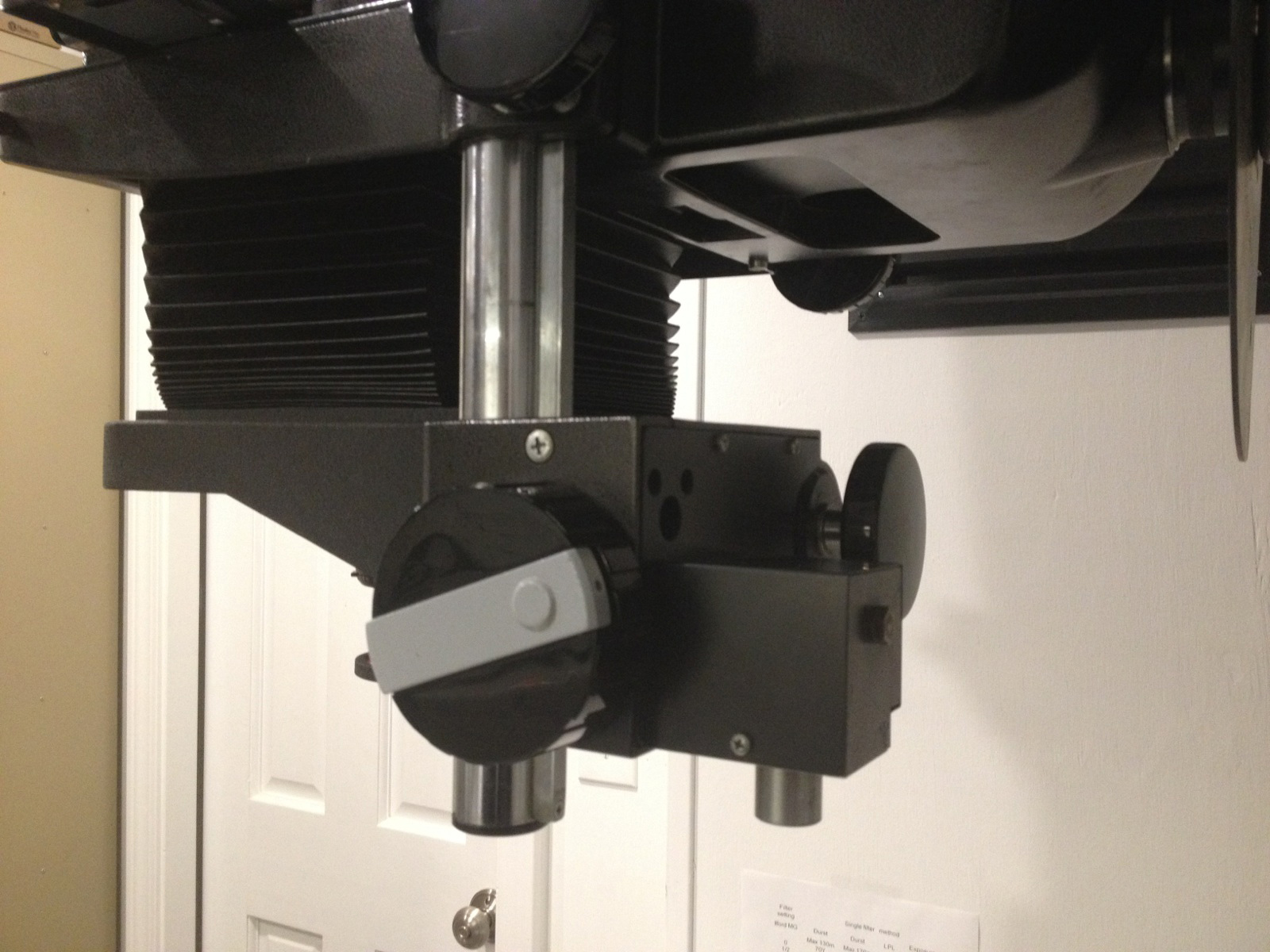

They actually made a removable one for the SM-183 where the head would extend really high, an extra 14" above the top of the L-184 chassis. Was not very well thought out like the permanent one for the Chromega F which works great. The extension attached to the small cylinder at the bottom of the rear focus box. This cylinder turns when you focus and there is an extra gear in the small rear box that the cylinder is attached to which gears to the focus mechanism. A normal L-138 does not have this extra gear box or cylinder. I've often thought of having a flexible extension made for it as that would make it useful. L
attachment.php
