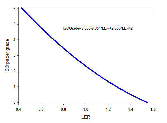

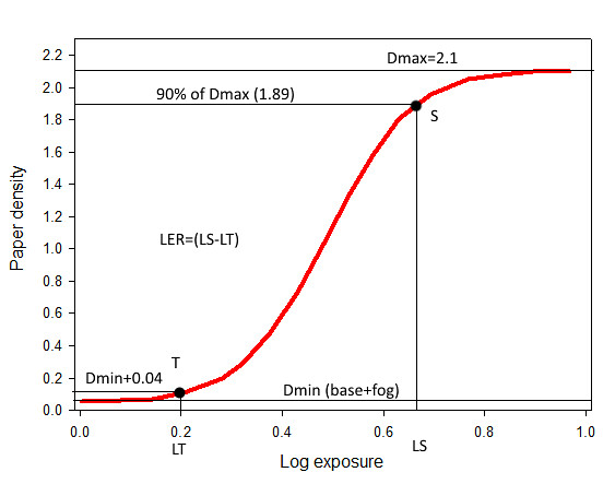

A proper calibration starts with the definition of paper grade which is described in the ISO 6846 standard. The grade is based on the LER (log exposure range) which is defined as the difference of exposure between the Dmin of the paper+0.4 and 90% of the Dmax
Durst 138/139 VC LED head calibration - LER vs ISO paper grade
by Dominique Filippi, on Flickr
Durst 138/139 VC LED head calibration - paper grade ISO standard
Dmin is the minimum density of the paper (fog+paper base). Dmax is the deepest black of your paper (usually ranged between 2.1 and 2.4).

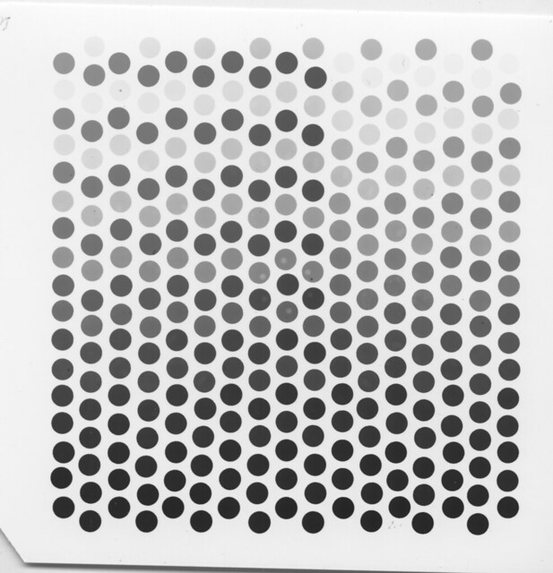

As I have mostly Adox paper, I have run the first calibration for this paper. The calibration consisted in making test strips by changing the level of blue and green (32 values of each = 32x32=1024 spots). I’m not mad enough do it manually so I made a dedicated USB device which runs with my enlarger. I just have to put a square piece of paper in the device, push a button et voila! The enlarger takes control of the device and does all the spots for me. It can fit ~300 6mm spots on a 13cmx13cm piece of paper.
Video of this device at work can be watched here (no paper loaded)
The exposure time was set to 3 seconds for the calibration, and light exposure changed of ~0.2 fstop. Here is one of the test strip obtained with the USB device (developed in Ansco 130)

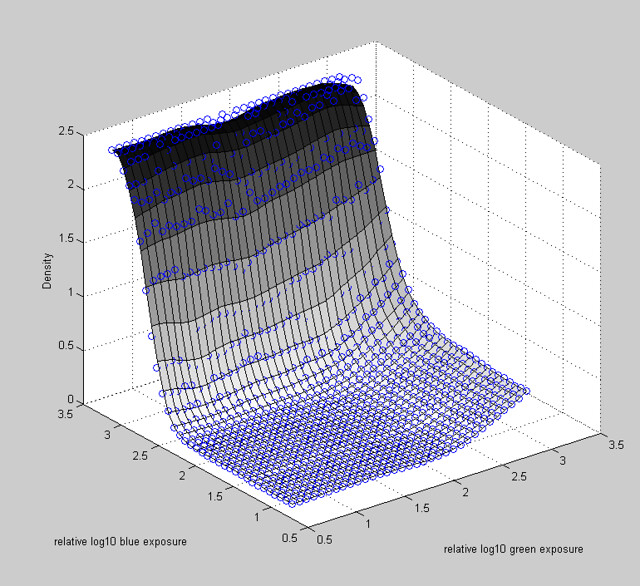

Here is the 3D curve of density vs green and blue done with the 1000 spots of the test strips.
Durst 138/139 VC LED head calibration - 1024 spots
For each value of green, we get a blue exposure vs density 2D curve.
The Matlab code looks for the T and S points, computes the LER and then turns them into ISO paper grade.

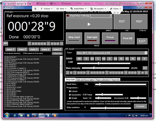

Here is a screen shot of the PC software which controls the enlarger:
Durst 138/139: "Chambre noire" Pc-software
It looks like the space shuttle dashboard but it is very easy to use indeed.
You will notice the grade buttons to change the grade quickly, the light intensity buttons, the roll menu to select paper / speed point combo, test strip function based on time change or grade change…
I have to set up those special functions with a mouse but at the end I use a simple remote to do the basic operation.
