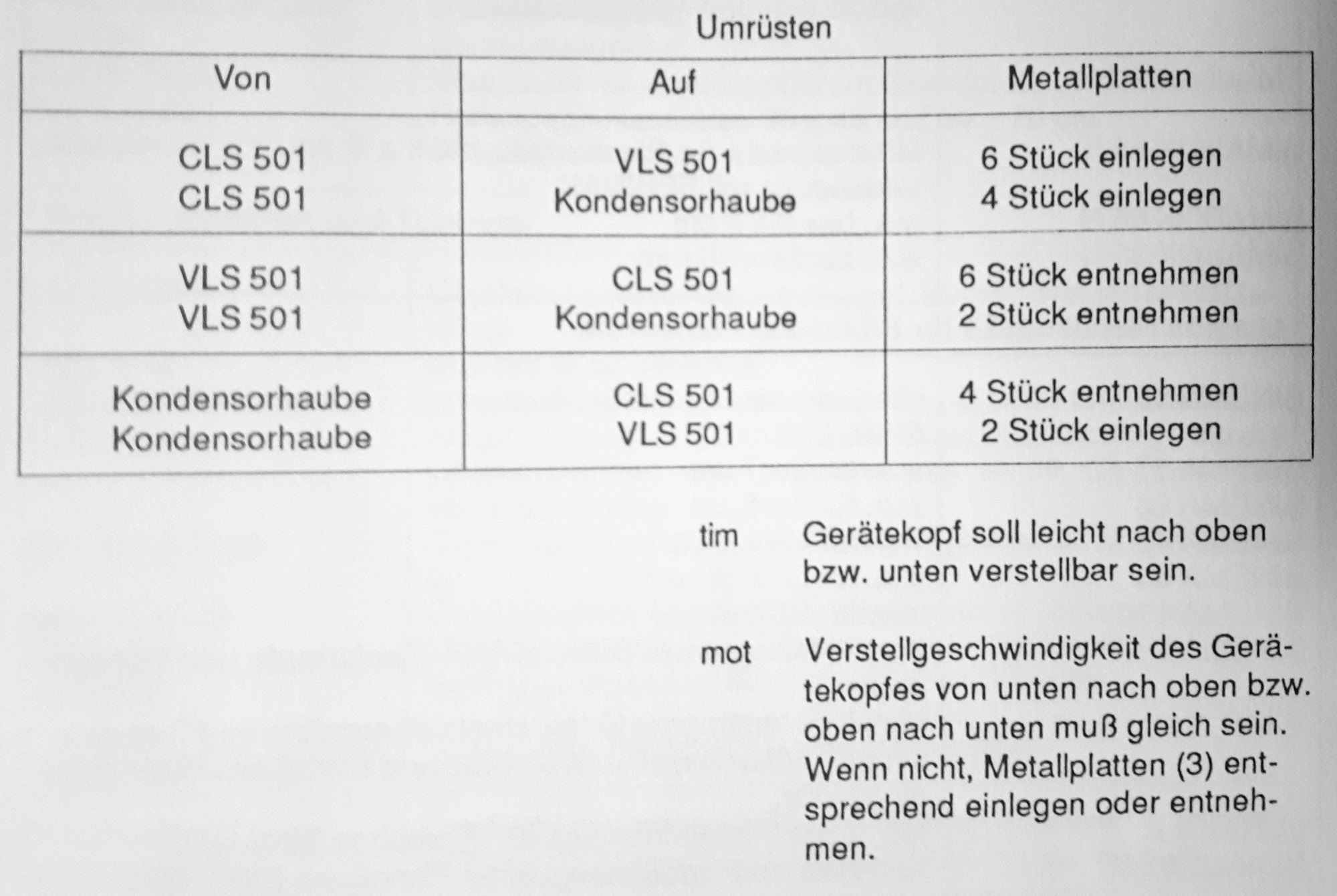

Okay here is some info. The metal plate has the following specifications; 12cmx15cm and a weight of 560g.
MARTIE
Oct 31, 2004
320
I've only found the German version so far explaining the number of metal plates for the enlarger head changes but hopefully it will be clear enough...

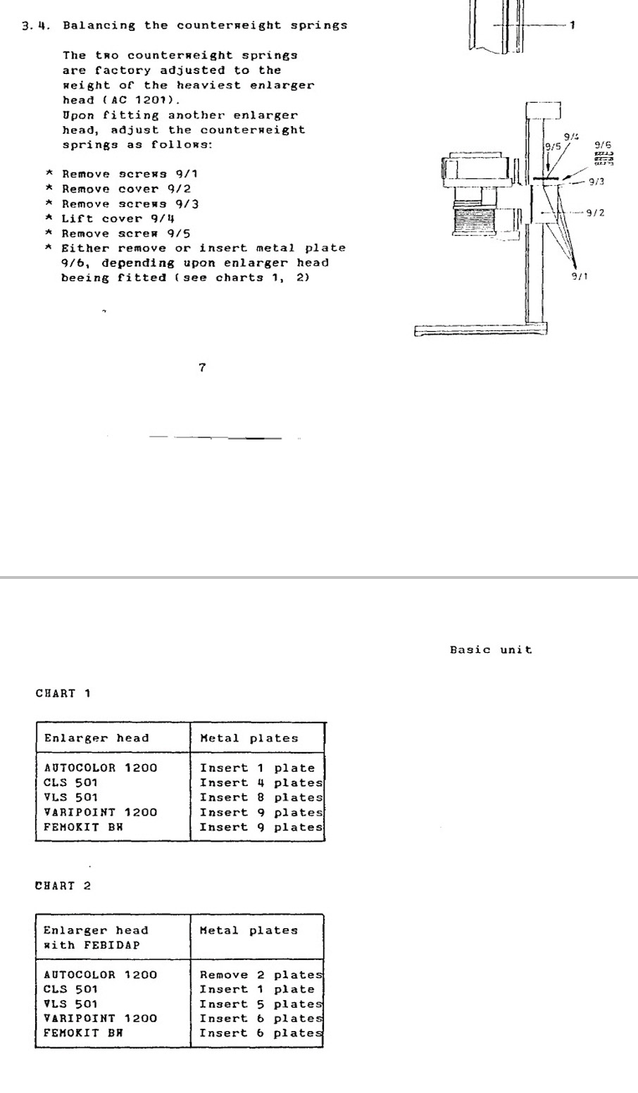

According to official adjustment routine posted by @MARTIE CLS500 (501 is practically same head) is the heaviest of all (I had it wrong/backwards in my last post, so in your case there is something wrong. Does spring box have ANY weight plates inside?

Here's from the English manual.
Wow thanks a lot Marti for this research! You have found the proper way to do it (Technically Durst way)
I would have to buy some plates to level it but removing the screws of the rear spring casing means to remove the spring in the same time. I don't feel like going trough this mission once again. I guess, for now, keeping the counter weights added to the back will be my solution.
All the best to you guys!
