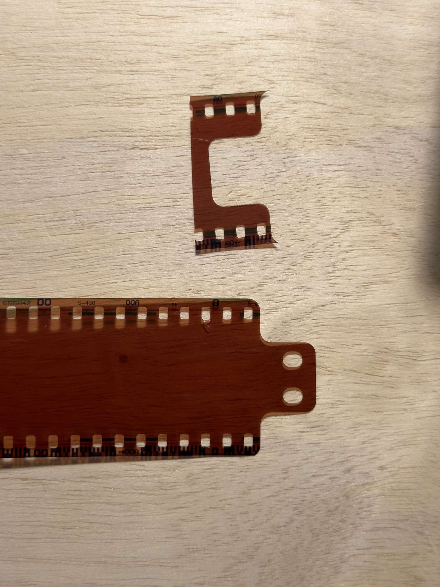

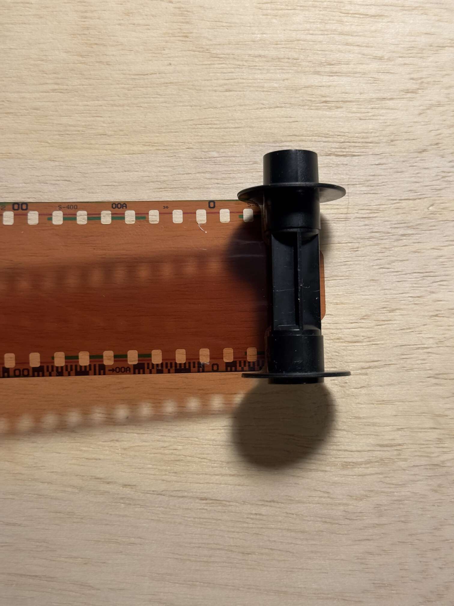

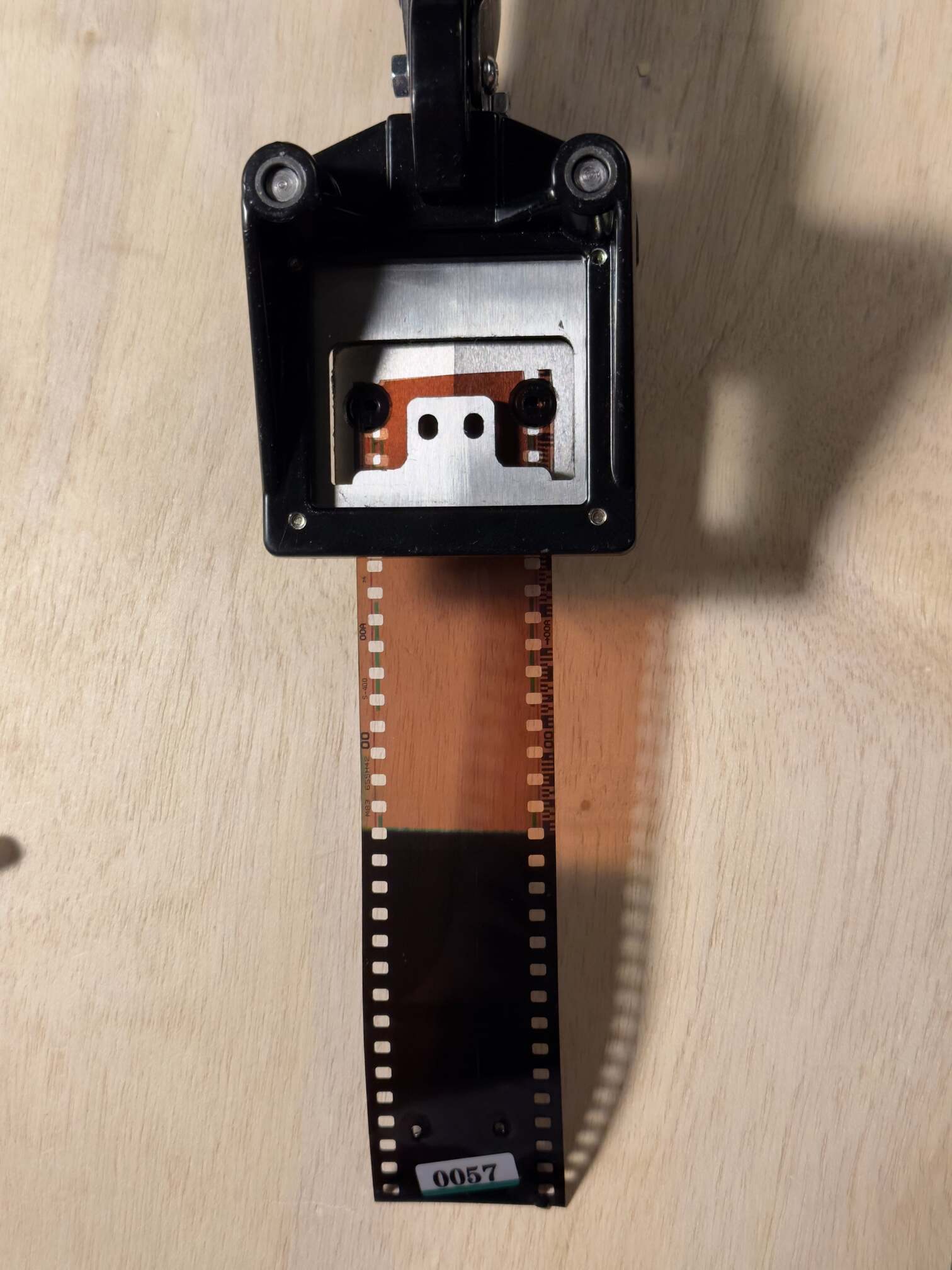

I did purchase a Rezivot film trimmer from Brooklyn Film Camera, it took me about 4 tries, now it produces beautiful results. Made in Taiwan, beautiful finish, comes in a nice cloth bag. I probably loaded a 500 cassettes in my first 30 years of bulk loading never would have dreamed of using such a thing. Sure is nice. 😊

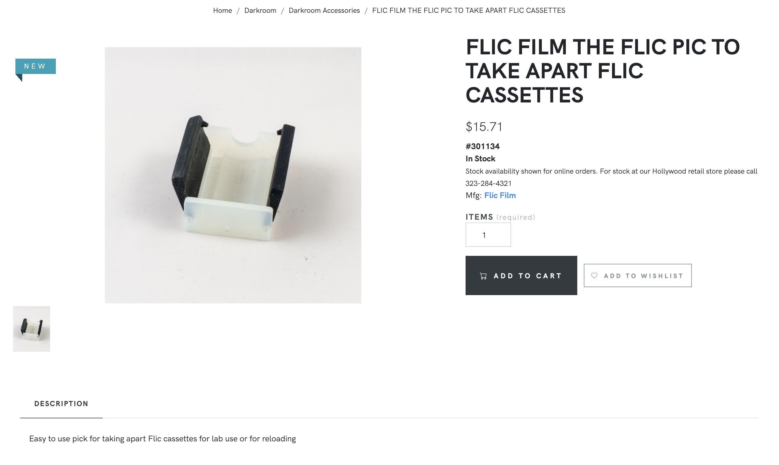

OK well, FreeStyle must have lied to me or changed their minds because this product was added to their site today: https://www.freestylephoto.com/301134-FLIC-FILM-THE-FLIC-PIC-TO-TAKE-APART-FLIC-CASSETTES
Perhaps they just added them to their stock. they are Now showing both the "electra" (c41 non mask Areo film, and the the chrome (EASTMAN 5294 Ektachrome) BUT NOT the Flicx version of 5222 all as "New items" on the web site
