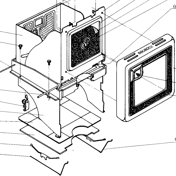

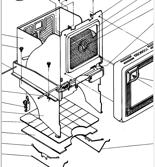

Here is the service manual for the 124
And here is the service manual fro the 124g. This shows the center portion as square, but mine is definitely 24x36mm

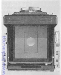

And here is that the 635 screen looked like - with parallax marks..
I think there has to be a diversity of focusing screens in these cameras, then, since there are people ITT reporting that their 124G’s do not have the red lines. I will say that the focusing screens seem remarkably easy to change... four screws and the hood and screen come off as a unit, and then I believe you loosen some more screws and the screen comes out of the hood unit.
I had assumed that the version I have on my D, which matches what you describe on your 124G, was the same version used in the 635, as the 635 is apparently based directly on the D, but this is apparently not the case. I do wonder what the utility of the four-red-line version is for composition, as it does not match the rule of thirds system most of us learned for composition. I suppose a 2:3 ratio frame in the middle is helpful if you’re planning to crop the image when enlarging it to 5x7 or other rectangular formats.
It can’t be useful for parallax compensation, can it? The lines would be much closer to the bottom edge. Look how close the parallax lines are to the regular lines on the 635 screen.
