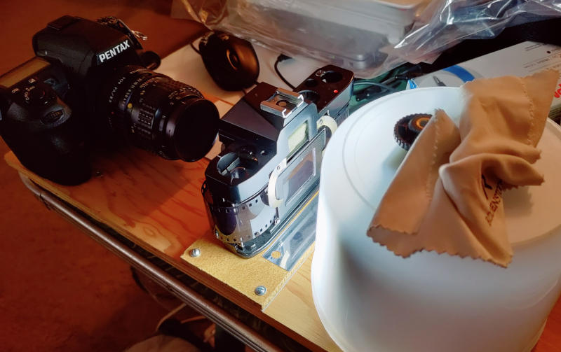

Here's my crude-looking DSLR scanner:
I removed the optics from the teleconverter, so it's now an extension tube for the macro lens, allowing the 35mm film-frame to cover the APS-C sized sensor.
In the second picture above, you can see that I hacked up an old SLR, including cutting a rectangle in its pressure-plate, allowing diffused light to enter. This arrangement holds film flat, yet lets me easily move the film from frame to frame.

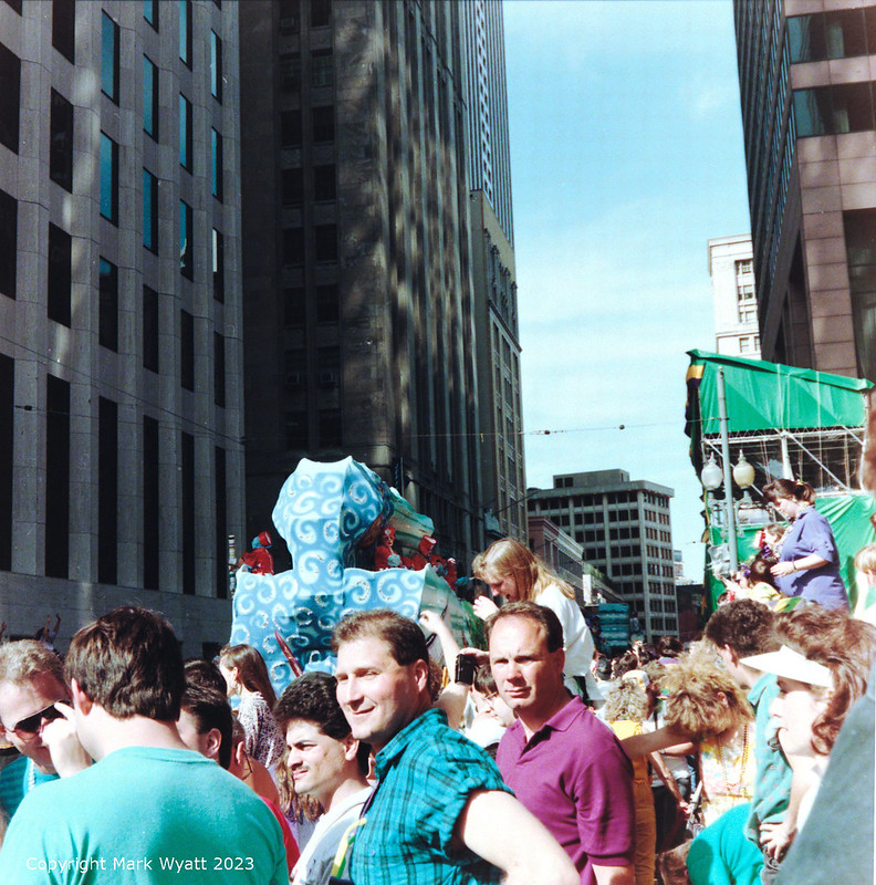

I have Filmlab- an inexpensive reversal software that I have gotten ok results from. I just opened it for the first time in a while, and there was an update. Maybe it has gotten better. For B&W I just use ON1, and create presets for different film stocks.
Mardi Gras Crowd2 by Mark Wyatt, on Flickr

Well, the massive magenta cast has made way for a massive cyan cast - it's certainly different, but whether it's actually better... :wink:
In all seriousness though, these automatic correction tools are (often) great for doing some of the heavy lifting, after which manual adjustments can be made to taste.
Clearly I will not be hired as a salesman for this software! I see the cyan cast. I need to work it some more. I thought the skin tones were ok...

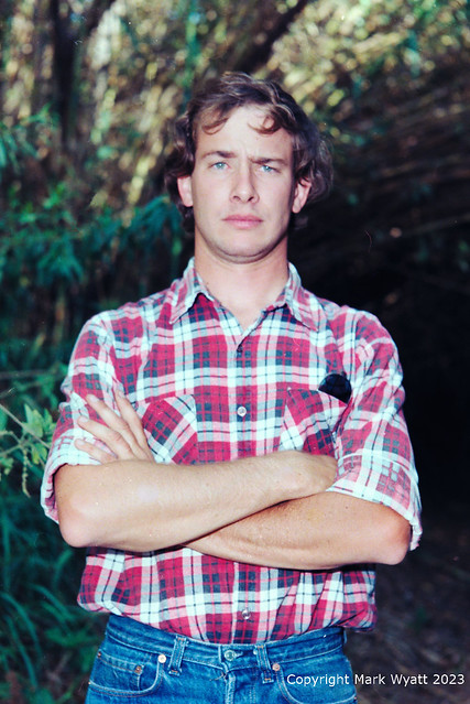

Ok. I kept playing with that neg, but then I stopped, and started with a better quality image to start with. VPS film (mid to late 1980s); 120 (Mamiya C330f, 80mm), Metz 60 CT-1 flash. I read the Fuji RAW into FilmLab, chose the Fuji sensor source, chose incandescent light source (Durst slide copier), and then had to take a little green cast out, Moved a 16 bit TIFF to ON1, spotted and bumped up saturation a little. This works for me.
Doug by Mark Wyatt, on Flickr
