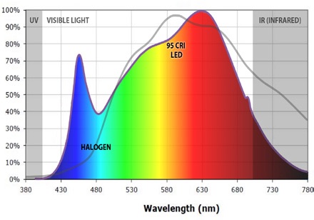

In theory, the panel was set to 5000K. I did an earlier run @ 3200K, but my masking was poor, and I wasn't happy with the result. Will try again. I don't believe I've got an appropriate filter handy.
I think I now understand what Nick Carver meant when he complained that scanning with the DSLR produced "Canon" images-- the resultant image is very much in line with what I would expect had I taken the photo with my EOS 90D in the first place.
I’m sure you are familiar with the concept of smoothing, and this curve is clearly smoothed.
The small hump around 690 for example, is almost certainly a tall thin spike that has been smoothed out, that they couldn’t leave out without being totally dishonest.
The manufacturer could probably come up with dozens of reasons why that’s ok.
But the fact of the matter is, it matters where you have several filters with their own response working together.
Almost all white LEDs work with a combination of two or three phosphors pumped by a UV or other LED underneath.
The research during the last twenty years or so has concentrated on finding (sometimes digging out from research libs) phosphors that work together to have a better spectral response to the human eye.
There is a lot of talk over the years of nano dot LEDs and other exotica. But they have yet to materialize on the market.

Phosphors response depends on the spectrum that pumps them. And even with ideal excitation (which LEDs are not) their response is not ideal and probably never will be.
It’s just physics.
So's the halogen curve. A true representation of halogen's spectral output is pretty spiky as well.
Yes-- Philip's L-prize LED uses, if I recall, red and blue LED's to excite the phospor. But you're repeating yourself.

The halogen curve is spiky like the suns. But not as spiky as phosphor LEDs.

LEDs have some fundamental problems.
ALL light sources are compromises. But you appear to have a fundamental problem with LED's. We get it. You don't like them.

It’s easy to imagine a better lightsource than LEDs. The problem is not so much the phosphor as such, it’s more the exciter source.
