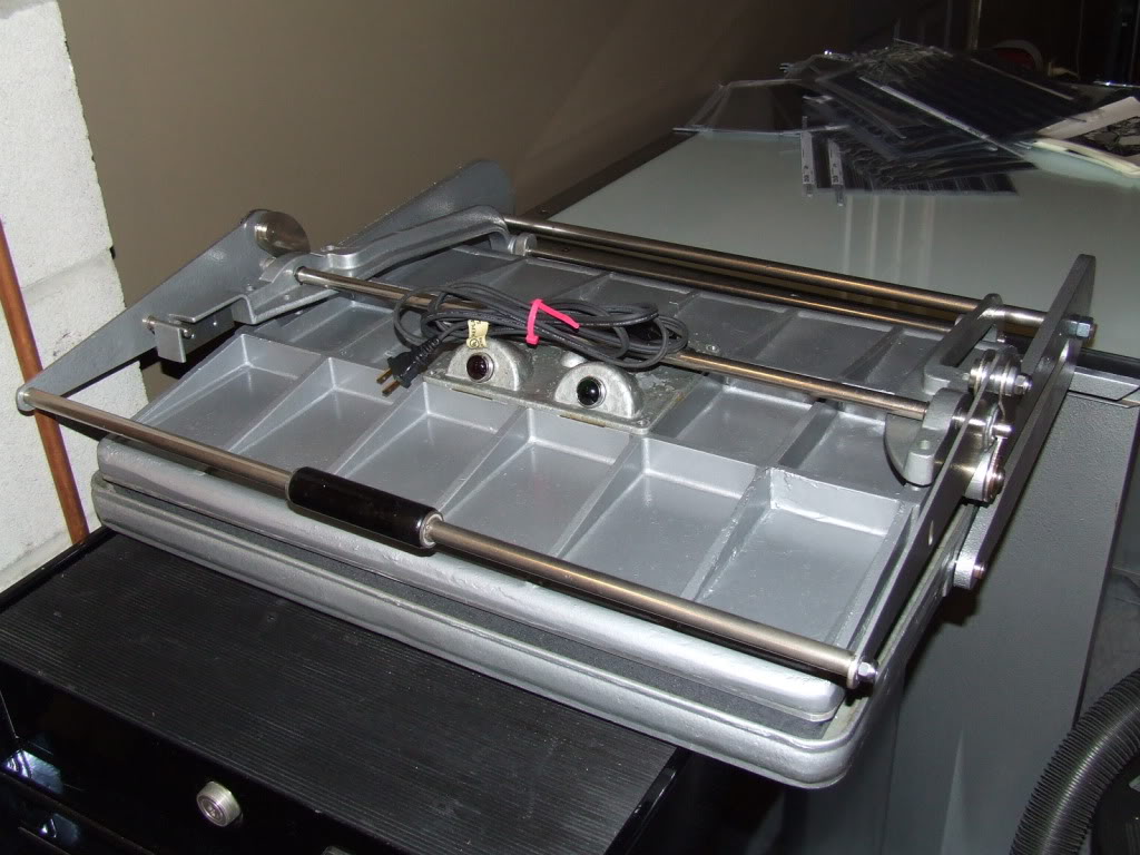

I use an old heated dryer for test prints. The final prints get dried on screens. Then flattened in an inexpensive press I got in a trade. I did not really want the press, because I don't dry-mount anything. But once I figured out it flattens prints, It is indispensable in my darkroom.
On the drying screens, the RC prints go emulsion side UP and will dry flat that way (as in the picture).
Fiber based prints dry emulsion down on the screens, otherwise there is a risk of folding over an edge when they go in the flattening press due to extreme curl.
