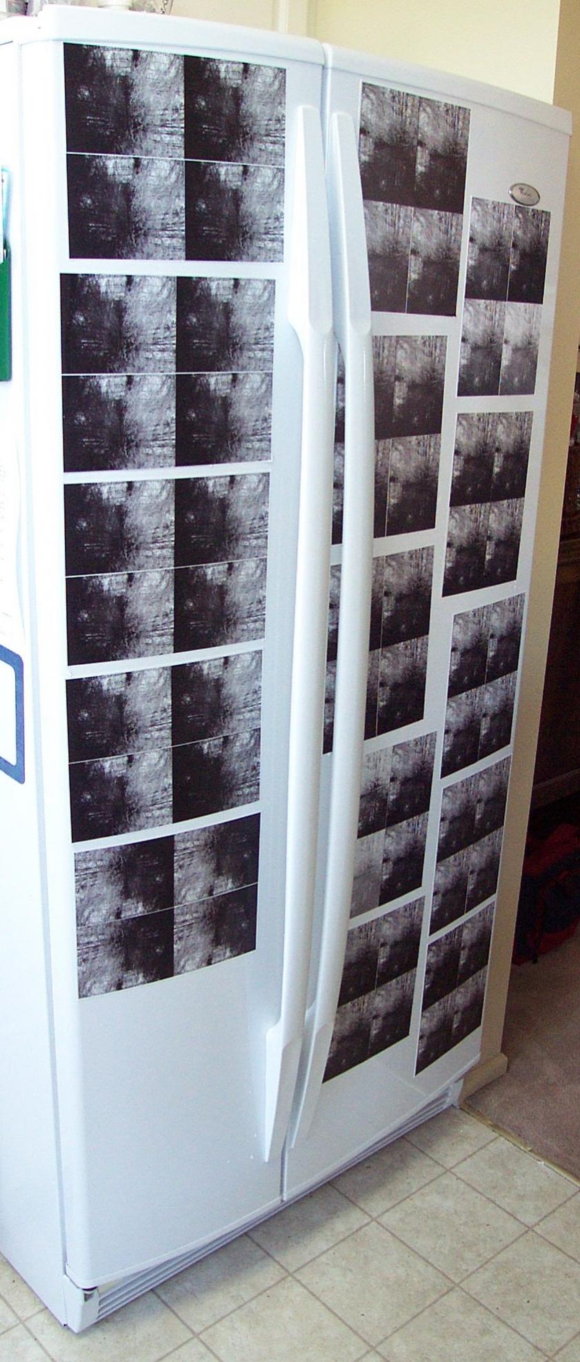

I just gently squeegee the RC prints on to the front of my refrigerator - image side out.
After a few minutes, they come off the refrigerator and go into a drying rack that started out as a holder rack for Vinyl LP records.
After about a further half hour, they are 95+% dry - depending on ambient temperature and humidity.
Here is the refrigerator about 5 years ago - during a postcard exchange.
