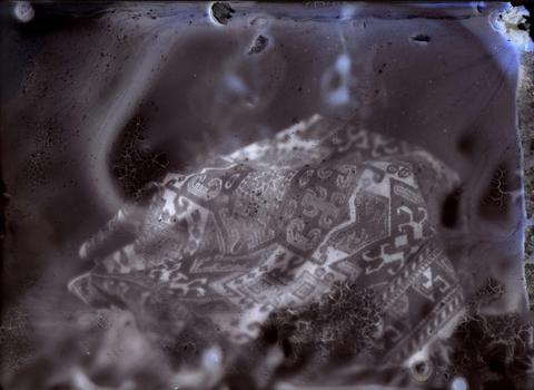

I made this using Rockland Colloid AG+ a couple years ago. I'll have to dig out my other experiments.

The key in dry plate emulsion is the contrast and shadow details. Emulsions made originally for printing is too high contrast and in particular too steep contrast in the shadow region (poor shadow details).
