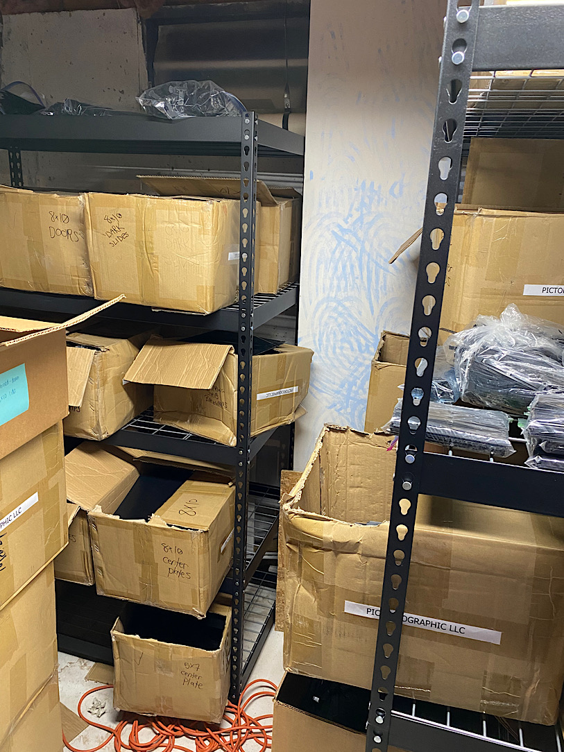

Rest assured the ChromaGraphica double dry plate holders are made right here in Brookline, and have been since the 2019 Kickstarter campaign ended. In fact, my employee in charge of their assembly just released another dozen new 4x5 holders today into inventory.
Steve Lloyd, myself, and my business partner Max designed these holders for the 2019 ChromaGraphica Kickstarter campaign. Hence the conglomeration of our respective business’ names in the branding. This was an equal partnering, born out of my desire to provide an economical plate holder to the dry plate community. The history of its development can be found right here on Photrio.
We designed both a dry plate holder (holds two plates) and a wet plate holder. Pictoriographica manufactures the dry plate holders and Chroma Camera manufactures the wet plate holders. However, we share a full partnership on the entire holder product line. It’s been an enjoyable and satisfying partnership, and I like to think the niche plate photography community has benefited from our combined creativity . Steve’s a good guy.
The Slovenian holders do not have the loaded plate indicator, which is a feature that Steve and I invented. They are also not injection-molded like the ChromaGraphica dry plate holders. However, they are nice in and of themselves, and do their job just fine.
A couple pics of the assembly workbench (a stack of holders ready for final inspection) and inventory of parts. Not very glamorous, but definitely “here”.
