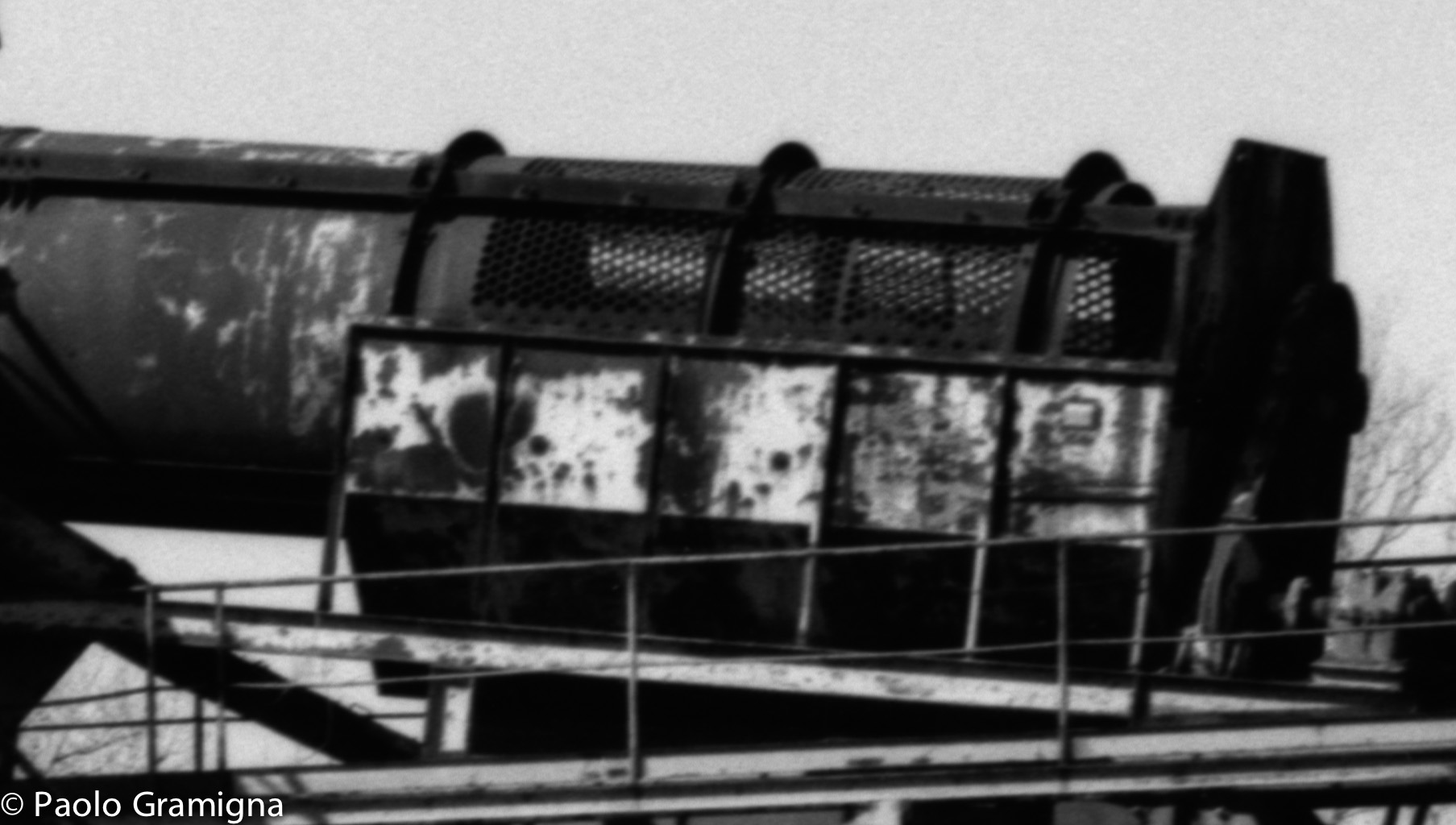

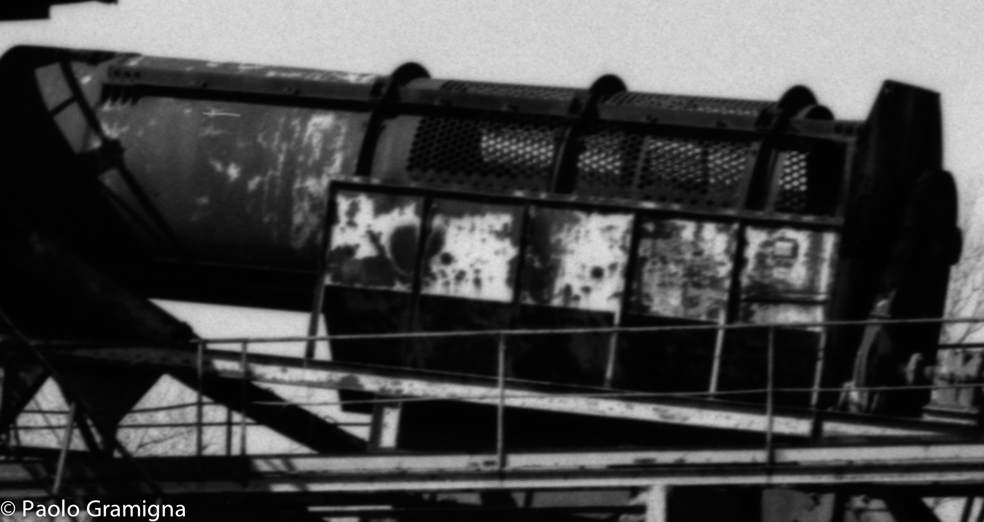

I took a well defined 6x9 negative, and scanned it as usual. Then, without changing any scanning parameter, i wet mounted it to the NON_ANR side of the glass using a few drops of Zippo lighter fluid, with the emulsion facing the glass and the negative "suspended" below the mount's glass. I taped it all around (after GENTLY squeezing out the air bubbles with a lint-free paper towel) using Blue Masking Tape, and i DID NOT superimpose a Mylar sheet, for the very simple reason that i had none; the negative was flat on the glass anyway, and it was not scratched on the back side, so i decided to avoid it.
Scanning was done at 4800 DPI, no "enhancements" at all, flat curve. No enhancements in Lightroom either.
I'll attach to this post two scanned jpg of the same negative, one dry mounted and the other wet mounted; and i'll attach two crops, so you can compare.
On my humble opinion, the Wet Mount is better. Non astoundingly better, but better it is.
And using the Zippo fluid, the whole process is not "too much" time consuming than the Dry Mounting. It's a matter of minutes.
After the scan, i removed the negative from the glass, gently blowed on it and the negative was dry and perfect in a matter of seconds.

wet better fur sure
Well, not SO MUCH better; but better it is, especially when you print it.
Moreover, i was not using a proper fluid, but just some Zippo lighter fluid; and no Mylar covering, just tape all around.
I wonder how it will be when my Kami fluid and Mylar will arrive.
Finally, it is not so messy and time-loosing as somebody said in several posts. It took maybe three minutes to mount, all including...
let's wait for the arrival of Kami, and then i'll be back...
paolo
I've used both Kami and Zippo. I don't think you'll see a difference in the scan, but at least with my Zippo fluid, I get a slight amount of residue left behind.
You can make a blend (mineral spirits and naptha) that gets you closer to Kami (see the MSDS for Kami, or search DPUG, a blend has been posted). But the one advantage of Kami is that the fluid is very clean, doesn't leave a residue. Zippo is not designed for this use, I guess a bit of impurity is acceptable in its normal use.
I think you'll find the mylar cover aids in a few ways - it helps keep more curled film (like 35mm) completely flat, and it keeps the tape off the film entirely. You might find with 4x5 you don't need tape at all, or mylar. At that size, film is more well behaved than at 35mm or 120.
Thanks very much for this test. To my eyes (and on a laptop screen), there is not much difference in the crops. The wet mounted one is a bit better but not by much. I am wondering how it would differ with a dedicated film scanner. I have a 9000 but have not yet gone the wet mounting route. I might still though.
