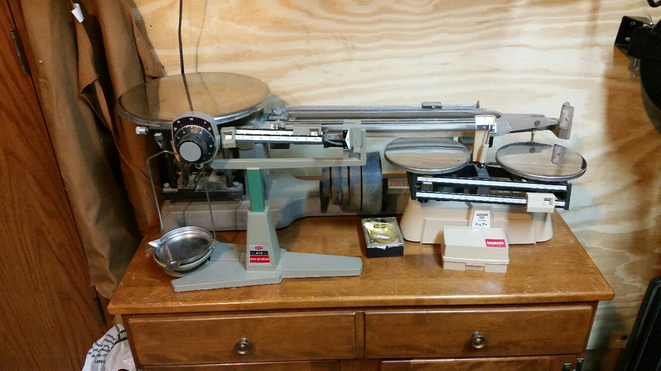

Here's my 3 most used units. I have an analytical balance, but I don't do much it.
PS, I grouped these together for a photo. The two small balances are stored in a cupboard when not in use. I have a neat lab table where I can weigh my chemicals. That big solution balance works great for making straight hypo solutions. You can look up specific gravity of solutions. Weight out the dry hypo, put a large plastic container on and tare it.
Then dump in the dry, add water until you hit your target weight.
