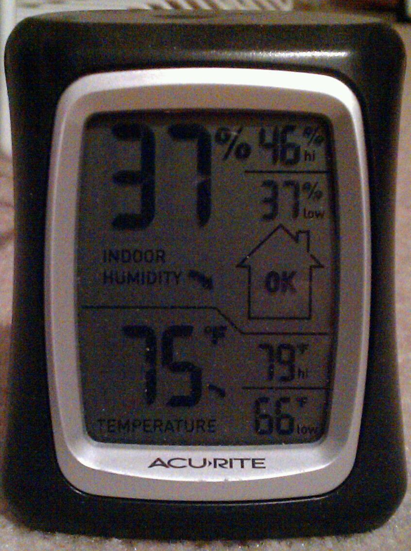

According to Zeiss, fungus will form at 70% relative humidity for three days:
http://www.zeiss.com/camera-lenses/en_us/website/service/fungus_on_lenses.html
I have four temperature and humidity sensors in my dedicated Camera Room. Most of the time the relative humidity is under 50%; this week it's been between 38% and 45%.
So, I doubt that your humidity in NYC would be close to 70% - but it wouldn't hurt to monitor it. Small battery powered monitors can be bought for about $6.
No a bad idea at all. What model would you suggest? Any other tips as to what differentiates your dedicated camera room from other rooms (aside from the cameras, haha).
I think all the low cost models are made by the same company and just rebranded. They cost about $6, take a AAA battery that has lasted over 18 months now, and record daily highs & lows.
I will post a photo of one later.
No, there's nothing special about the room other than the cameras and the nice light pink of the walls. OK -one thing- it only gets a bit of direct sunlight in the morning, otherwise it's lit by reflected light. Also, it's upstairs with forced air heat & AC vents in the ceiling.
I use the shower for drying film.
Definitely do, and thanks for the tips!
Here is one of my little monitors; it's small enough to fit in your hand:

There's a bunch of Temperature / Humidity graphing recorders on eBay right now. One guy has about a half dozen for about 15 dollars shipping included. I took my chance on one, will let you know if that was worth it.
The first thing I'll do with it is test the corner of the bedroom to see what's going on there and what might improve matters (for instance maybe a small solar-powered fan could move the air enough to keep down the humidity there)... Then I'll set it up in different places where I might want to keep gear.
