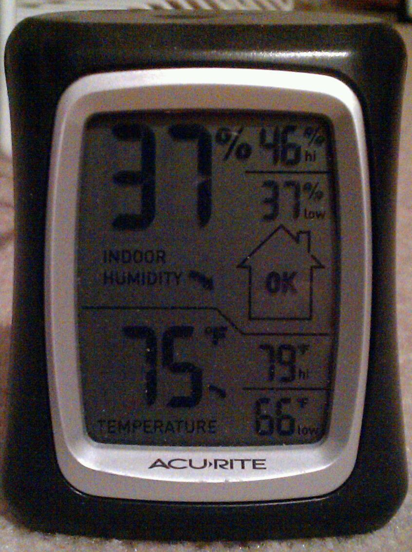

Here is one of my little monitors; it's small enough to fit in your hand:
Bought one of these, thanks so much for the recommendation! So far the humidity has been 40-61% here and 70s for temperature, so I'm okay for now but curious as to what will happen when summer comes around.
