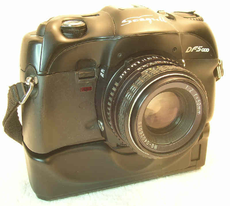

I'd get one except I have a couple of these (one Seagull, one Phoenix) which is really a X-570 in wolf's clothing:
What the heck. Never heard of it. I guess I have some learnin' to do.
The final years of Minolta's manual-focus camera production was done in China by Seagull. This included the X-700, X-570, X-370, X-300, X-9 and several other similar models. These are usually marked on the bottom, "Made in China". After Minolta stopped production, in 200?, Seagull continued to make these cameras -- with Seagull and other labels, such as Kalimar, Vivitar, Soligor, Argus, Zenit, and many others -- with a lot of variation from what Minolta had designed, such as the Seagull DF5000 above -- in a covering designed by Colani. Most of these cameras had the same horizontal, electronic, cloth shutter as the Minolta-branded SLRs, but some had metal, vertical, mechanical shutters to 1/2,000s, for example. Others kept Minolta's horizontal, electronic, cloth shutter, but dropped the TTL completely for total manual operation only. Some offered a T shutter setting in addition to a B setting. Some had extra long shutter speeds. The list goes on and on.
In short, Minolta's 35mm SLRs did not die when Minolta stopped manufacturing them. It actually flourished at Seagull -- under various names. And Minolta-style SLR lenses were made as well -- some still are.
