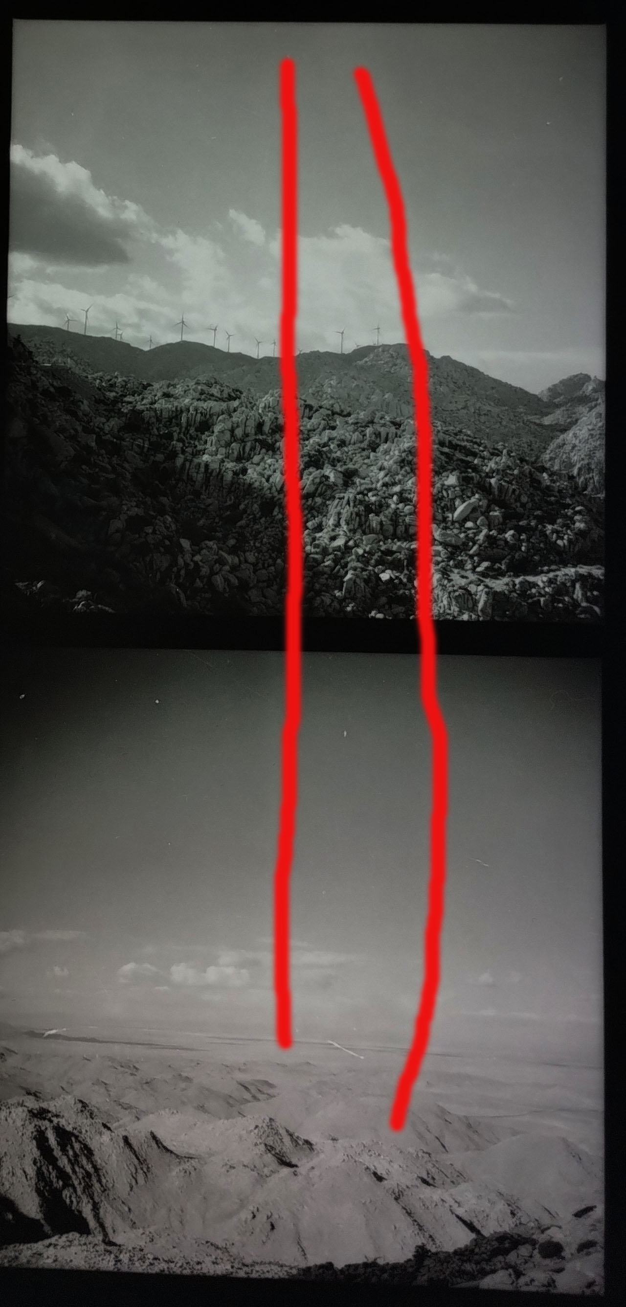

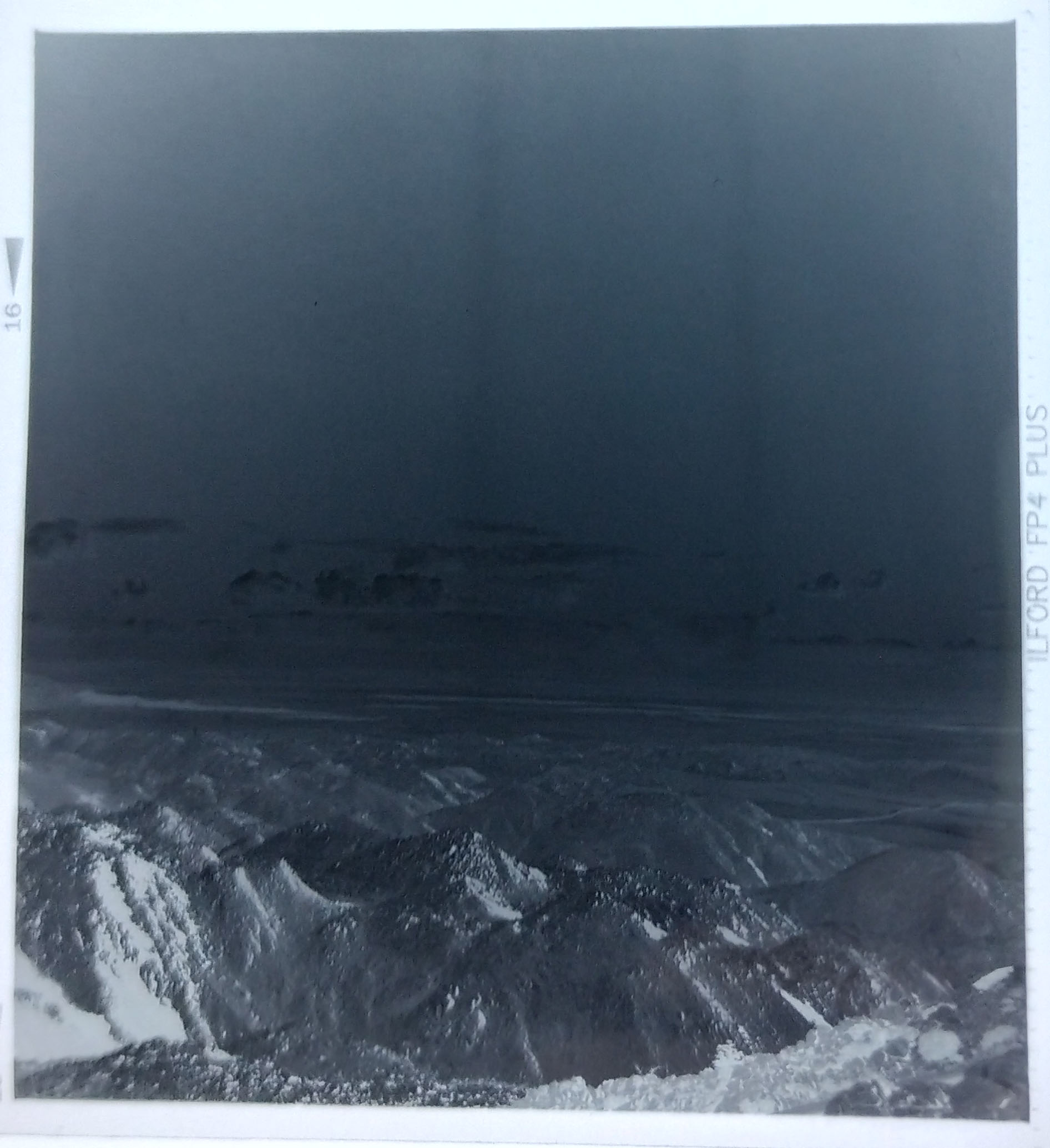

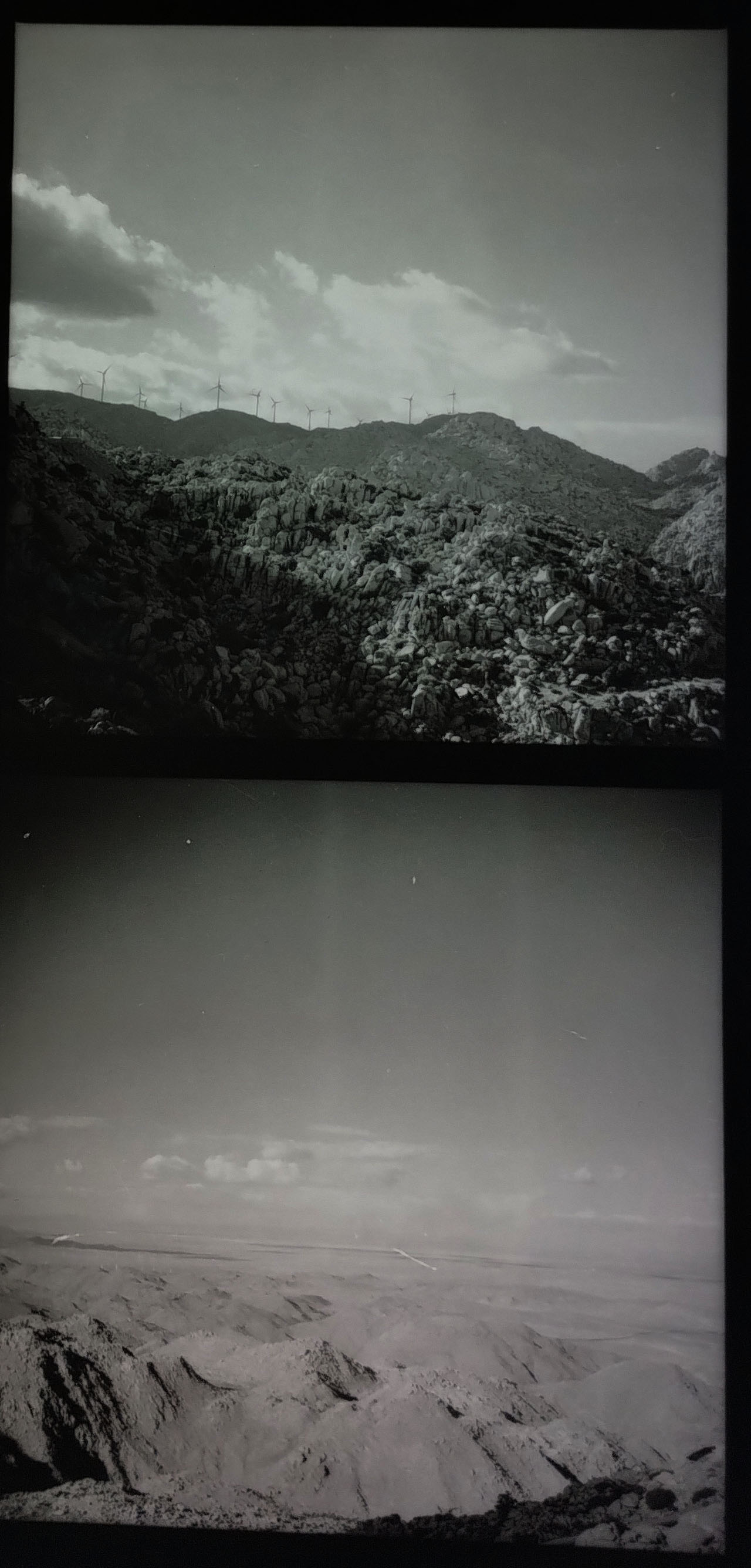

Some of my negatives display some sort of drag artifact, and I was wondering if you may be able to help me identify the culprit.
I'm attaching an example, both positive and negative.
I have reason to believe that the streaks sometimes run along more than one frame (see the attached image with the red markings).

I saw a similar post from 2023 on this forum, but I don't think they ever reached a conclusion, and in any case I think they're missing a piece of info.
I'm pretty sure it's not an issue occurring during the development, but rather I think it happens after, when the negatives are hanging to dry.
The reason is the direction of the streaks. They always run along the length of the negative, which is sitting horizontally during the process.
While it hangs, however, it hangs vertically. And the streaks themselves kinda look like water paths.
I'm thinking perhaps stop in water is not sufficient?
I have stopped using commercial stops because I had some issues with pinholes on the negatives, and apparently stop baths can cause that.
I might try some very diluted acetic acid.
What do you think? Do you agree with my suspicion?
