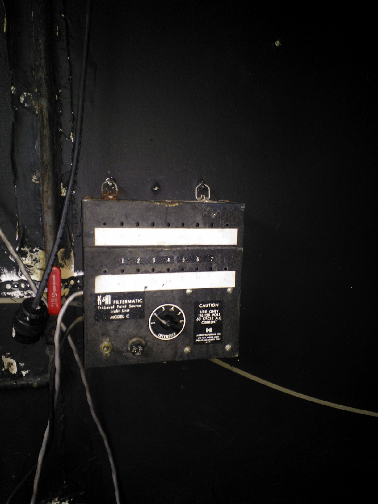

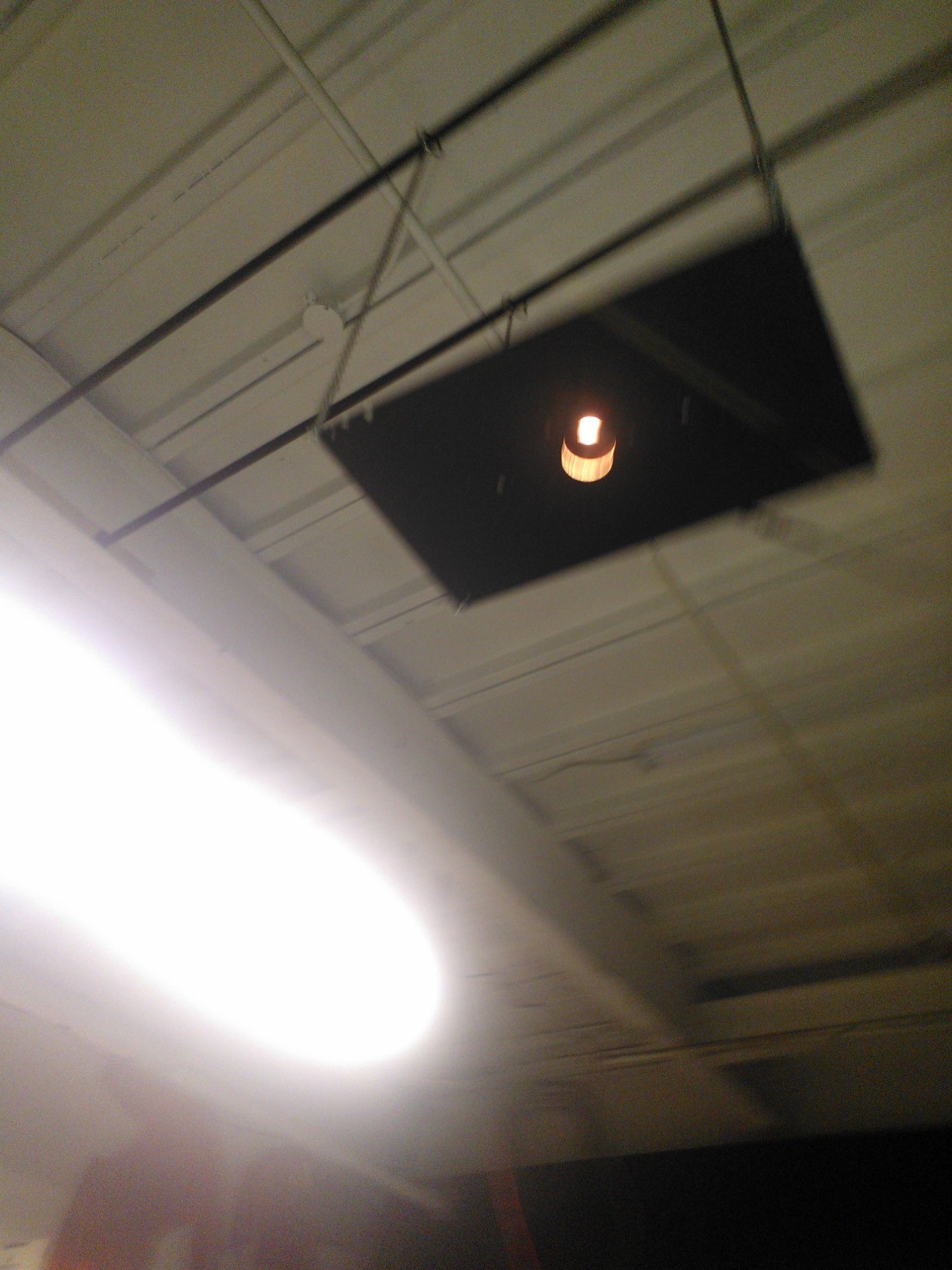

I was asked in a PM by the OP to describe my working method, and rather than do it by PM I would prefer to put it here so those interested can see.

I put all 12 litres of dev in the first stainless steel tank you see which is the farthest from the camera , I load all my film in holders and can do two hangers or 8 sheets at a time.
I use a 5 minute time with a flash half way between, by laying the two hangers on the steel plate between the dev and the fix and turn on the light.
I use a flasher as shown connected to a power unit which can double or triple power .. that is connected to a timer... the flash is always between 2-5 seconds.
I have adapted the flasher unit with current bulbs and have bought enough to last my life...I use Mr16 dichro cool eye bulbs

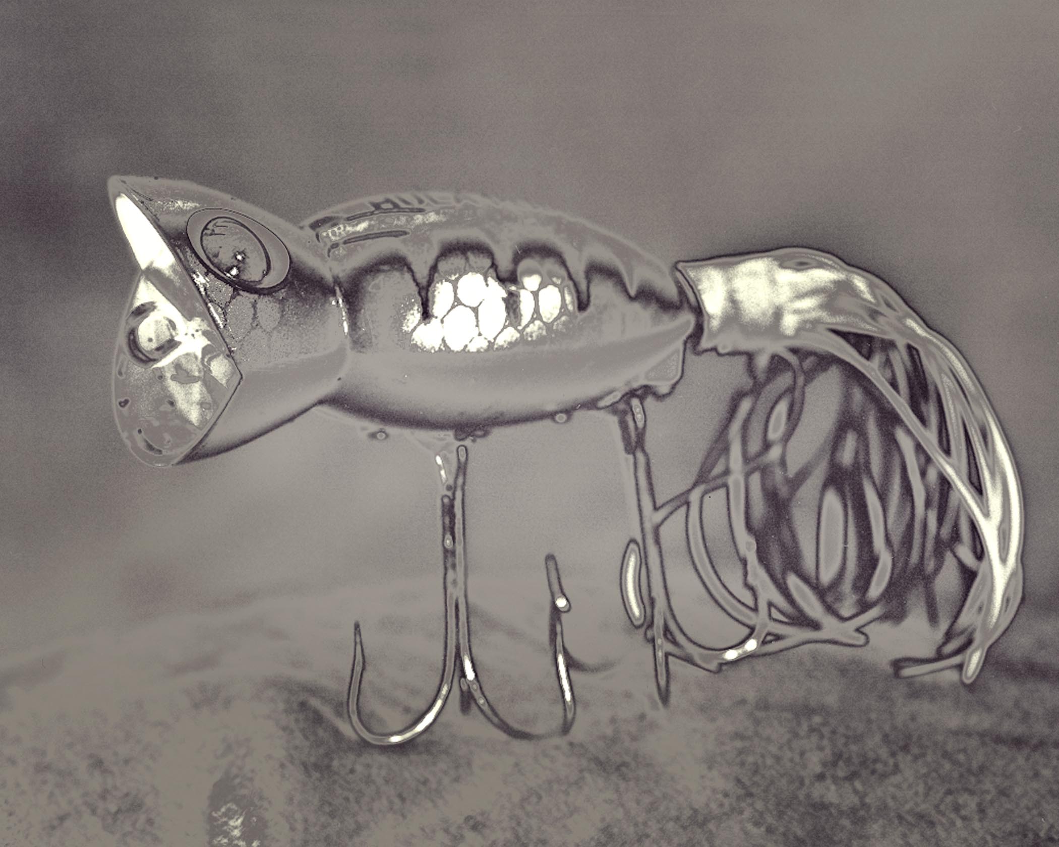

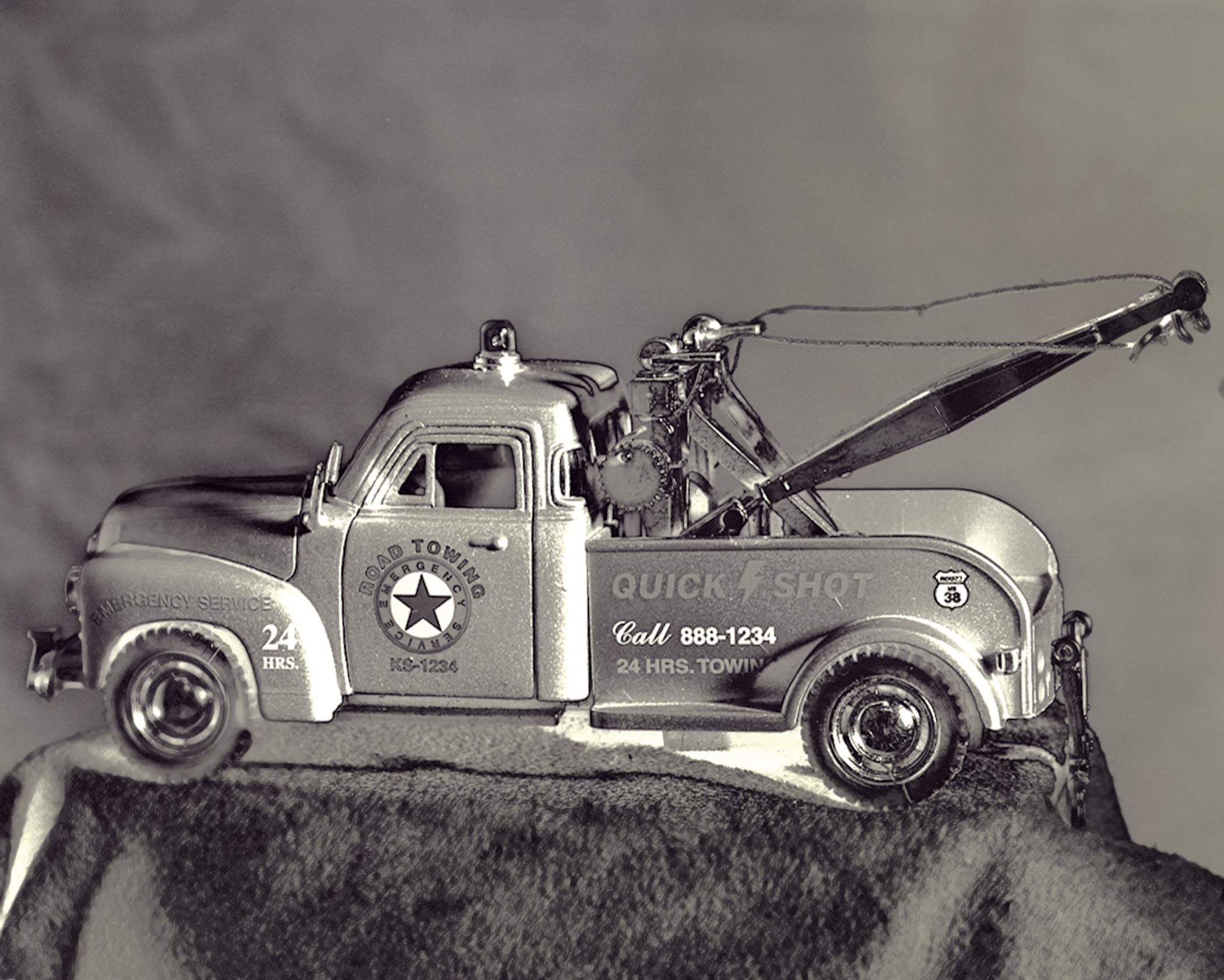

Here are three more that I exposed in the last couple of weeks, These are not scans from real prints but interpertations, so they are not exactly
how the main series is looking.
