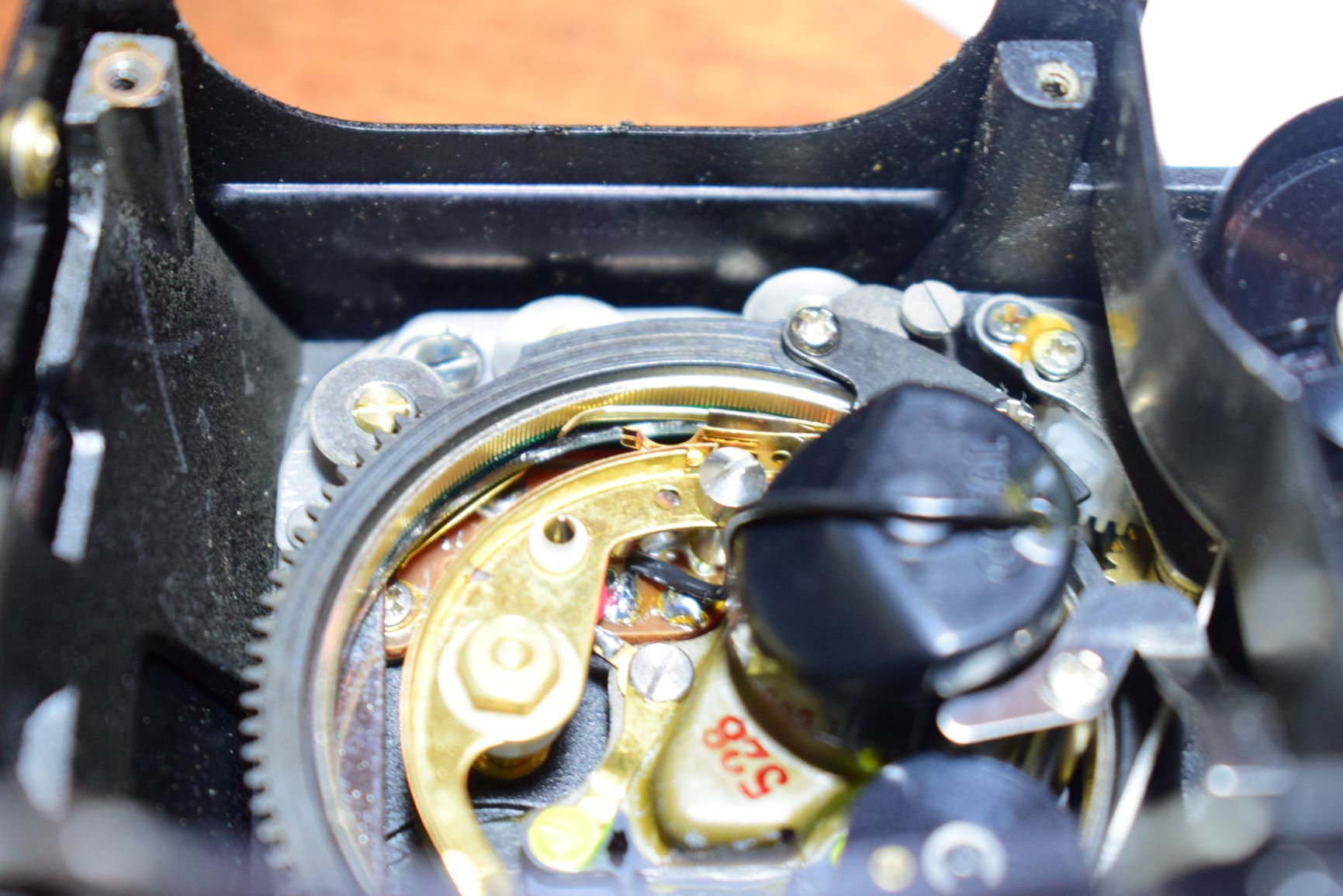

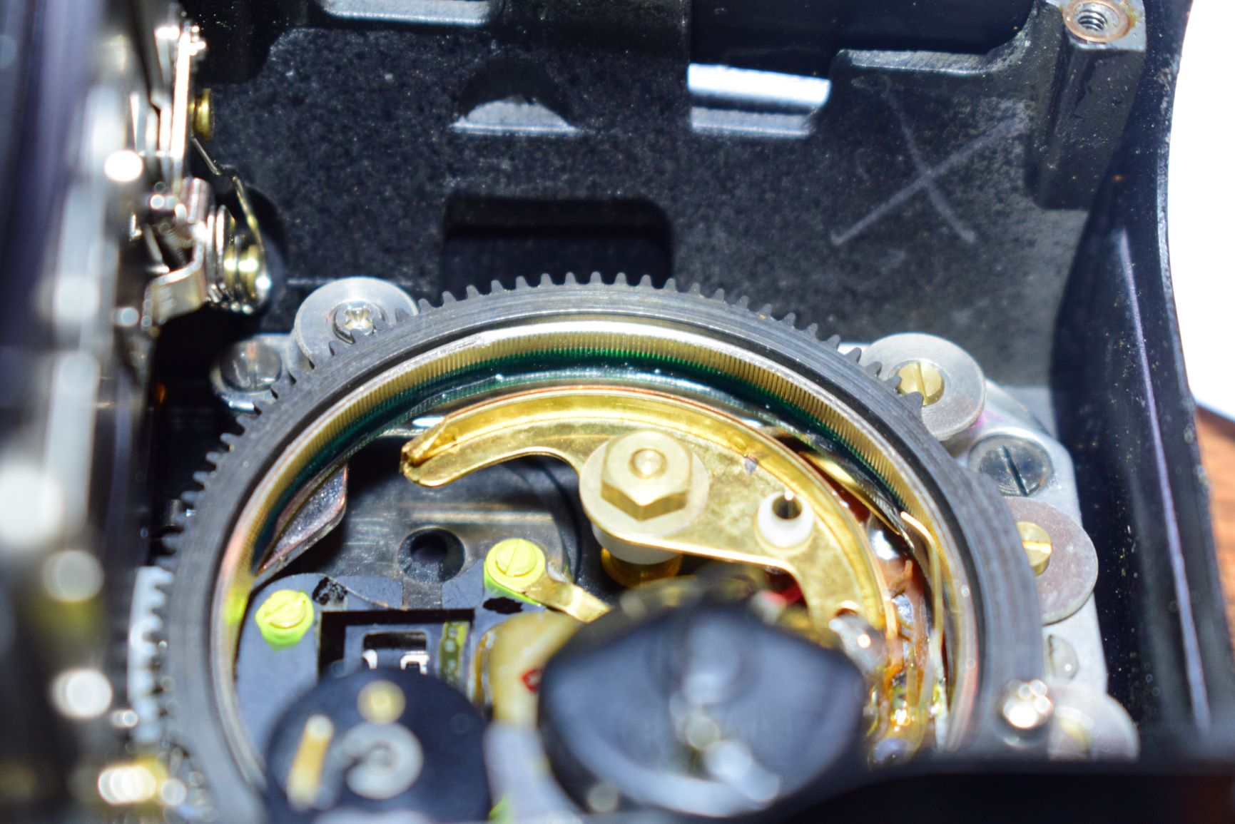

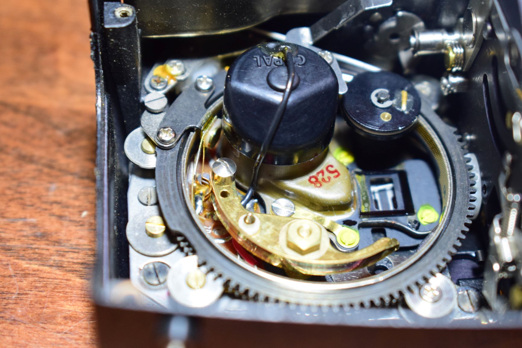

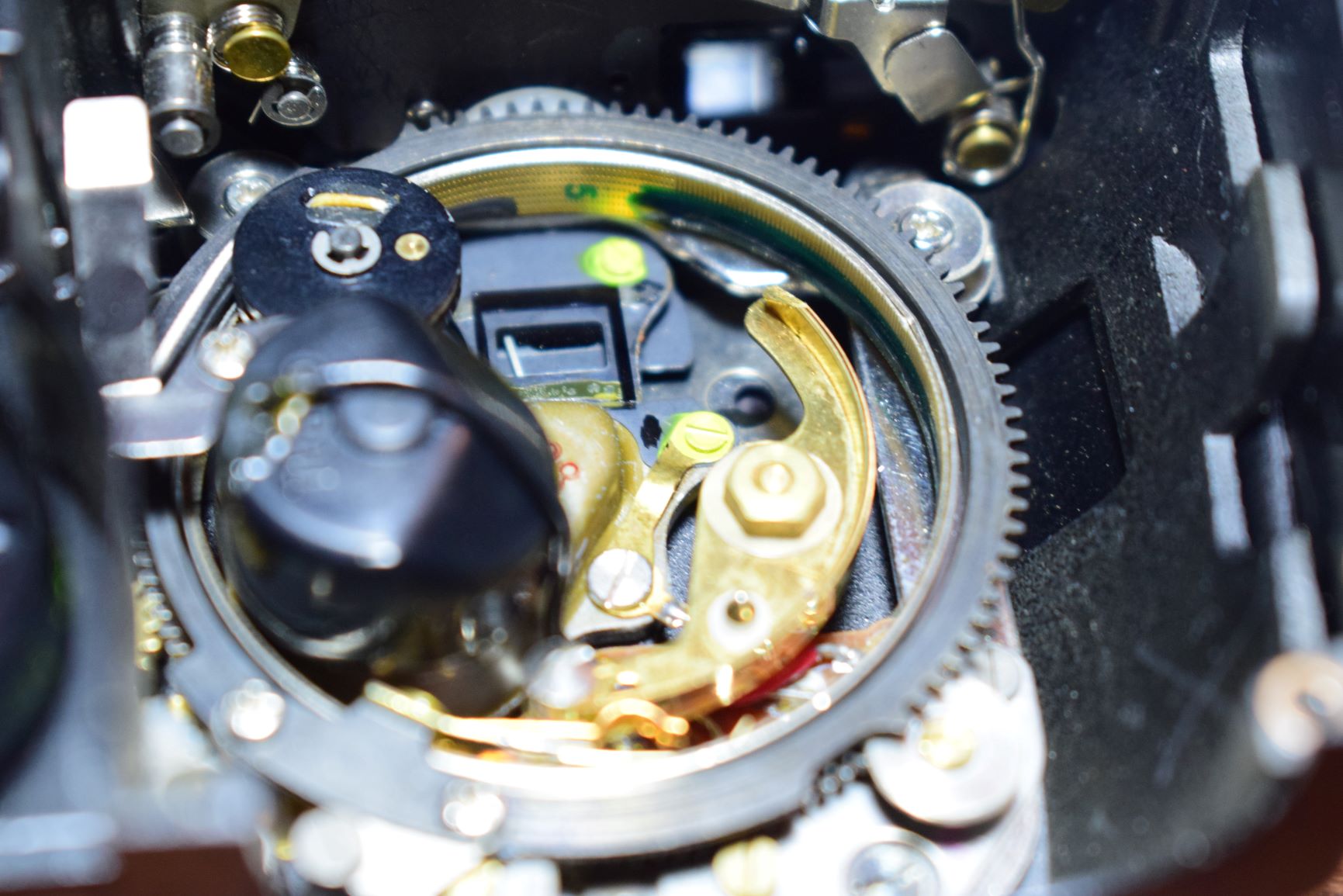

I got it apart, but it looks brand new in there. The ASA dial and indexing tab move the resistor smoothly. I guess, I'll try and clean it, but I don't think that is going to matter. I guess maybe the photocell has gone bad? I don't know how likely that is when it looks so unused. I know that the selenium cells had much shorter shelf lifes...

CDS photo cells do seem to degrade with time (this is controversial) but rarely fail completely.
have you checked for bad/cold solder joints and degraded wire ends?
I looked around and didn't see anything that seemed amiss. The battery check works, as I said, so there is power. I can feel that there was what felt like normal resistance, and the "brush" looked like it was touching the resistor, but maybe my bad eyesight fooled me.
This finder is in really good shape, so I am surprised.
