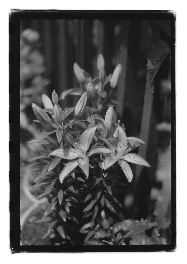

Double-X, Cinestill Df96, EI 400 and Push +1 process. Kiev 4, Jupiter-8.
Going through some older images from about 6 or 8 years ago which was the last time I shot double X. The grain is definitely tighter and more pleasing (to me) than TriX, more pronounced in the above and not sure if developed in hc110 or Rodinal here (probably Rodinal above, hc 110 below as that is what I was using back then). The above is with the 35/2 fd chrome nosed (thorium) lens. The below was from a minolta xd-11, not sure of lens but either the 35/2.8 or 50/1.7
I have a 100' roll recently purchased this winter and looking forward to really diving into this film.
