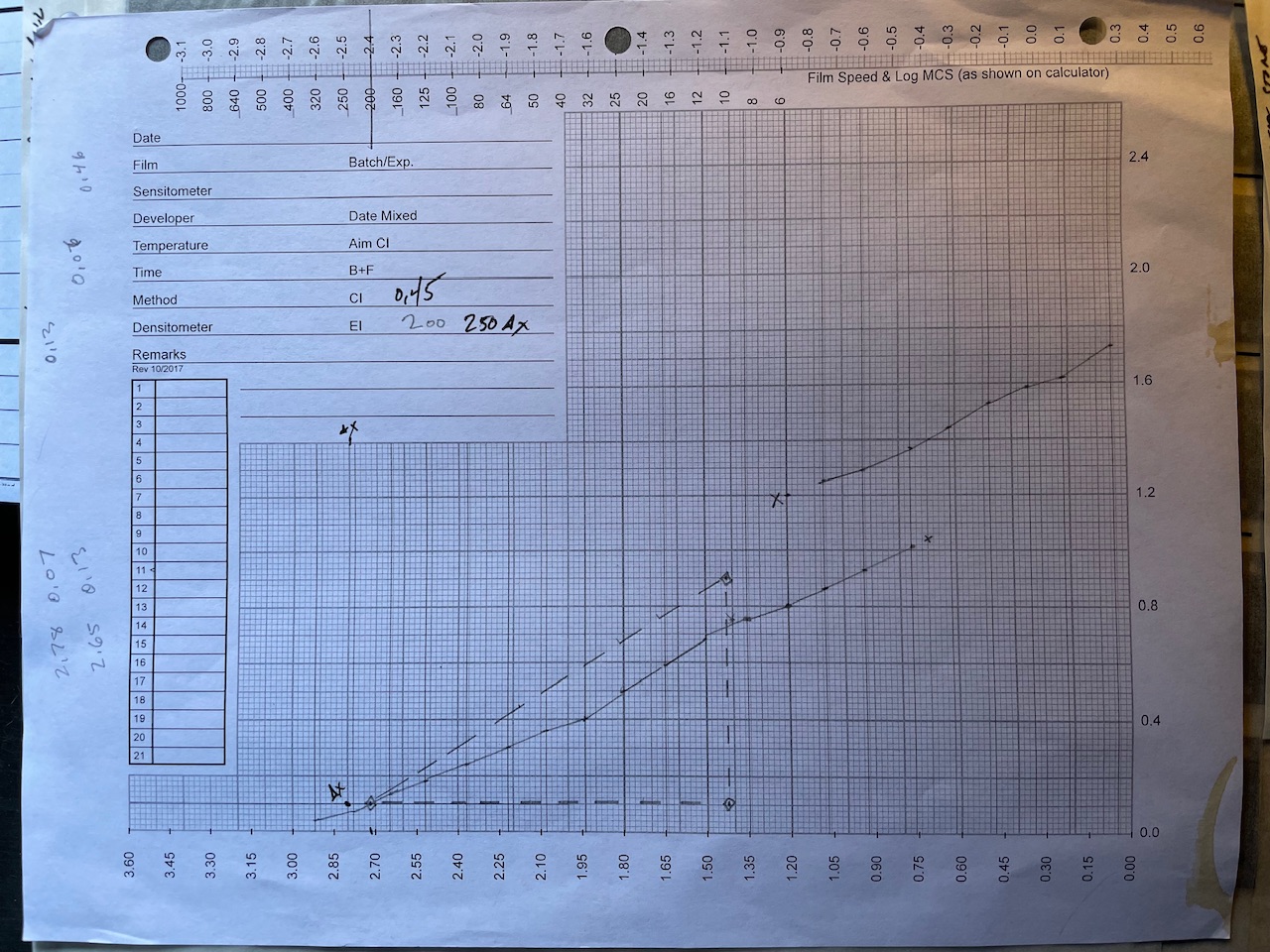

For ordinary agitation - say once every 30 seconds or so - I expose anywhere from 1/3 to 1 stop slower than box speeds. I do not see a huge Hard-to-Soft exposure ratio for the overall image. Of course, I vary that ratio all over the place to tune local contrast.
If I am doing Extreme Minimal Agitation I expose 1/3 stop slower (EI 200). For semistand, I expose at full box speed of EI 250. Both in neither of those cases am I using D-76. I am using either highly dilute Pyrocat-HD(C) or D-23. In these cases, I am leaving the film in the developer of choice anywhere from 28-60mins respectively. The dilution manages the highlights, the long development time gives me shadow speed.
Obviously, all this depends on how you print, how you visualize a scene, but for "normal" use an EI of 160 or 200 and 7.5 ish minutes in D-76 1+1 gives me very fine grain, good sharpness (well as good as the film is going to give you, I guess), and well managed highlights with good shadow control.
