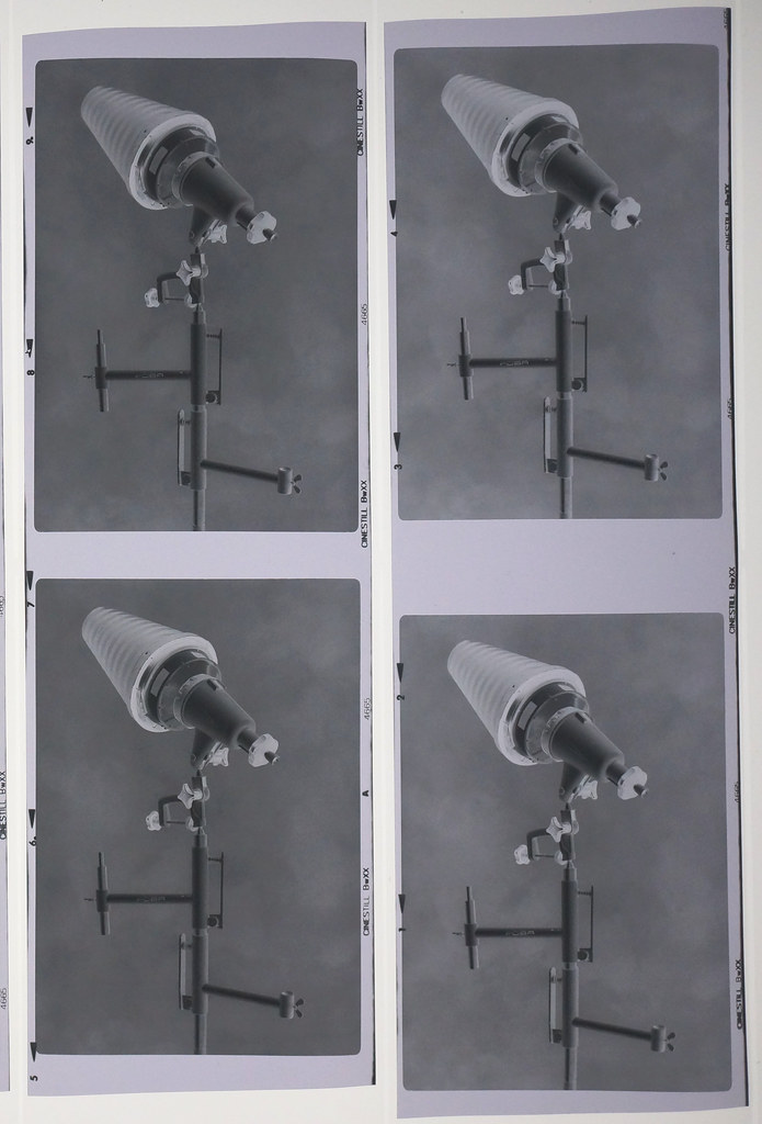

I did some testing, limited, but at least same scene, same camera. see:
For sure, some viewers guessed correctly (and I really admire their sharp perception) but nevertheless...
Bottom is Plus-X but really they're about the same.
With FP4+ is possible to get results almost indistinguishable from Plus-X as you showed
I'm not seeing much difference. Certainly not enough to convince me that FP4 is a poor substitute.

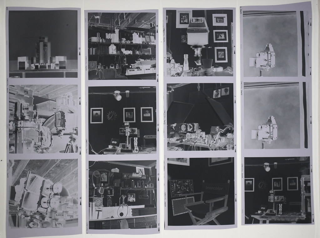

RE: sharpness, I will post one example of a Cinestill-BwXX negative that was processed in EcoPro, 1+1, which I thought was sharp enough, though perhaps less so than what I've seen from Ilford Delta 100 and some others. My (limited) Double-X/5222 results do tend to show somewhat more prominent grain than the other medium-speed films I have tried in Xtol/Eco-Pro.
The sharpness and grain are fantastic! Pls confirm this is 35mm. No so enthusiastic about tonality, this pic gives me an impression of "hazy day", i.e. compensation, or compressed highlights. But that might just be the scene as it was.

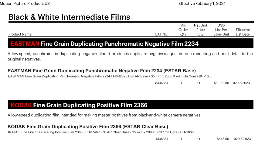

Charles, does Eastman Kodak still make those BW Lab films? I was under impression that ORWO/Filmotec was the last one making them.
they still have them on their web site! these days you have to look at the film catalogue and then wade through a few dozen Product change notices and Price changes... this is what the USA Feb 2024 Catalog shows.
I suspect that the Filmotec Lab films may be dependent on the health of that overall business. the ORWO.Shop site only shows very large rolls of ORWO DN-21 (similar to 2234) with all out of the big rolls of the DP31 (simalar to 2366 BUT Dp31 was also Pancro.)
they still also show PF2 in 610M rolls but only in acetate, while Kodak 2302 is estar and the acetate version 5302 is discontinued. the movie industry us mostly using digital intermediate these days of course so other than special effects and archiving, the demand is likely way down. (especially for B&W film)

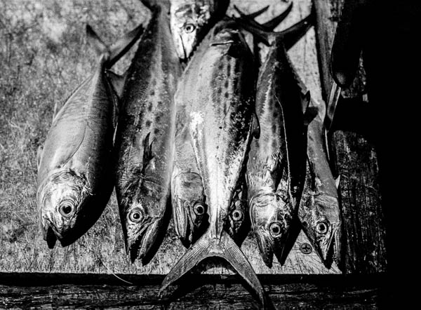

I've shot XX off and on for two decades now. I've probably used a couple thousand feet or so. I've never found it to be high contrast with any developer. Unfortunately, I never kept track of developers until about a decade ago which is a shame since I tried a million of them back in the 00's when Agfa went belly up. These days I pretty much just use Rodinal for 35mm and under, and PMK for medium and large format. I occasionally use some others as palate cleansers. I prefer lots of grain though. I am not looking for fine grain. The best developer I'd say I've used with XX for overall quality is Pyrocat-P. I'd say XX is one of the easiest films to use. I cut it down these days to use in my Minox.
I usually shoot XX at 250. The limit I've found is around 640, after that the shadows start to drop, but I'd imagine you could get a little more out of it depending on the developer. I use it in the Minoxes at 400 which works well even for that tiny negative.
This is 35mm XX in a Contax/Zeiss developed in Pyrocat-PC.
