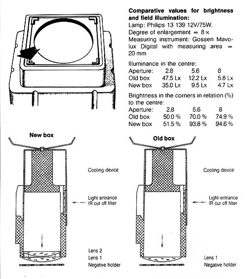

Around 1987 or so, Leica replaced its diffuser box with a double-condenser version. Enlargers made after this period have the newer box with two condenser/diffusors. I have recently contacted Leica about getting just a diffusor box and it can be had for about $300.

Leica still sell the 'updated' mixing box for the V35 as a spare part, I bought one through the Australian distributor only last year:
Leitz V35 Light Mixing Box
Part # 042-823.260-000
This has two condenser lenses giving much better light coverage. The older mixing box had one lens & obvious light fall-off. Only later models of the V35 had this newer box... obviously the problem was recognised at some point. Many older V35's will still have the older mixing box. Although it looks exactly the same as the old mixing box, the new version has a small plastic 'pimple' near the outer lens that is hard to see but can be felt by finger. I see the difference in prints.

I wanted to compare notes, so I bought an EFN and a 13139 to try in my V35, which as I said, is of the later mixing box design. I found identical coverage and uniformity of light, and printing times that were maybe 2/3 to a full stop longer...which I welcomed since I like my print exposures to be around 24-36 seconds so I have lots of time to dodge and burn.
The EFN was $6.50, the 13139 was $37.50...time is money, but the savings here are obvious...provided you don't have illumination problems.
the EFN specification is what the Philips 13139 is based on. You can find EFN bulbs for a fraction of the cost of the "Leitz endorsed" 13139 bulb. It is worth trying a couple different brands though...I have heard that the Osram EFNs are dimmer than what is desirable...though I have no idea if these people have been using the older or newer mixing boxes...it's possible that slight differences in the bulbs are displayed more prominently in the older type than the newer type...
