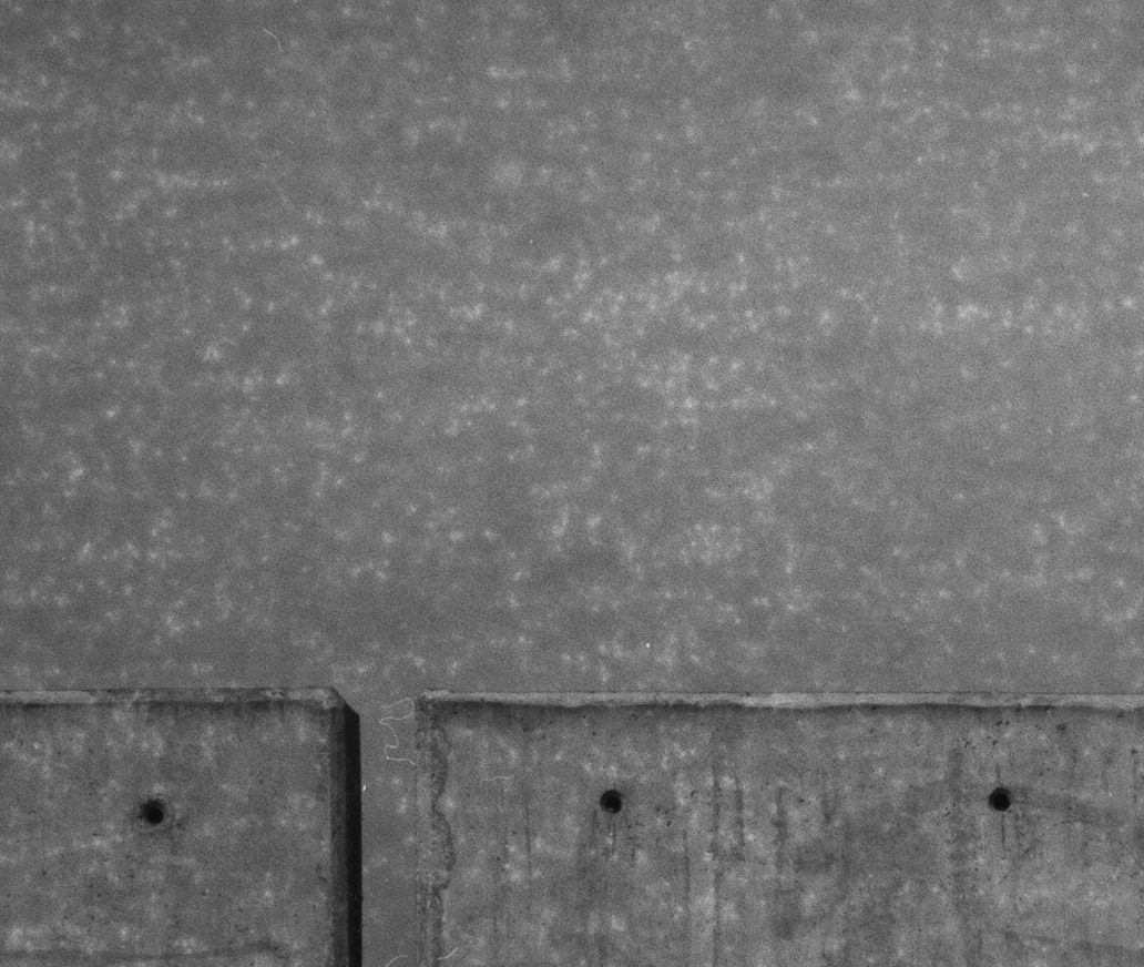

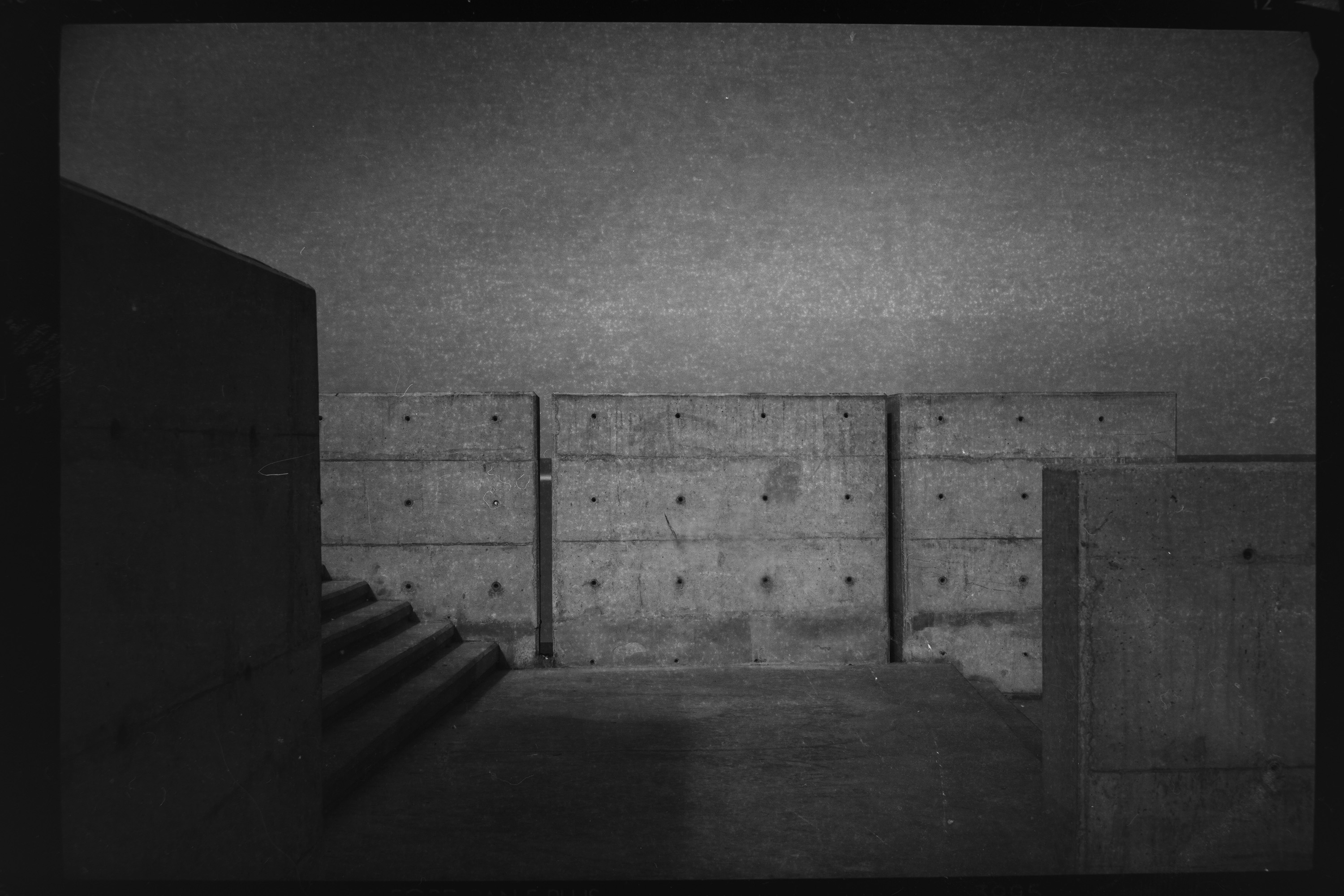

Hello friends,Strange thing happened to me that maybe someone here can help me understand.I shot an ilford panF 50 on my fuji 690 and developed in Rodinal 1+80 for one hour (stand). Something I do routinely in 35 mm. Everything went great except for two frames that got strange spots.What distinguished the two frames was that they were long exposures, one for two minutes and one for one hour (daylight plus nd filter)I attached a crop from the poor scan i made :smile:Does anyone have an idea why this happens and what can be done for not happen again?

Weird situation, because it is only on 2 frames. It does not look like bromide drag. I can not see connection between long exposures and those dots - maybe somebody else will help. Are you sure it is not a scanner issue? Can you see those dots with a loupe or something?

I can see it with a loupe and it's only on those 2 long exposure frames. the 2 minute exposure got less intense dots than the 1 hour one.

Dear Ori_s,
I am sorry you have experienced a problem with an ILFORD Photo product.
Are you talking about the white 'mottle' like marks or the three black dots ?
Whilst you cannot see much from a scan if you could scan the whole two negs that would help me.

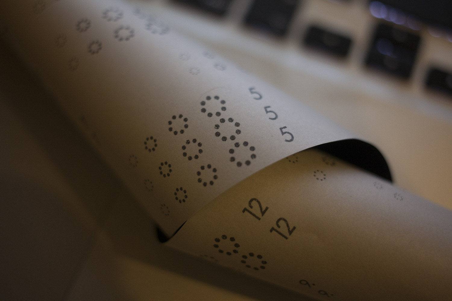

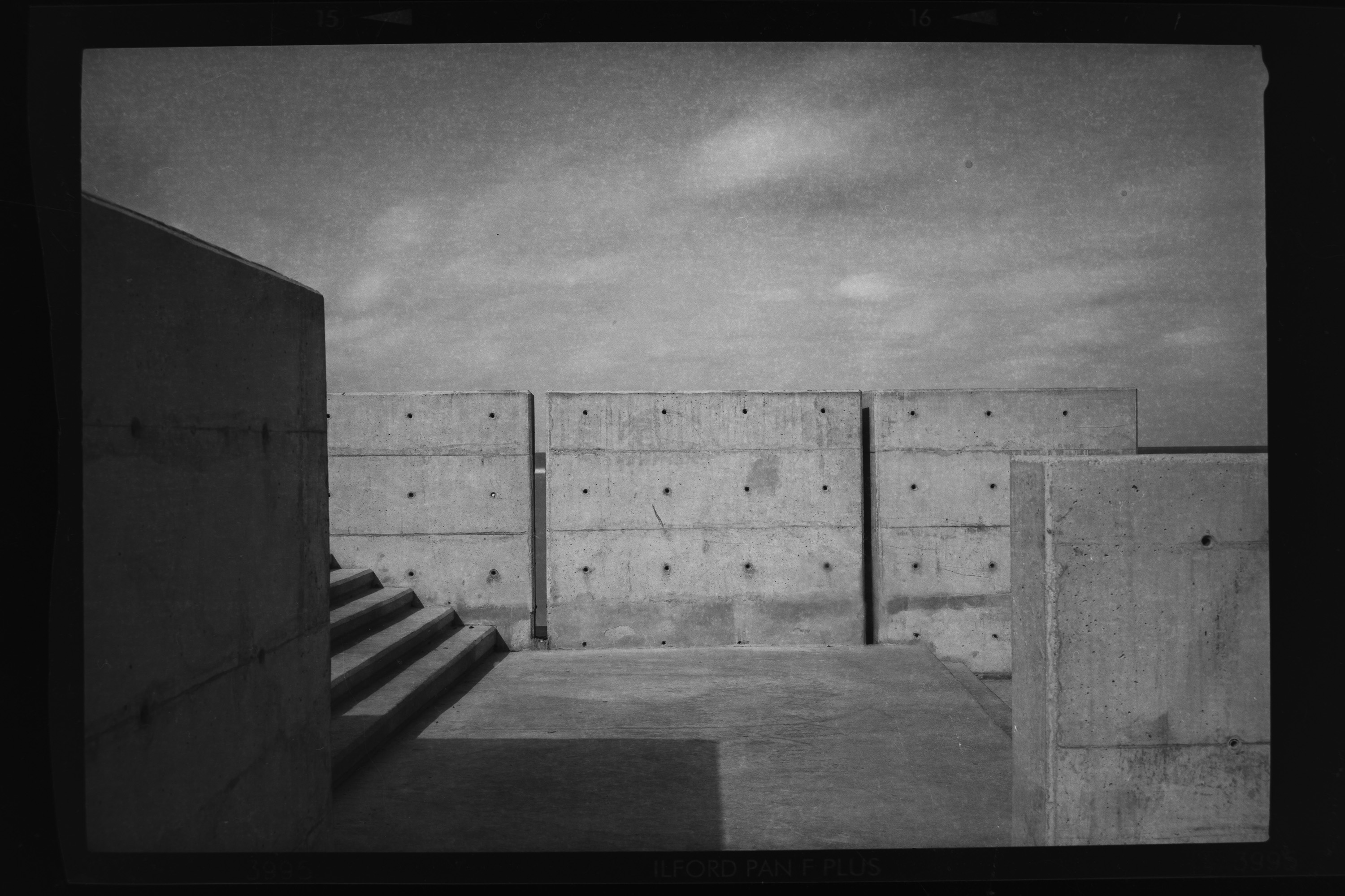

The film expired at January 2013, old but not that much. I attached the full scans that are actually photos with digital camera on a light table, my epson v600 and my mac are not friends any more but this is for another thread. I noticed that one of the frames have a sign (cirlcle of dots) that matches the paper who holds the film before develop.

I, too, have had problems in the past with the numbers on the paper showing up on the negatives. I cannot recall if the film was refrigerated or not but in the back of my mind, I think it was. A thought just came to mind... could the ink from the printing transfer to the emulsion? Perhaps the packaging is not moisture-proof and over a long time, humidity inside the wrapping caused the ink to transfer.

Dear Buje,
This is not 'wrapper offset' :

Dear Ori-S,
Thanks for posting the images, we will need to see the actual film to ascertain what it is, technically it has 'expired' and its warranty void but it should still perform fine.
I have indeed taken a walk to see Tech Service, the very long length of one of the exposures should have absolutely nothing to do with what you are seeing ( re Michael W correctly noted it could be a 'link') I was unsure as to whether it could have an effect, tech service say no, highly, highly unlikely. NB : Tech service did say if you have a defective shutter, or damaged back plate, extended or long exposures 'could' create an issue on the film that would not be obvious with normal exposures
( obviously fogging but also light 'shading' or 'scattering' ) they do not think this example suffers from anything like that.
Tech service point out the known fact that PAN F and its later derivitive PAN F + is our oldest film emulsion design, hence on our full TI sheet the LIS ( Latent image stability ) parameters are advised to users, they are sure its also not related to LIS.
Also, after Michael's referral and two other customer enquiries Tech Service did some tests relating to freezing on PAN F + emulsions, also some tests when not 'thawed' and we were unable to replicate whatsover the issue described.
We have seen issues based on very extended pre-soak ( we do not recommend any ILFORD Film should need or require a pre-soak, but as I have said a normal pre-soak should not affect any performance characteristics of any ILFORD film ).
Finally, please return the film to us at, HARMAN technology Limited, Ilford Way, Mobberley, Knutsford, CHESHIRE. WA16 7JL : For the attention of Technical Service. Please remember your contact details especially your e.mail.
We will then inspect the film and get back to you.
Simon ILFORD Photo / HARMAN technology Limited :
If possible, the box and the backing paper, with details of where and when purchased, how it was stored ( ie frozen or not, if frozen how long thawing before exposure ) how long between exposing and processing. Also if you require the negatives returned to you.
