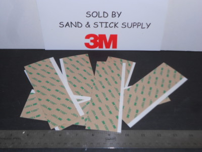

Question- if you use rubberized clothe to make a hinge... uh... how do you plan to make it stay in place?
Two possiblities- thin 'transfer tape. Often referred to as VHB, very high bond. But you need to super thin clear stuff. And NOT application transfer tape- that is a thick low-tack material for sign making. You want something like this, which is a .002- .010" adhesive layer with no substrate- imagine rubber cement in a thin tape form, only much stronger than rubber cement will ever be. The brown is simply the backing/carrier material. The tape itself is super thin and almost clear. But has some flexibility. The following Ebay item is .010" thick which is on the thick side for the stuff, but getting the thin .002" or .005" stuff looks like you need to buy a $60 or more roll.
Not the easiest tape to deal with, but very effective with some care. With something like rubber fabric (changing bags?), easiest to apply tape to an oversized piece, then trim the fabric to size.
Oh wait, this looks like .002"- https://www.ebay.com/itm/163048462920?var=462163782040
