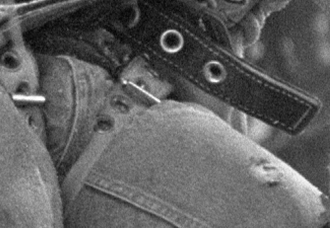

Here is an example: Fuji Neopan 400 film exposed in a Leica M3 and Jupiter-3 1.5/50mm. Developed in paracetamol rodinal diluted 1+50
...and an enlarged detail from the same picture:
