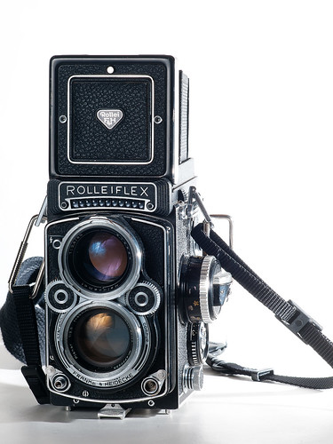

I've read numerous recommendations for the Domke Gripper Strap on a Rolleiflex TLR camera. I've got one on order and was hoping someone could show me a PICTURE of how they attached it. I've read that most simply thread the metal ring around the post. (I'm not looking for other strap recommendations, there are already plenty of posts on that subject.)
Thanks in advance!

I got the strap and things were much simpler than I thought. I will post some pictures soon. I just hadn't thought it through and, from what I've read, neither had many other people...
I have a Rolleiflex 3.5T. It has the metal strap holder that juts out from the side of the body with the little rod that goes through the middle of it. I simply used the metal split ring (think key ring) that came on the Domke Gripper. It was a puzzle I hadn't thought through properly until I had it in hand... I was thinking that there wouldn't be enough room inside the opening to get the ring around the rod in the middle... but you don't have to do it that way.
I simply ran the split ring (key ring) around the outside of the strap holder until one side was on, I then went the other direction on the other side of the strap holder and then the ring was inside the strap holder AND around the post in the middle. You could use any split ring (key ring) that is the right size and then attach it to any strap, no need for the scissor piece or any modification.

Well the thing about the proper alligator clip is that it won't damage the hood of the camera. The way it is hinged the metal part is held away from the sides of the WLF. Using the key ring thing will quickly scratch the paint of the side... depending I suppose on the size of the rings.

Yes, the camera I posted is mine. :D

As Dennis said, it all depends on the size of the ring. The size of the rings that came with the Domke are just about perfect, they fit with just a touch of movement but not much so the ring cannot touch anything except the inside of the strap faster. No danger of scratching the hood or anything else (at least on my 3.5T).
I'll measure the ring and post that with a picture, hopefully tomorrow.
