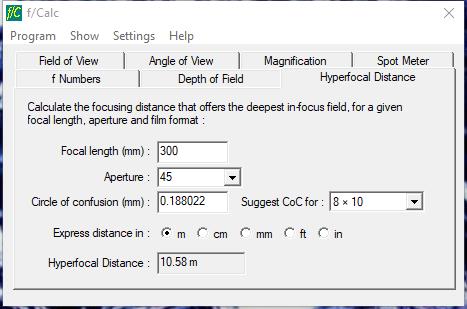

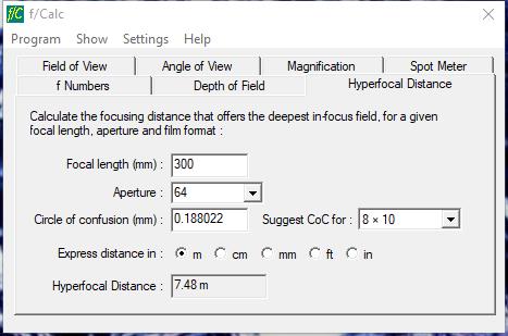

Does anyone know where I can find DoF tables that cover stops above f32? I found the excellent www.dofmaster.com site but the tables on there only go up to f32. Specifically, I would like to know the hyperfocal distance at f45, f64 and f90 for a Fujinon W 300mm on 8x10. If no tables exist is there an on-line calculator that is simple to use? If all else fails I will have to brush up my maths and work the formula...ugg!

https://fcalc.net/ has f45 and f64 but only goes up to 4x5. I have an older version for Windows that shows 8x10 and 11x14.
I can try to email the older version to you if you want.

Many thanks for all the responses on this one. I have the info I need now.
