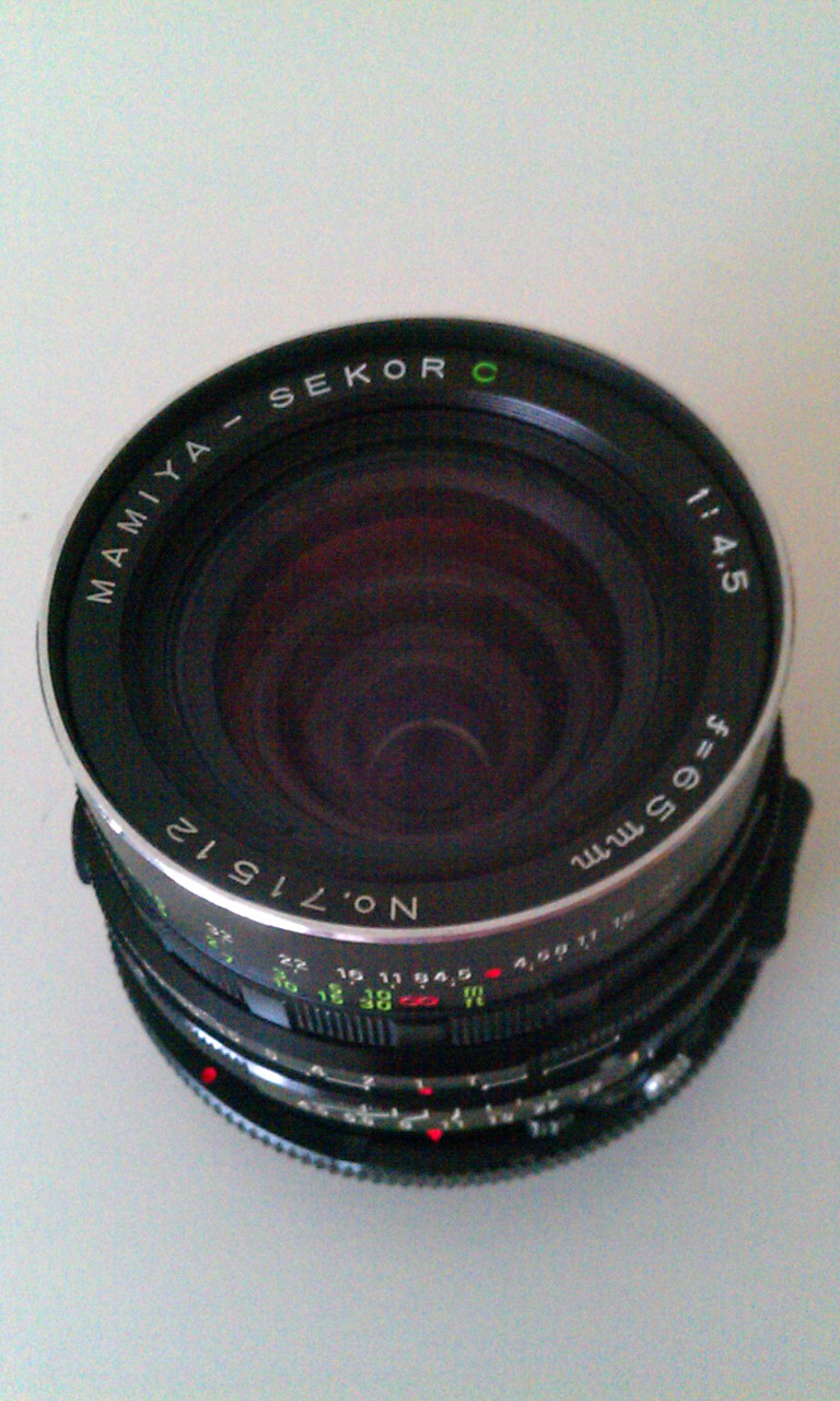

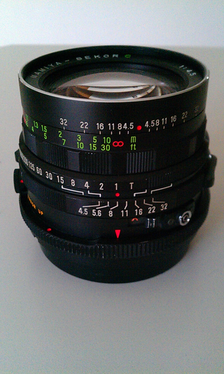

Ten days ago I bought an RB67 65mm f/4.5 C lens and foolishly just discovered its DOF ring is misaligned to the right. It's an annoyance, but shouldn't affect anything optically.
Basically there are three red alignment marks on this lens: the triangular mounting mark, the aperture/shutter selection dot, and the focus dot (this lens has a floating-element focus ring). All three red marks are supposed to be in a straight line when the mounted lens is viewed from above.
Looking straight down at the floating-element focus ring - at the extremes of its travel, both the infinity mark and the 3.3m line will align with the red aperture/shutter dot. That indicates the ring is not misaligned - however, the distances on that ring are supposed to be aligned with the much closer red dot in the DOF ring so that you can set the focus and read DOF. That's where my problem is because the dot and all the markings on the DOF ring is shifted to the right by about 1cm. It's as if the DOF ring had been removed and not put back correctly.
It's too late to return the lens or get any money back, so I'm thinking there must be an easy way for this ring to be removed and realigned, but it certainly doesn't twist off. Would the front element need to come off first?

Here are some photos of the lens and the misaligned DOF index.

But which mark will you use when you go to set it?
Until it can be fixed, I'd use the aperture/shutter red dot because I'm assuming the only issue is the DOF ring being twisted right. So, in the photo you see, I've got the floating ring set so that infinity is aligned with the aperture/shutter dot.
The lens is nearly mint - so I can't imagine how this could've happened. Either it came from Mamiya this way (highly doubtful) or someone did some disassembly. That makes me wonder what else was done.
Also, I can't see any way of removing the front name plate - I wouldn't try it myself for fear of scratching the lens. I assume it would have to come off before the DOF ring could be realigned.

I don't know whether this matters, but on my copy of this lens the name plate is rotated about 120 degrees from the location of yours.
And in my case, all three red indicators (depth of field centre, shutter speed and lens mount lock) align at the top, and that spot coincides with the limits of travel for the floating element distance scale.
It just unscrews by friction. You can try using your fingers. Pour a little bit of naptha on the filter threads if this is difficult.
Most likely the DOF ring can be adjusted after removing such front plate. Take a deep look.

Theo Sulphate
Theo Sulphate
Jul 3, 2014
6,489
Gig Harbor
Solved!
The DOF ring has been re-aligned!
A very experienced camera repairman I know fixed it in about two seconds - very embarrassing. So, there's no need to unscrew the nameplate: on this lens the DOF ring itself can be removed by simply twisting it with a bit of force. In my case, it just hadn't been twisted on fully. Earlier, I had tried twisting it but didn't do it forcefully enough since with camera equipment I tend to be gentle.
Anyway, everything now lines up and all is well.
