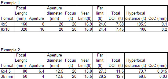

fdisilvestro
Nov 23, 2005
73
Correct, but who works in actual aperture dimensions? Aren't we all more comfortable with f/stops (aperture values)?
Yes, nobody works in aperture dimensions, but you could use an empirical method using the ratio between the focal length of the lenses and adjust the aperture value (f/stops) accordingly.
Let's say that a 160mm lens on 4x5 gives you the same AOV of a 320mm lens on 8x10, then the ratio 320/160=2. You have to multiply by 2 the aperture in the 320mm to get the same DOF as the 160.
In the case of the OP, to get the same DOF in 35mm using a 50mm lens and 6x4.5 using a 80mm lens, you need to multiply by 1.6 the aperture in the 80mm lens. Here the results are approximate since the film proportions and angle of view between the two are not the same.
In the attachment there are two examples with data obtained from the online DOF calculator http://www.dofmaster.com/dofjs.html
Jim Jones
Jan 16, 2006
3,737
Chillicothe MO
Perhaps we should for some caculations. For prints that are to be viewed in correct perspective, the negative's DOF and hyperfocal distance are a function of the entrance pupil. Multiplying the entrance pupil by a constant gives the hyperfocal distance. A constant of 2000 is sometimes cited as being appropriate for critical work.
The print viewing distance for correct perspective varies in proportion to the camera's focal length. The hyperfocal distance can be corrected for this by another simple calculation. Basic math that we may have rarely used since elementary school lets make these approximations in the field without charts or calculators.
The photo's subject can be an important factor in DOF, but is often neglected. A Weston seashell or nude is more about light and form than about texture, while a bare tree silhouetted against the sky demands sharp detail. Individuals' perceptions of sharpness vary widely. Charts and calculations are handy tools, but a thorough understanding of DOF lets the serious photographer develop a more effective personal approach.
