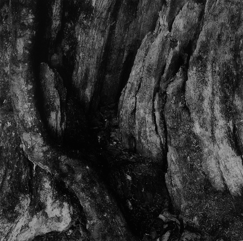

This is an example of a scene where I believe that I used incident metering, and I adjusted the exposure from what was recommended:
The light was low, of low contrast, and the subject was dark.
So I made a decision to add additional exposure, in order to have a negative with more to work with.
I wouldn't have done that if the scene had a wider Subject Luminance Range. The narrow SLR (aka SBR) allows you to move the exposure up the curve, without damaging the highlights.
This, by the way, is a scan of a print.
This is a perfect example of when you would compensate because you know you can and you know it can help.
Curious as to where the meter was positioned?
In the cleft itself, but not in the shadow of the stump, pointing back at the camera.
I used the light integrating dome, because that is the only choice on a Digiflash or Profisix F (can't remember which).
I probably took an incident reading in the fully shadowed part as well, to satisfy curiosity.

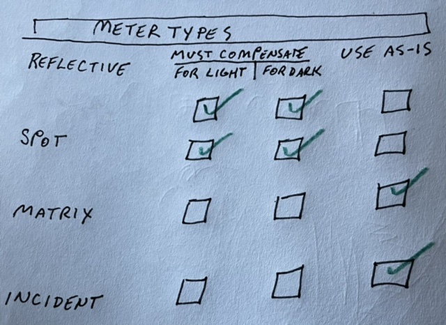

Sure, I agree with you too. But what would be the right answers on a true false quiz?
If I were going to make a list of advantages and disadvantage for different types of meters it would look like this:
