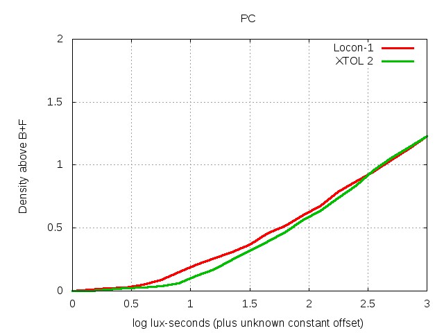

David, I suspect the carbonate is what's reducing contrast. It raises the pH, making the developer more active. But due to the high dilution, the buffering is poor, so pH drops more in the highlights than shadows, creating compensation and lower contrast. I mixed a home-brew PC developer that behaved similarly. Below are the HD curves for it and XTOL, with equal densities on the right side. The low contrast dev obviously has a higher toe, and thus higher speed, and a lower CI. Poor buffering is my theory for this.
Finally, the dev is overdeveloping the shadows and underdeveloping the highlights, so expect to see more grain in the shadows. And more fog for the same reason.
