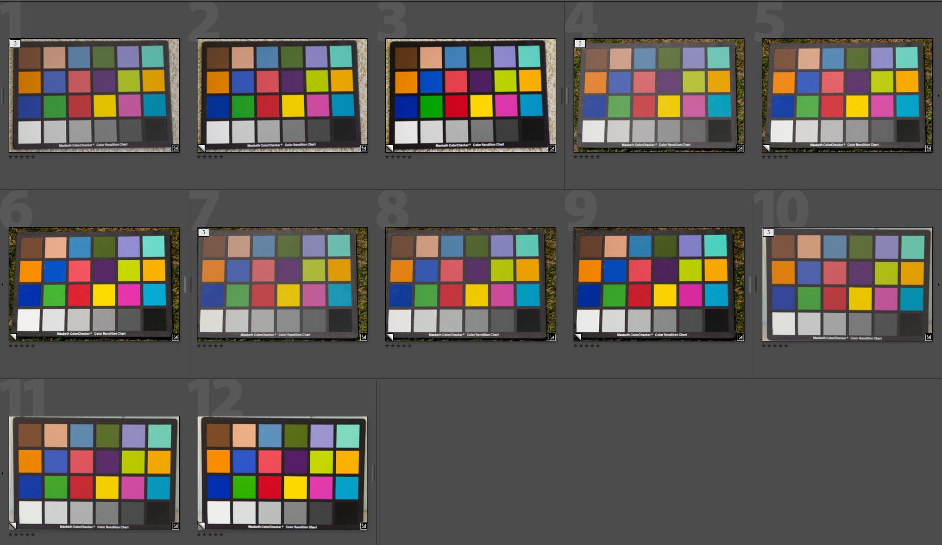

Many years ago, early in my own use of digital photography, I shot the MacBeth Color Checker under an assortment of illumination types, to see how it affected the appearance of the Color Checker. Unfortunately, I cannot find my shooting notes for this illustration, but de facto one can visualize real difference in hues being reproduced, even ignoring issues of CRI!

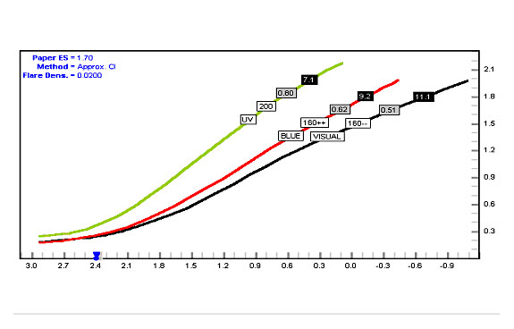

And variable contrast print papers illustrate that the color of the illuminating light itself can affect the paper's response with more or lessened contrast characteristics.
Thanks for your input! In these examples it's reflected light, though, right? I wonder whether these differences would be noticeable in the black-gray-whites if it were film with light going through them rather than reflected.

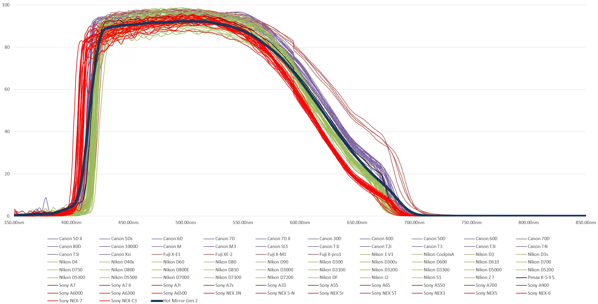

As for being a light source under which a dSLR copies are made, it should not matter because the dSLR sensor is designed to be virtually uniform across the visible spectrum; if your camera was set to B&W JPEG capture, especially! I might understand some variation if you were using one of the profiles from the factory, which did some de-emphasis, like a more pastel capture JPEG, that is intended to reduce contrast with de-emphasis of the more saturated tones.

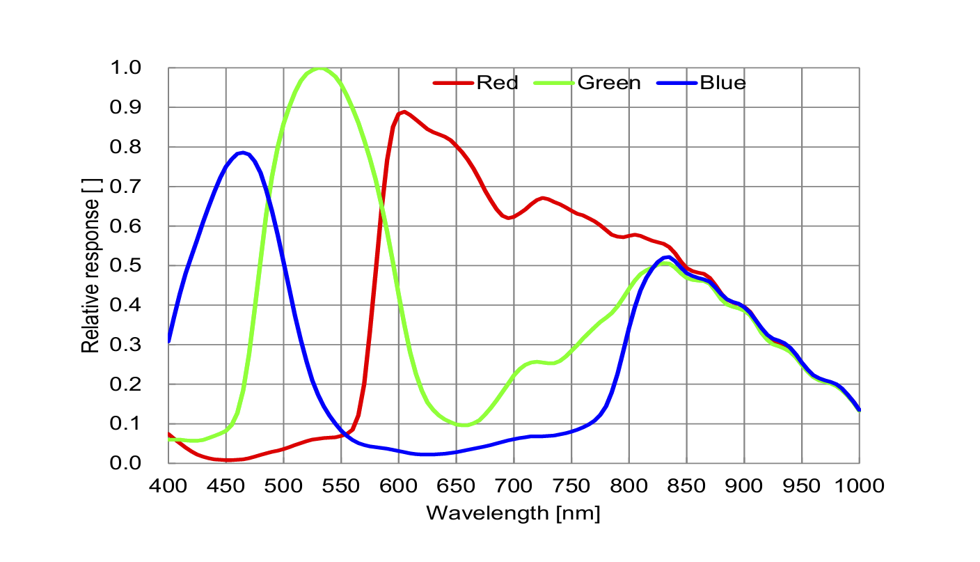

Here is a typical spectral sensitivity of Sony CMOS without UV-IR cut filter and there is a set of UV-IR filter's transmission curves from Kolari Vision. Maybe they will help you understand crosstalk of a CMOS.
@MsLing thanks for posting those; the first chart is the kind of chart I had in mind when I mentioned the crosstalk issue earlier. There are more/similar charts here for a number of (mostly rather old) cameras: https://maxmax.com/spectral_response.htm
The second plot I think comes with some caveats. It seems to represent the combined response across all three RGB channels with a particular Kolari filter fitted on the lens. This filter likely has a non-linear response to compensate for certain peaks & valleys that result from crosstalk also/in particular in the case of a modified (IR filter removed) camera. So I'm not sure how representative it is in the context of this thread.
As to the former plot, note that much of what happens beyond ca. 700nm or 750nm will likely not be all that relevant for camera scanning since most LED systems don't have much emission in that part of the spectrum. This means that the more problematic part of the RGB crossover (where the curves start to align again in this particular example) is something that won't affect real-world outcomes much. Moreover, in an unmodified camera, this part of the spectrum will be lopped off by the IR filter anyway.
Note finally that the kind of curves shown here can only be constructed on the basis of measurements to which in-camera processing is already applied to normalize the signals. We cannot really know what kind of math (potentially fairly complex, even) is applied to the raw sensor data as this is manufacturer-proprietary information and occurs inside the black box of the onboard image processor. I suppose that if a datasheet of the actual sensor is available (which is probably most often not the case for consumer/prosumer cameras), it might be possible to at least crudely reverse engineer this black-box behavior to a limited extent.
