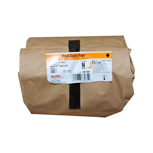

A shop that's local to me sells this, and it seems to me that it's cheaper than buying sheets (especially since I would have to order them from another country).
I'm thinking about making a jig from wood (or 3d printing one) to help me cut the paper in the dark. I was hoping a masking frame would keep the paper flat enough for printing (I assume the paper will be curled from the roll)

Note that Kodak ceased making paper several years ago. Today in Europe you'd buy Fuji. The equivalent to the Royal paper in your picture would be plain-Jane Crystal Archive: https://www.originalphotopaper.com/products/ca/ I recommend using DPII as it's readily available in many roll lengths and an excellent product overall (much better than plain Crystal Archive!)
Thanks. I didn't know Kodak doesn't make the rolls anymore. I saw this listed on a local web shop, and it said that they have it in stock. I guess it's an error.

It's either an error or the paper is several years old. Either way, I would not order it. If only because Kodak Royal was OK when fresh, but really nothing special.
Ok so the manufacturing date says it was made in 2019. Do you think I should return it, or should I give it a try. It was less than 40€ for the whole roll, I don't think I can get anything as cheap as that.
I personally wouldn't waste my time on it, but I can imagine you'd want to use it to learn the basics of color printing. Then when you've figured out how to go through the motions, purchase some actually good paper.
With this paper you can expect that the whites will never become truly white; i.e. they may be distinctly yellow or cyan.
You're probably right. I won't feel bad wasting this. I'll get some proper paper later down the road.

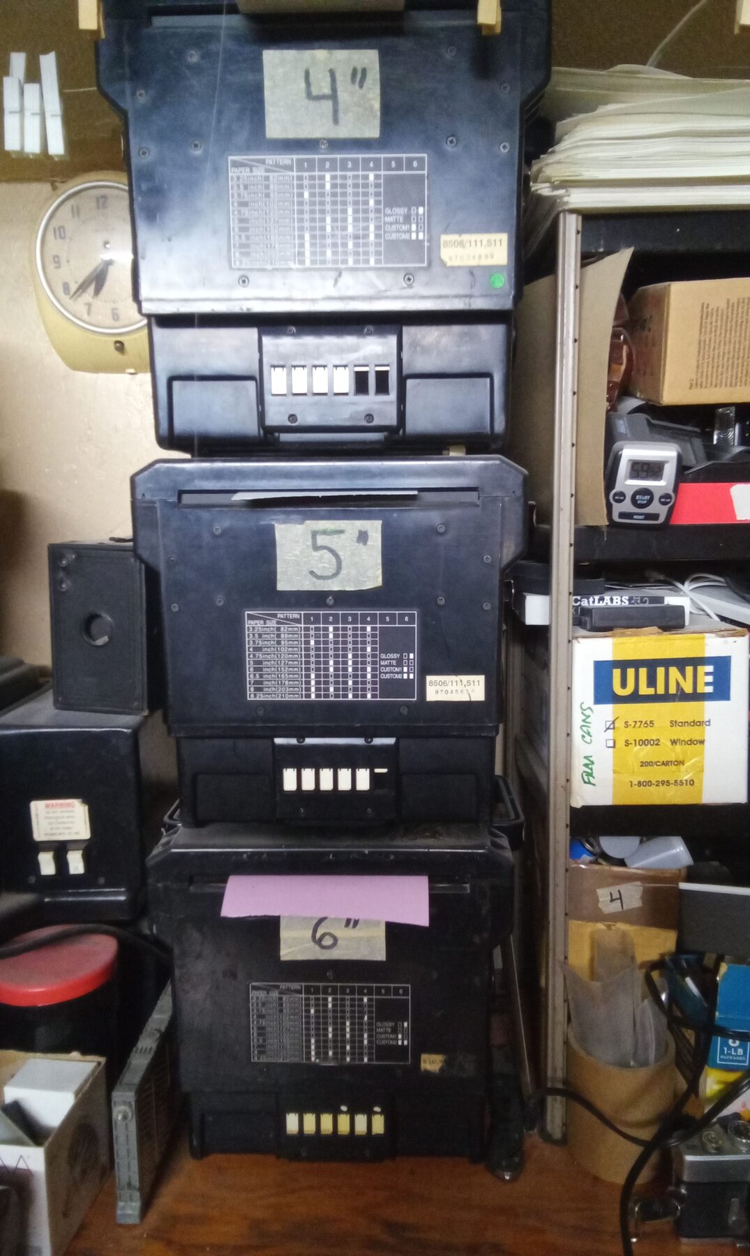

I use my extra d-lab cassetts in the darkroom, just pull off a strip and cut with utility knife. SpeedEzels work great for holding the paper flat. I've got about 20 more.
