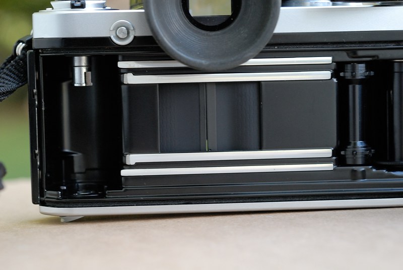

I don't know that the F2 has light seals, per se but rather, dust seals. The one problem for having light leaks will come from a bad shutter. Case in point is the F2A I have that had to be sent to Sover. The curtains were apart as shown and not suppose to look that way. My first roll of film though it yielded half of the frames light struck in the same spot and this was the reason.
You can see the curtain on the right is somewhat bunched up.
_DEF5144a by David Fincher, on Flickr

The mirror seals are for light, I think. They're also usually gone. My "quick test" involves pushing down the mirror seal with a q-tip - if it does not return instantly or sticks even a little bit, I change all mirror and rear cover seals.
Suggest David is correct the door and body have triple baffles and don't need foam the mirror box needs foam to stop light leaks rather than as a buffer.
People fit foam to door interface for dust sealing.
I remove it.
The early Canons like the VI and P don't need foam.
The F2s are not abnormal.
