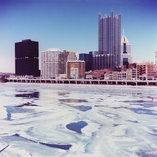

I do. It's hard to give you any straight fast rules or advice. It's a non-standard process and different films respond in drastically different ways. Also, processing and printing is very much a "to taste" exercise since you've already abandoned color fidelity. Some folks work hard for those green and orange casts which seem representative of the phrase. Others (like me) try to balance to grayscale and let the resulting colors render themselves naturally. Even then, I find my filtrations to be all over the place. That said, I do keep extensive notes and I'm happy to share the filtration values of any of the images mentioned above. Or if you want to see others...

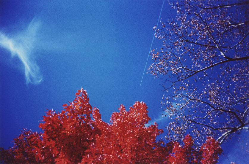

I will do it before long, with aerochrome. I have some blank shhets of regular c41 to add the orange mask.

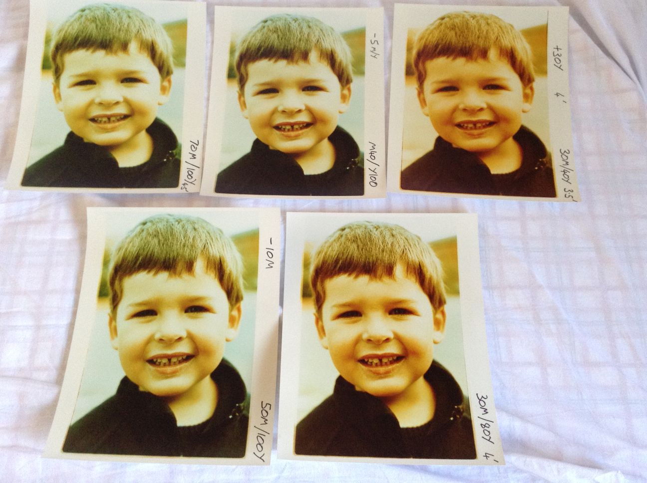

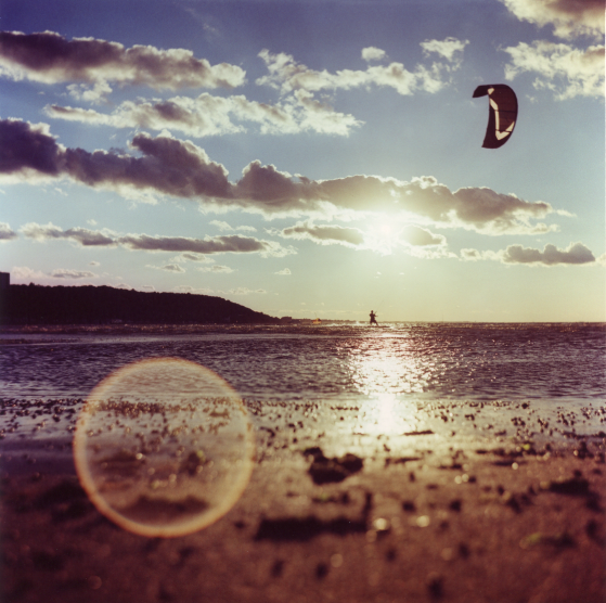

Expired Provia 100F. 20C+100Y
Expired Ektachrome 100 Plus. 40M+40Y
Expired Provia 100F. 25M+95Y
Expired Provia 100F. 10C+110Y

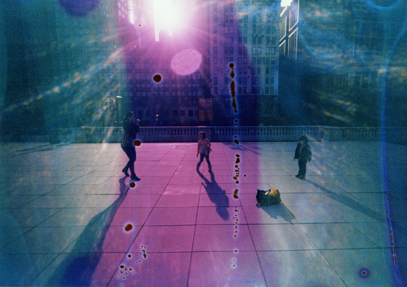

That is how it scanned! I really have no idea what it was, except for weird! I did find some other examples online from the person selling it and they looked exactly the same! I have to admit, I hated it to start off with, but grew to love and nearly crave it. I did try and contact the seller a few months ago to see if they had any left, but I never got a response.
When I get a chance (I am currently at work), I'll find some more examples and what the film exactly was.

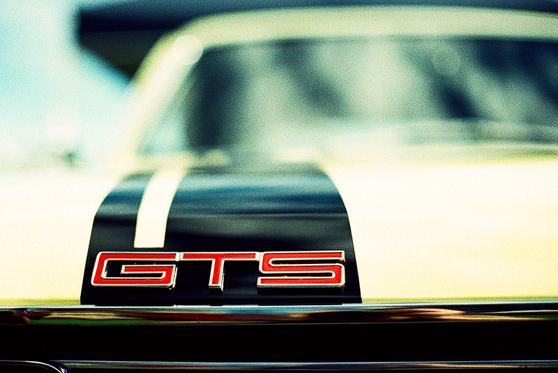

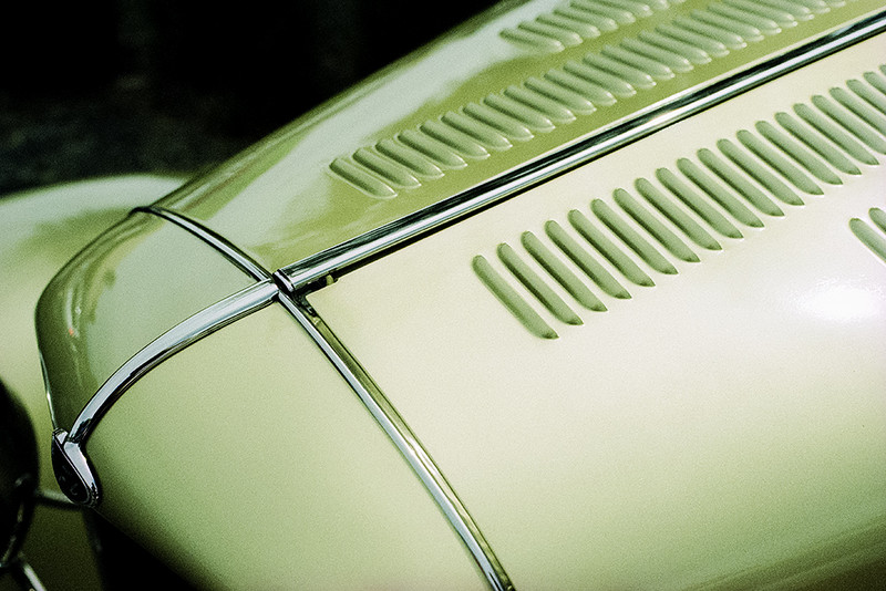

As for more traditional xpro, this is the stuff I have been doing. I'd love this to translate to optical prints if I can (but am not fussed if it doesn't look exactly the same):
Shot on Sensia 200
Vented by Ashley Hoff, on Flickr
Shot on Ektachrome 64T
60s GTS by Ashley Hoff, on Flickr

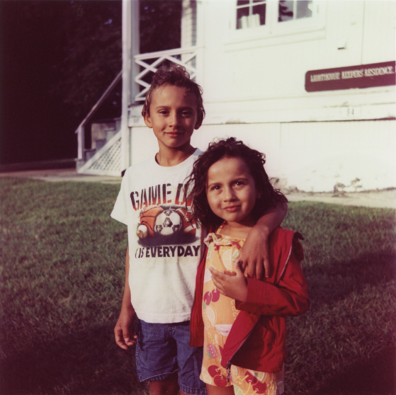

I had something similar happen -- also (interestingly) with film bought second hand. Don't know what happened here either but I kind of like it. Ektachrome 100 Plus in C-41. RA-4 print.
